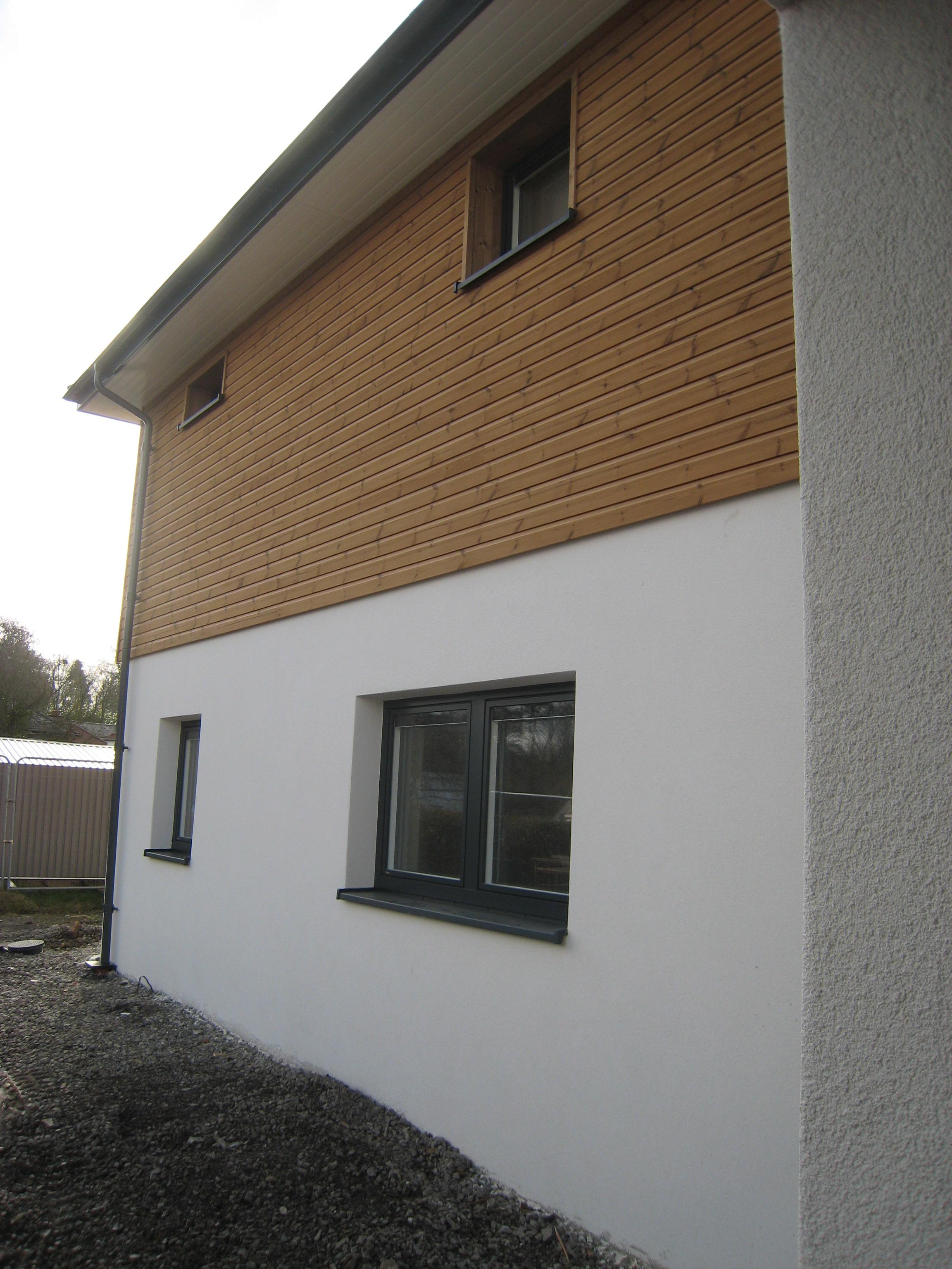

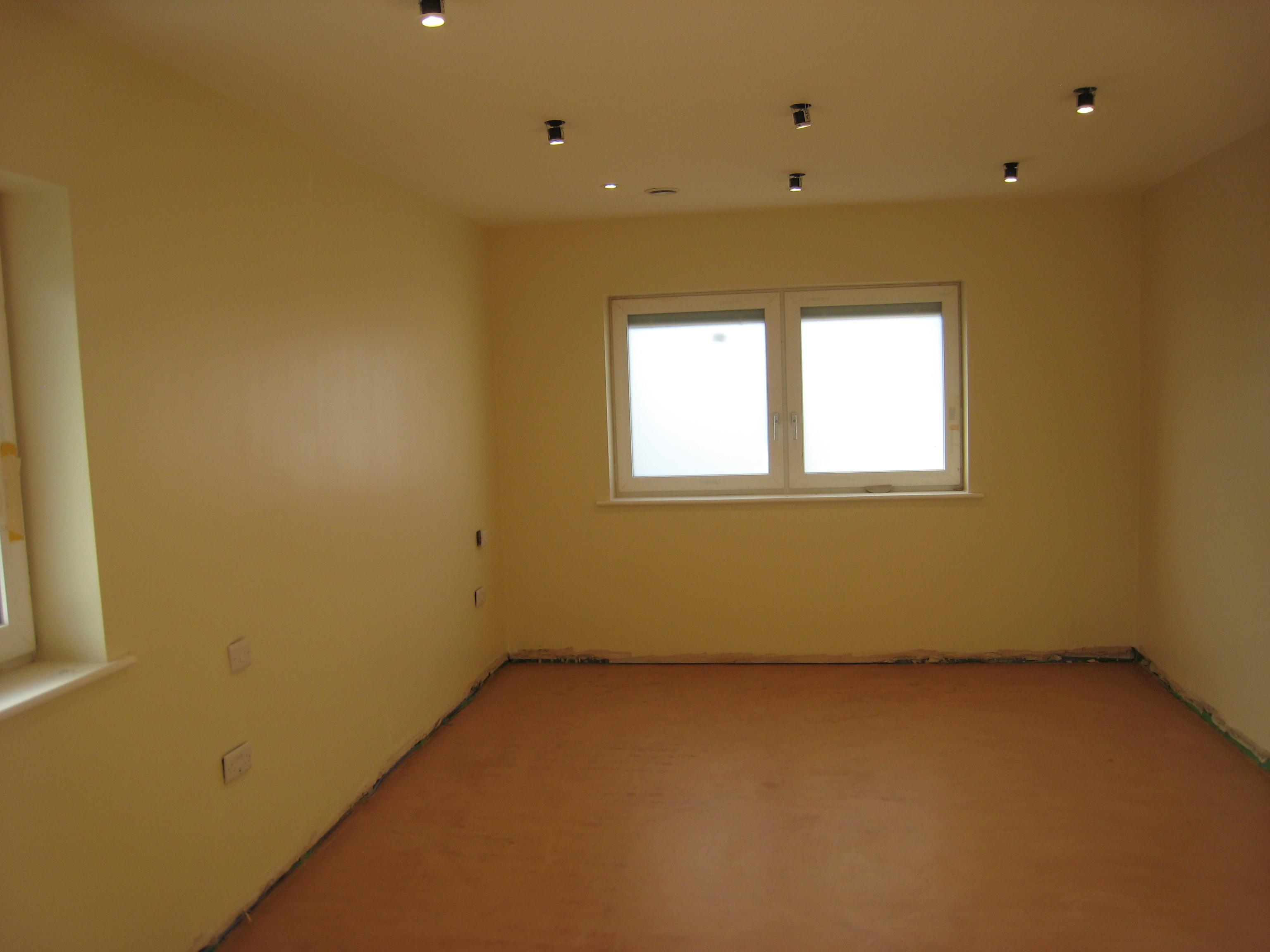

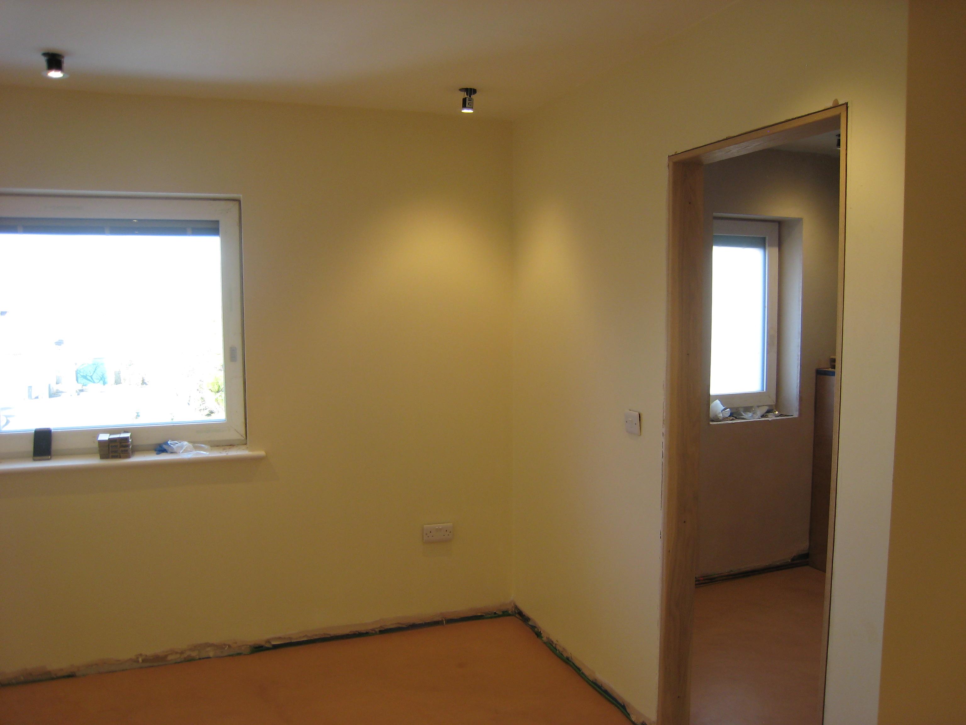

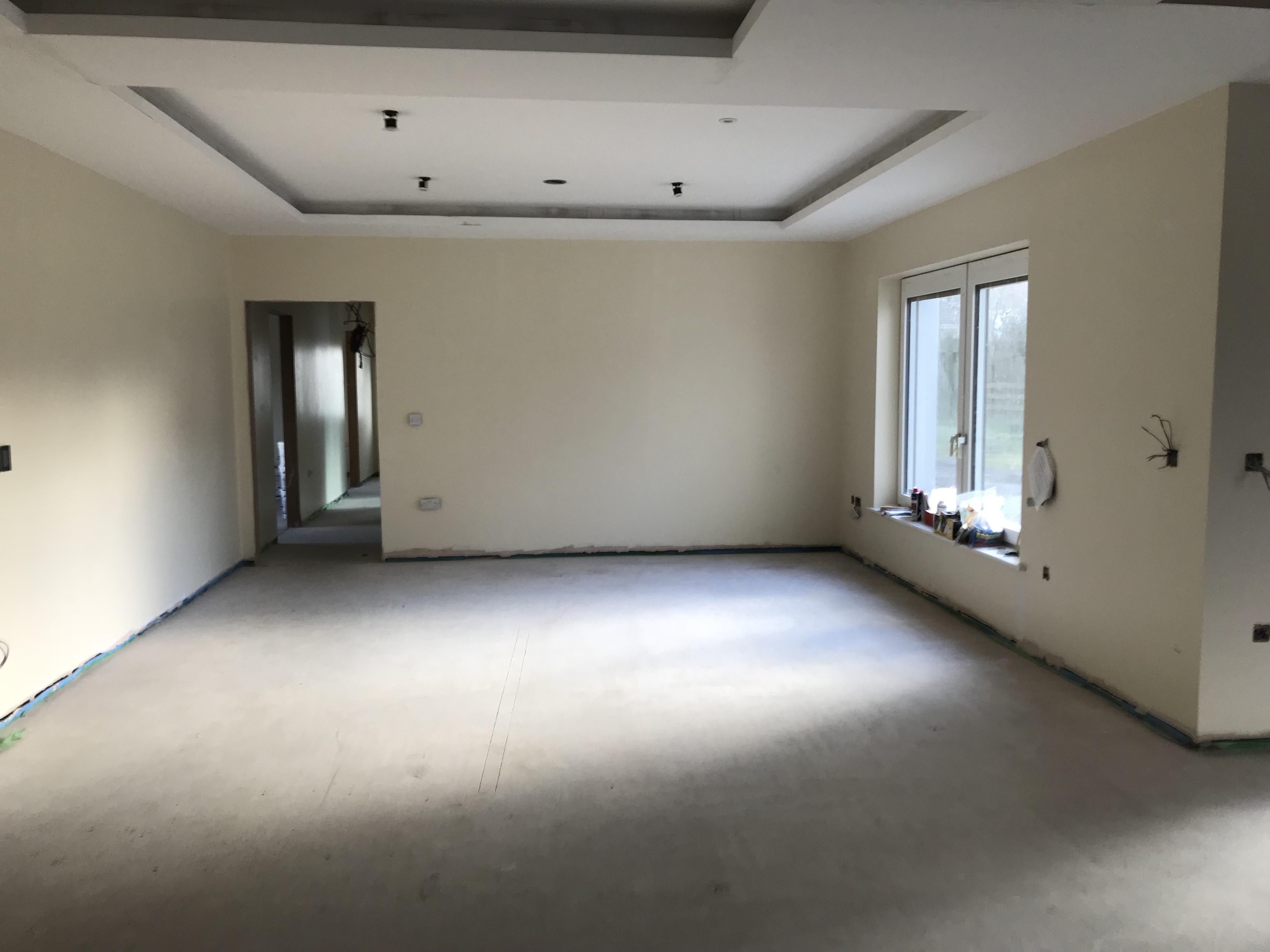

le-cerveau Posted December 8, 2018 Share Posted December 8, 2018 Some pictures from during the build. Dining room 2400mm wide, 1800mm high Obscured bedroom window (overlooking, 2000mm x 1200mm) External, the top left is the KF410 Bedroom and en-suite. 1 Link to comment Share on other sites More sharing options...
canalsiderenovation Posted December 8, 2018 Author Share Posted December 8, 2018 Thanks @le-cerveau they look really smart. Your wood cladding looks really good too. Another question, is that k-rend? If so what colour? Link to comment Share on other sites More sharing options...
