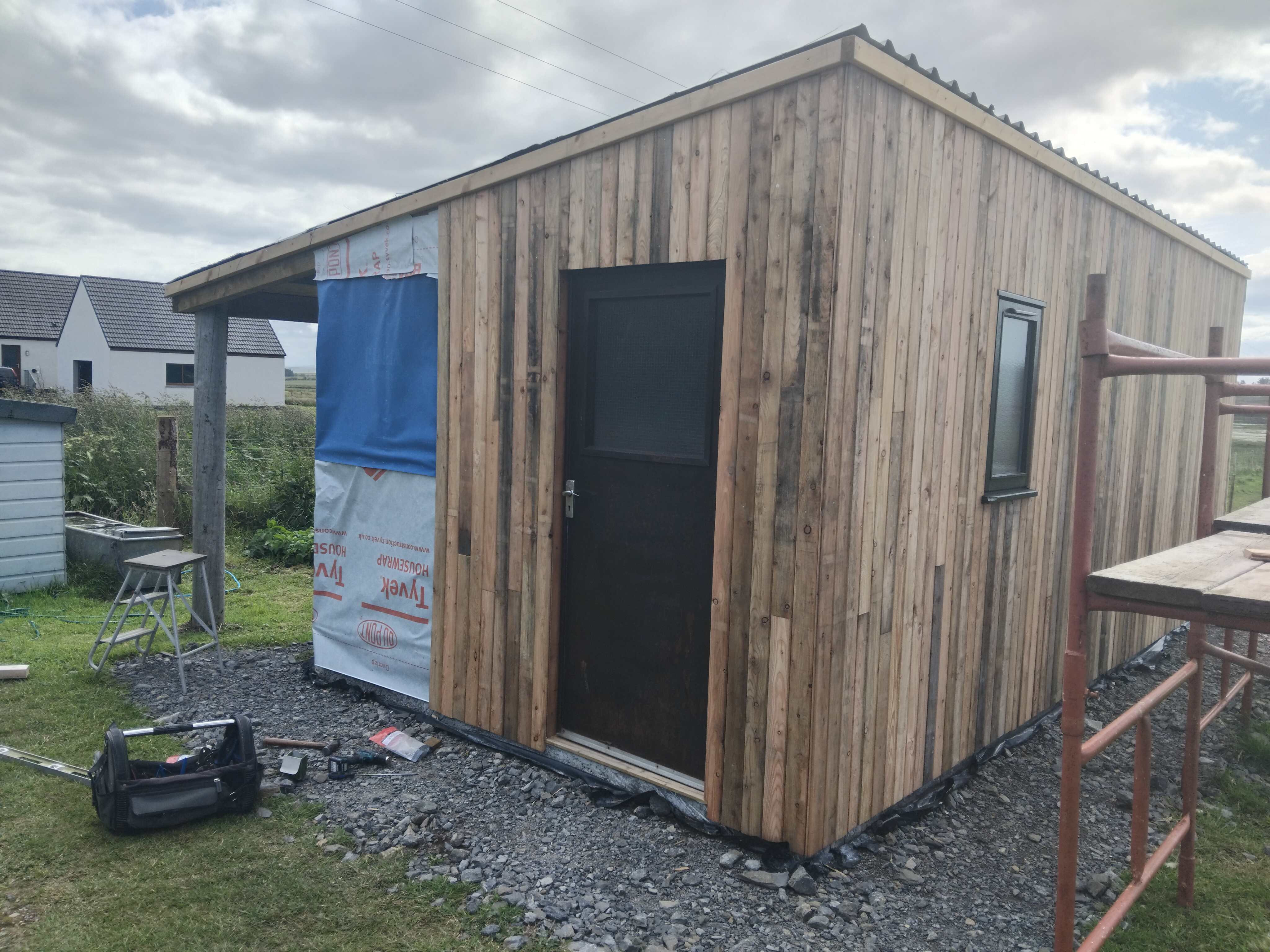

AndrewR Posted June 23 Posted June 23 (edited) This post was interesting, but can someone advise on waterproofing please? I don't care about the aesthetics of colour change from brown to silver. I live on the far north coast of Scotland - often high winds, lashing rain, and salty misty air. I have used Scottish larch cladding a lot (I bought a job lot) for various applications, the most recent being a shed that I built (photo attached: during construction). The larch on the shed is currently untreated. What I am finding is that when it rains, water tracks down to the base of the planks and the cladding remains saturated at the bottom six inches for a long time. I also found this on other places where I used the larch. This in itself I want to remedy, but it also then tends to blacken at the base due to the water and, I assume, fungus. In short, I am looking for a larch cladding waterproofing treatment. Which products can anyone recommend? On other applications I have tried raw linseed oil, and it is okay for a month or so, but when the wet season starts if seems as it I hadn't used anything. I thought about yacht varnish, but I'm finding mixed information, i.e. it is good, it can lead to trapped moisture, it is not good for softwood, products now are not as good as they used to be Thanks, Andrew Edited June 23 by AndrewR
JohnMo Posted June 23 Posted June 23 9 minutes ago, AndrewR said: larch cladding waterproofing treatment https://www.ryeoil.co.uk/shop/decking-oil/ It is actually ceder oil, I use on the house larch cladding. Or paint it with Jotun Demidekk, I used on our shed (larch) been on a couple of years still looks the same as the day it went on. 10 minutes ago, AndrewR said: yacht varnish The oils in larch will push it off. Once tried with ceder it all peeled off.

Crofter Posted August 15 Author Posted August 15 On 23/06/2025 at 03:00, AndrewR said: This post was interesting, but can someone advise on waterproofing please? I don't care about the aesthetics of colour change from brown to silver. I live on the far north coast of Scotland - often high winds, lashing rain, and salty misty air. I have used Scottish larch cladding a lot (I bought a job lot) for various applications, the most recent being a shed that I built (photo attached: during construction). The larch on the shed is currently untreated. What I am finding is that when it rains, water tracks down to the base of the planks and the cladding remains saturated at the bottom six inches for a long time. I also found this on other places where I used the larch. This in itself I want to remedy, but it also then tends to blacken at the base due to the water and, I assume, fungus. In short, I am looking for a larch cladding waterproofing treatment. Which products can anyone recommend? On other applications I have tried raw linseed oil, and it is okay for a month or so, but when the wet season starts if seems as it I hadn't used anything. I thought about yacht varnish, but I'm finding mixed information, i.e. it is good, it can lead to trapped moisture, it is not good for softwood, products now are not as good as they used to be Thanks, Andrew I'm a bit late finding this but I'll reply anyway. Your description of the boards blackening at the bottom is a bit strange. It's not something I've experienced myself. Are you saying that the water isn't dripping off the bottom of the boards? On my build I used a relatively cheap Barretine product, I can't remember exactly what it was, some sort of oil that I brushed on. It was possibly for decking. It seems to have worked, and I don't have any blackening or water retention. I'm on Skye, so not exactly a dry climate. I do also have a much bigger drop below the boards than you do. From memory, best practise is to have 6" between the bottom of the boards and the ground, to avoid splashback. I wouldn't use yacht varnish for a number of reasons. It's very expensive, and you'll be lucky to get 2yrs out of it before the UV makes it peel. It's designed to provide a protective coating on top of the wood, so works best on a smooth surface, not rough sawn boards. And it will trap moisture behind it, leading to blackening. An oil doesn't suffer from any of these problems.
JohnMo Posted August 15 Posted August 15 52 minutes ago, Crofter said: wouldn't use yacht varnish for a number of reasons. It's very expensive, and you'll be lucky to get 2yrs out of it before the UV makes it peel. Had a gate made either ceder or larch. Anyway did yacht varnish. 18 months later lots had peeled off and plenty had gone black. Two days later had it scrapped off and used ceder oil, applied every two years after that and looked as good as new. 1
