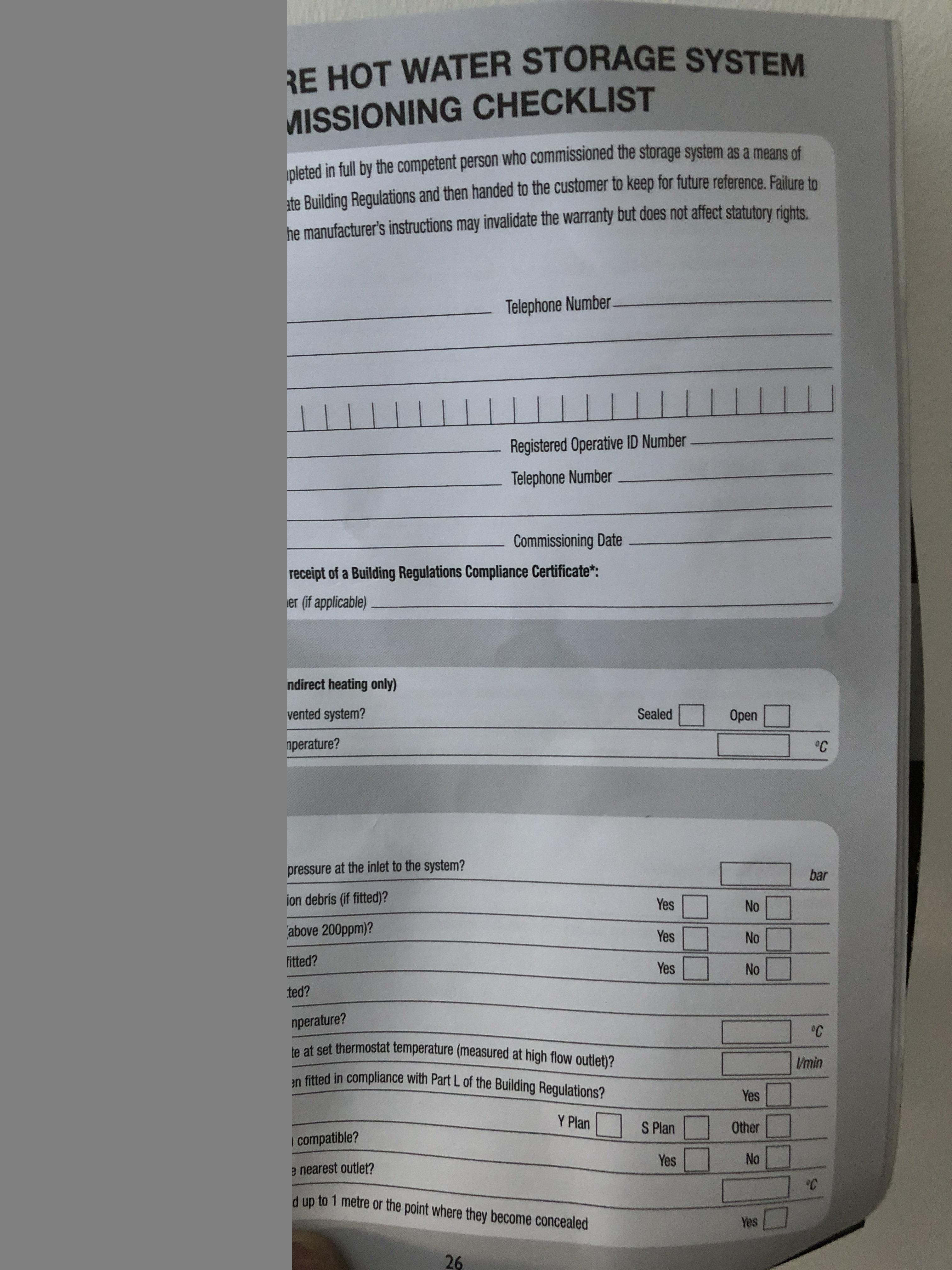

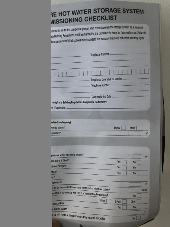

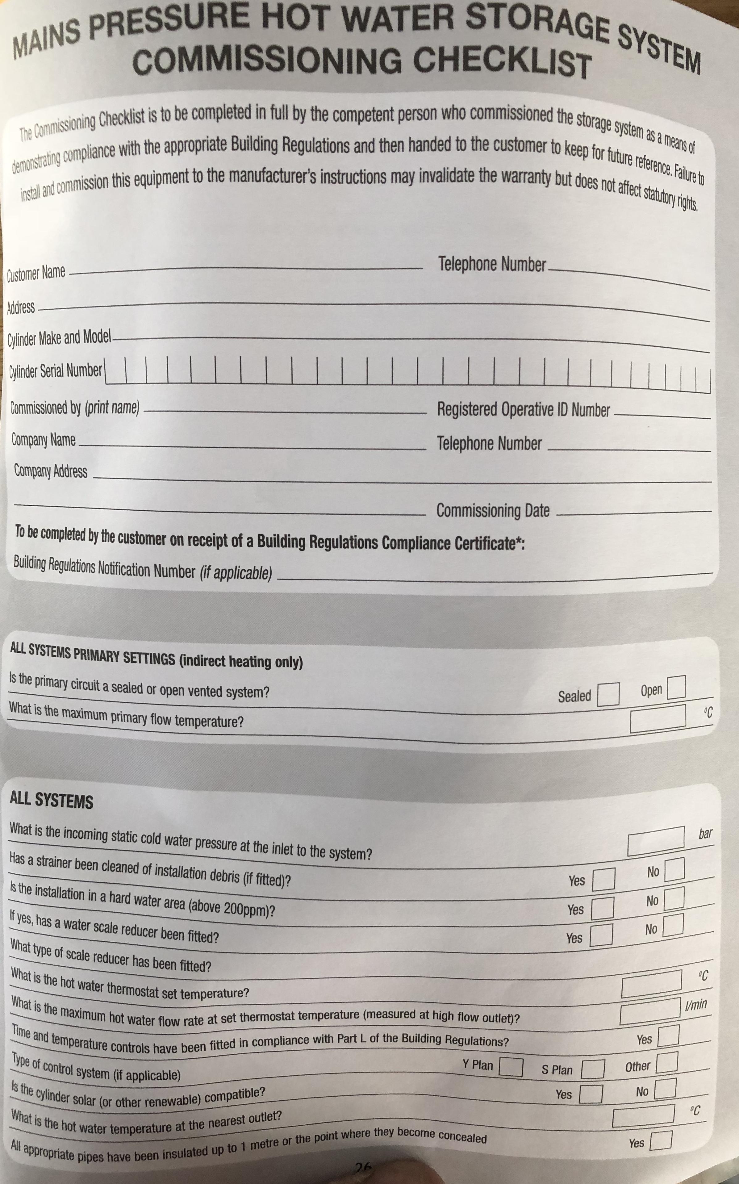

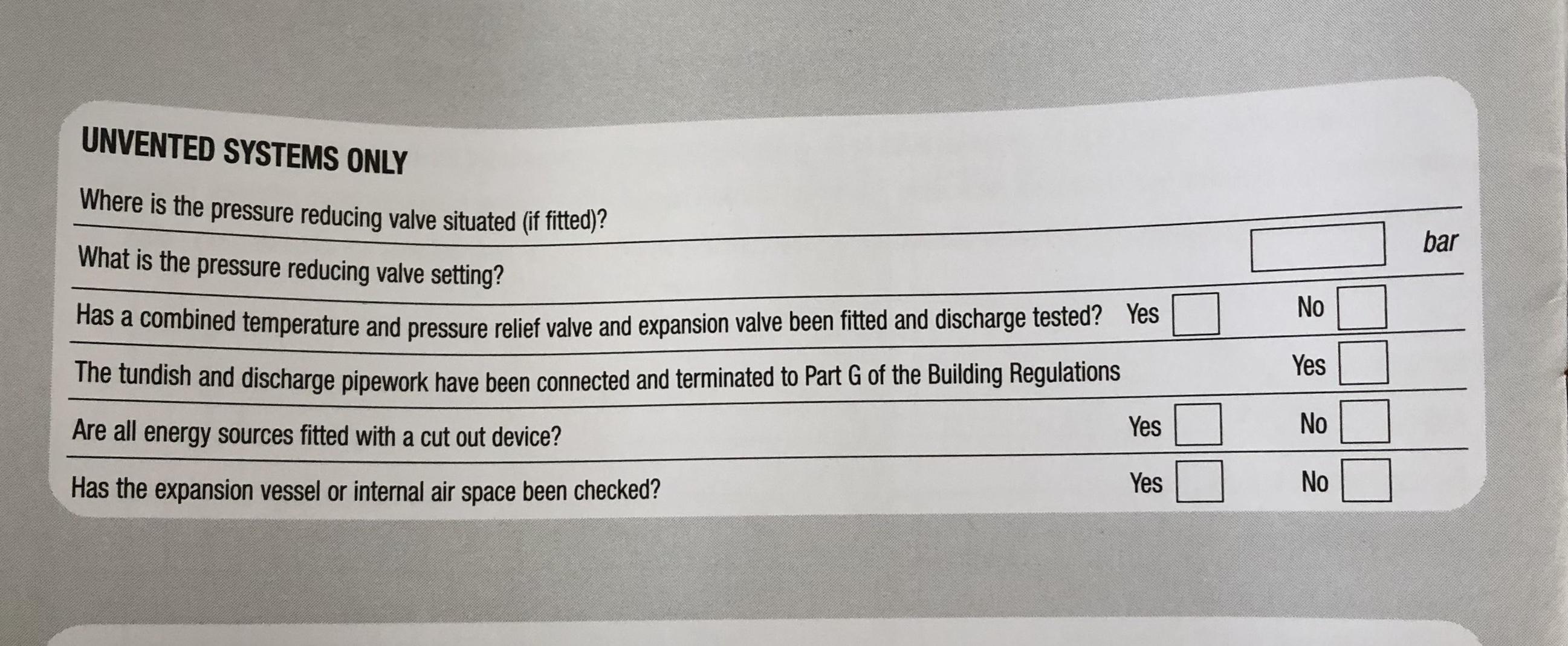

PeterW Posted November 13, 2018 Share Posted November 13, 2018 Tank should have one of these ... if you go to the next page under unvented you will see this. Note item 4..... If this has been done to building regs then they have to fill this in, and it has to be provided to you ... 1 Link to comment Share on other sites More sharing options...
PeterW Posted November 13, 2018 Share Posted November 13, 2018 3 minutes ago, pocster said: no tundish because in cupboard and no one will see it Breach of G3 Regs.... Link to comment Share on other sites More sharing options...
ProDave Posted November 13, 2018 Share Posted November 13, 2018 Makes me laugh that it is frowned upon for someone like me to read the rules and apply them to the letter when installing my own tank, yet someone who claims to have the right ticket just ignores the rules. You see that in all trades. 3 Link to comment Share on other sites More sharing options...
Nickfromwales Posted November 13, 2018 Share Posted November 13, 2018 21 minutes ago, PeterW said: Breach of G3 Regs.... 100%. Tell piss face builder to get ‘qualified ring-piece’ back to do the job properly. The installation manual will be handy to have to hand to demonstrate that the tundish MUST reside with the UVC, and his ‘interpretation’ of how it can be done, to make his life easier, is actually a breach of G3. The rules are there to be read and followed, not ducked and dived around. Jeez. Also, and this is VERY important, ask him if EVERY SINGLE mixer outlet ( showers / bath fillers / mono-block taps etc ) EVERY SINGLE ONE WITHOUT DOUBT have the cold water coming from the balanced output of the control group ( the multi function valve alongside the UVC ). If he shrugs his shoulders or cannot answer the question then the UVC is on borrowed time. Ask and update please. 1 Link to comment Share on other sites More sharing options...
