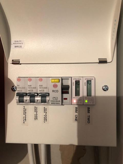

Barney12 Posted November 10, 2018 Author Posted November 10, 2018 OK, so today I've upgraded my electrics to cope with two 16amp immersions and also added the electric monitors I wanted for each of the Sunamps. In the end I went with these (Amazon Prime eligible so easy to return if crap!): https://www.amazon.co.uk/gp/product/B013E007VO/ref=oh_aui_detailpage_o02_s00?ie=UTF8&psc=1 They seem to be doing an admirable job. Oh and of course the requisite picture...... (Note: I really didn't need RCD protection but it was the only CU that they had in stokc which would fit in the space :))

Onoff Posted November 11, 2018 Posted November 11, 2018 15 hours ago, Barney12 said: I'd have put the labels up the other way to match the kWh...
