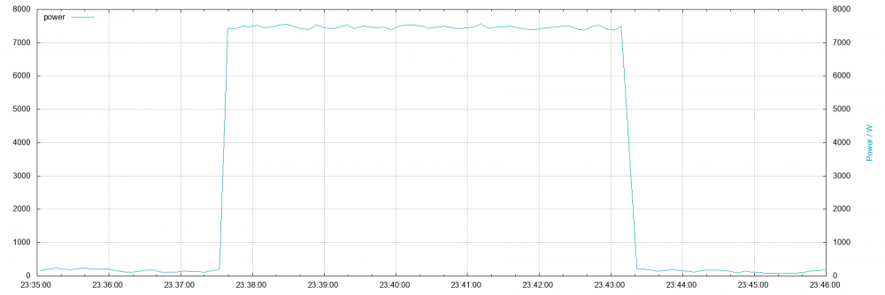

Graph of my household power consumption during my shower last night. There was other consumption during the time, of course, but pretty negligible. It's a 7 kW electric, heating directly from the mains cold water.  Integrating from 23:37 to 23:44 gives a total of 2556052 watt·seconds (joules) which converts to 0.71 kWh.

A 7 kW electric shower, with an incoming cold water temperature of 8 deg C, and a shower temperature of 38 deg C, will only give a flow rate of 3.35 litres per minute, so your guess of your shower having a 3 times greater flow rate, @ProDave, is pretty much spot on, I think!
Electric shower flow rates really are pretty poor, IMHO, although having said that we managed with a 10 kW one for a few years (that would give a flow rate of around 4.785 litres per minute).  The problem is that once you've experienced a shower that flows at around 10 litres per minute or more it's hard to switch back to one with 1/3rd of the flow rate.
