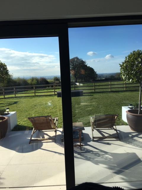

lizzie Posted October 31, 2018 Posted October 31, 2018 Finally got a weather window and the film is going on. For comparison on slider one pane with and one without in pic 2
lizzie Posted October 31, 2018 Author Posted October 31, 2018 Just now, NSS said: Stunning view @lizzie It is we are very lucky. Thank you.
NSS Posted October 31, 2018 Posted October 31, 2018 Just now, lizzie said: It is we are very lucky. Thank you. The ONLY thing that would persuade me to do another build would be if we could get a plot with a view. Surrounded by other houses here, though not overlooked so reasonably private at least. 1

lizzie Posted October 31, 2018 Author Posted October 31, 2018 @NSS we bought the view and the private but not isolated location without much thought other than it was exactly what we wanted just about 5 miles outside our preferred area so not too bad. I can see clear to Malvern 40 miles away no buildings in between, on a good day I can pick out the buildings of Malvern town just with eye not binoculars. Swinging round we see all the way to Clee Hill in Shropshire (Ludlow is behind the hill) and that is a long way again no buildings to impede. Going the other way back up the private road which leads down to us (we had to put in 70 metres of tarmac road to get down to the plot) it is about 10 minutes walk to the butchers, post office pub etc. It was a hugely lucky plot find but expensive on groundworks. 1

lizzie Posted May 31, 2019 Author Posted May 31, 2019 @Alex it is working. We have not had the extremes of last summer but have had some fairly fierce sun and it has reduced the heat coming in to the house by quite a bit. I think it was worth doing.
