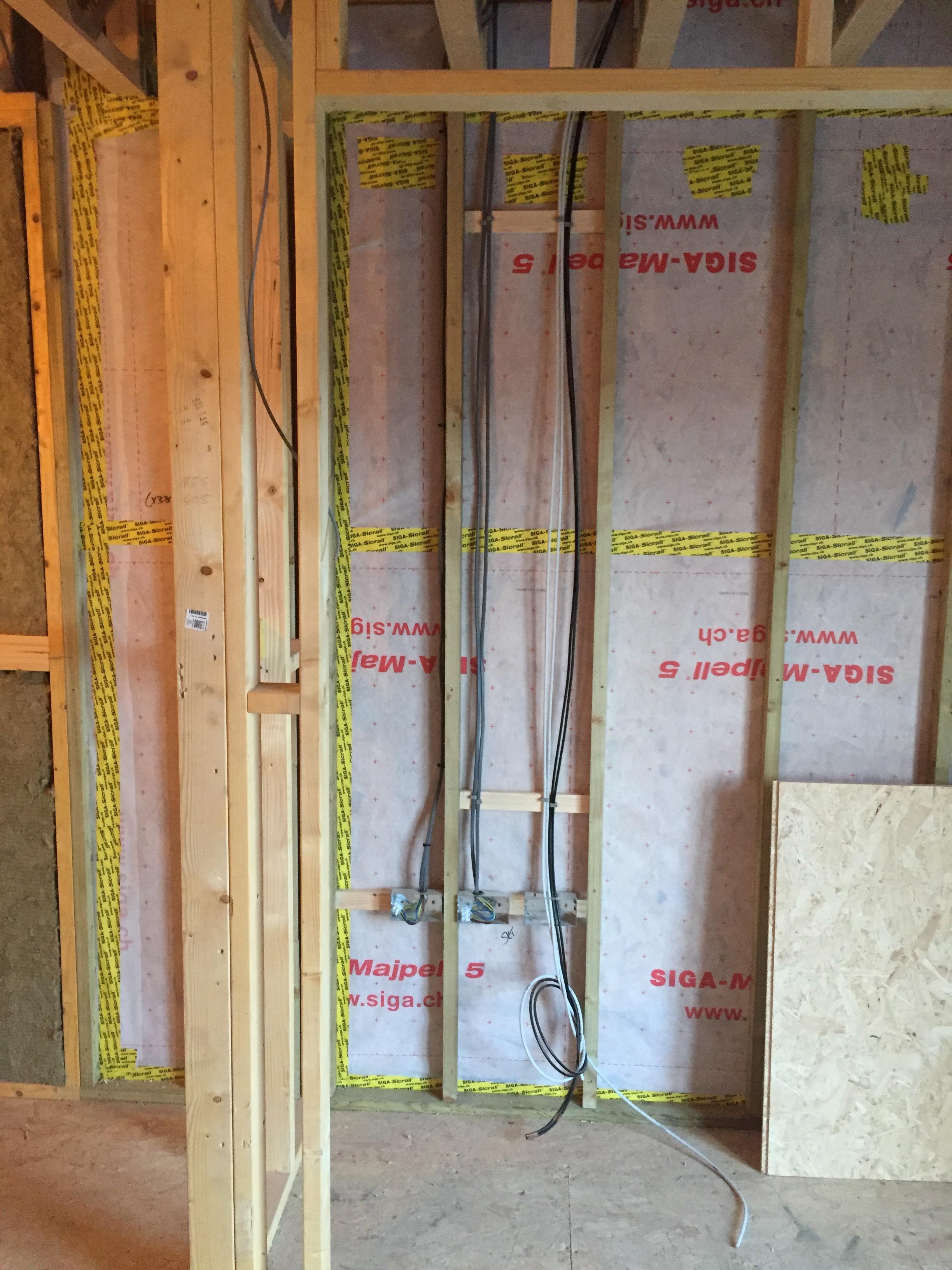

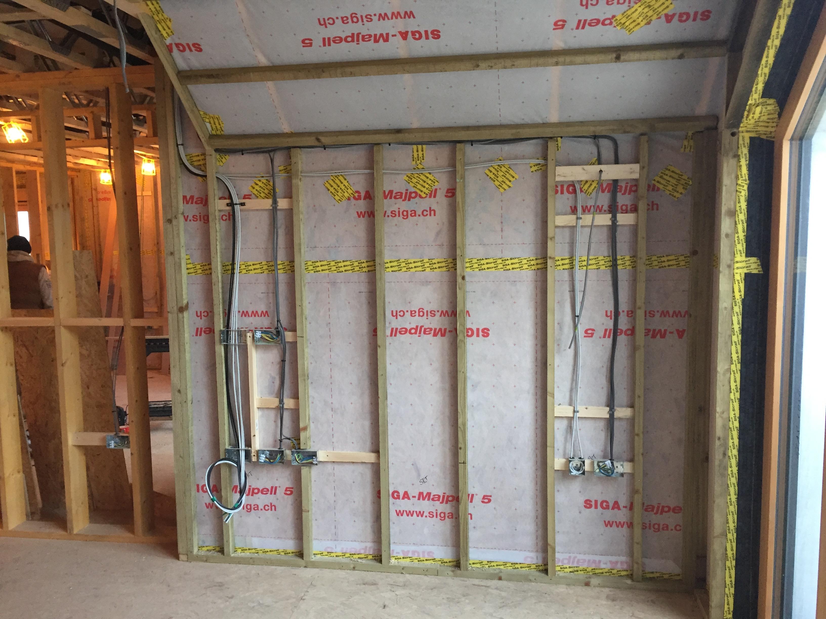

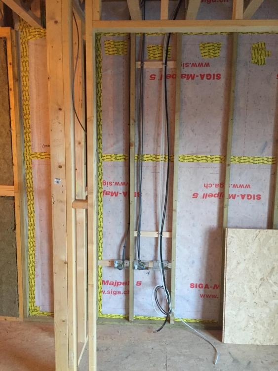

HerbJ Posted October 24, 2018 Share Posted October 24, 2018 (edited) Ideally, you should avoid attaching anything to the Smartply. If you do penetrate the Smartply with pins or screws or accidentally, then you need to seal the penetrations, however small, with tape or sealant. Any such penetrations will make a difference to the integrity of the Smartply for both vapour control and air tightness. All cables (and pipes)should be attached to the battens. All back boxes should be fixed to noggins that are either glued to the Smartply or fixed to the battens - not screwed to the Smartply. . One of the jobs that should be tackled first in 1ST Fix and before the airtest and cellulose filling, should be any conduit penetrations from internal/external that you have planned for external lighting, satellite dishes, alarms, CCTV, etc etc.. It is very difficult to make these penetrations and ensure good seals AFTER the cellulose has been installed. It is useful to have these penetrations installed, sealed and tested as part of the airtest [ I've attached some photos of my 1st Fix to give you an idea. MBC didn't use Smartply on my house but a less robust system using SIGA vapor control layer membranes/tapes over OSB that required more work and superseded /improved with the use of Smartply. Edited October 24, 2018 by HerbJ Link to comment Share on other sites More sharing options...

HerbJ Posted October 24, 2018 Share Posted October 24, 2018 18 minutes ago, dnoble said: The battening is nailed to the OSB so doesn't this compromise the inner skin in exactly the same way as nails in the cable clips 8 minutes ago, Oz07 said: Good point about the battens being nailed through ply. Is this not the same? The battens are nailed through the Smartply or in my Vapour Control membrane/OSB, but all battens are only positioned at the main structural frame lines so even then penetrate the Smartply they are nailed into the main frame supporting it and this effectively seals the nail penetrations. The problem arises when you puncture the Smartply by itself... 24 minutes ago, dnoble said: I see HerbJ you've attached the electrical boxes to horizontal noggins between the battens Does this not cause them to stick out too much from the plasterboard, or did you need especially shallow ones? The battens have been installed with recesses as necessary to ensure the boxes did not protrude through the plasterboard - you have a depth of 50mm (batten +12.5 (plasterboard) = 62.5 mm depth to install the boxes plus the noggin, recessed as necessary. For clarity, the only 1st Fix items we completed before auirtest was the penetrations ( conduit or MVHR Ducting) required for external equipment and these penetrations were pemporarily sealed for the airtest by MBC. Link to comment Share on other sites More sharing options...
Jeremy Harris Posted October 25, 2018 Share Posted October 25, 2018 FWIW, it's vapour tightness that is far more critical than airtightness, as the very last thing you want is water vapour from inside the warm house migrating through the VCL and into the colder timber structure, where it may condense and cause rot. We ran all cables and pipes that went down outside walls alongside a counterbatten, with none fastened to the VCL board (ours used Spano Durelis, rather than Smart Ply, but it also has a green vapour tight coating). Where back boxes has to be fixed to the board, I glued pieces of thin ply to it with quick setting PU adhesive and also applied sealant behind every back box around the screws (easy to do, just blob sealant on the holes and screw through it). This was all down after the air test, but frankly a few screw holes on the board aren't going to make a blind bit of difference to airtightness, what they may do is let water vapour migrate out over a period of years, though, which isn't at all a good thing. 1 Link to comment Share on other sites More sharing options...

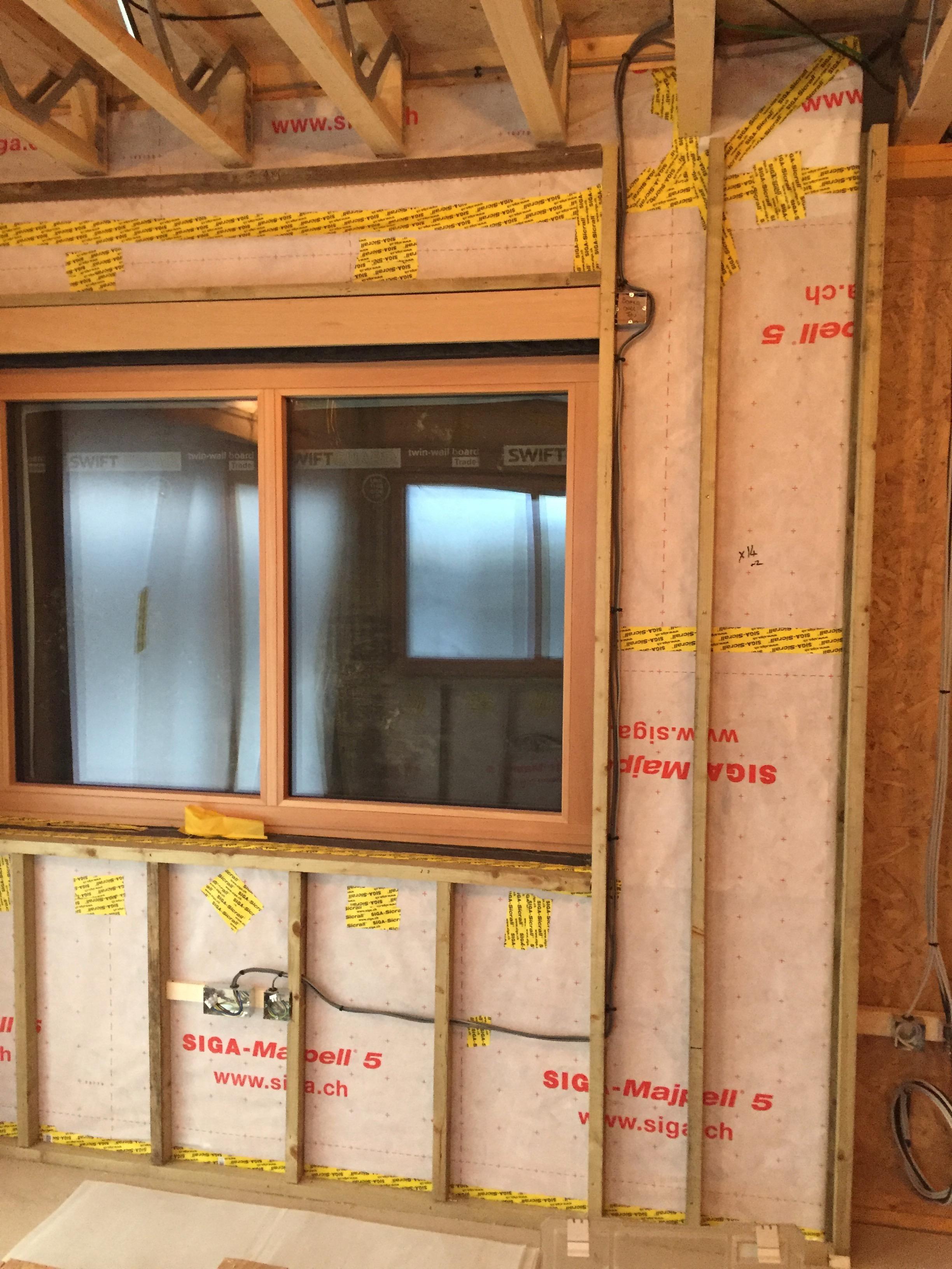

redtop Posted October 29, 2019 Share Posted October 29, 2019 I thought there was tape you could put between the battons and the smartply that sealed the holes from the nails / screws. Doesn't help with the cable clips though. Also notice in one of the previous photos there was a horizontal cable run halfway between bottom of window and floor to the socket. Surely this wouldnt pass muster? Link to comment Share on other sites More sharing options...
ProDave Posted October 29, 2019 Share Posted October 29, 2019 50 minutes ago, redtop said: Also notice in one of the previous photos there was a horizontal cable run halfway between bottom of window and floor to the socket. Surely this wouldnt pass muster? That cable running horizontally from the socket under the window is in the safe zone created by that socket. It then turns upwards and runs up alongside the window to a 1G back box, so is in the safe zone created by that accessory. Nothing wrong with that at all. Link to comment Share on other sites More sharing options...
redtop Posted October 29, 2019 Share Posted October 29, 2019 11 minutes ago, ProDave said: That cable running horizontally from the socket under the window is in the safe zone created by that socket. It then turns upwards and runs up alongside the window to a 1G back box, so is in the safe zone created by that accessory. Nothing wrong with that at all. ah got ya. not fully up to speed with the safe zones ? guess its something to do with being unable to run the cable vertically due to window. obvious really lol Link to comment Share on other sites More sharing options...
ProDave Posted October 29, 2019 Share Posted October 29, 2019 7 minutes ago, redtop said: ah got ya. not fully up to speed with the safe zones ? guess its something to do with being unable to run the cable vertically due to window. obvious really lol Safe zones run vertically and horizontally from every accessory. All my sockets are wired horizontally around the room from socket to socket. As long as there is one socket on each wall you can go right round the whole room. Leave a little bit of slack cable in each leg, and at any time in the future you can cut another hole in the plasterboard and add an extra socket anywhere you want to. Link to comment Share on other sites More sharing options...
redtop Posted October 29, 2019 Share Posted October 29, 2019 2 minutes ago, ProDave said: Safe zones run vertically and horizontally from every accessory. All my sockets are wired horizontally around the room from socket to socket. As long as there is one socket on each wall you can go right round the whole room. Leave a little bit of slack cable in each leg, and at any time in the future you can cut another hole in the plasterboard and add an extra socket anywhere you want to. every day is a learning day ? is that how they usually do it? any idea on how you avoid making holes in the VPL when fixing vertical cable clips (we will be using propassiv OSB) Link to comment Share on other sites More sharing options...
ProDave Posted October 29, 2019 Share Posted October 29, 2019 2 minutes ago, redtop said: every day is a learning day ? is that how they usually do it? any idea on how you avoid making holes in the VPL when fixing vertical cable clips (we will be using propassiv OSB) It is how I usually do it for the reason already stated. Not everyone agrees. One build I did, the joiner building the house just would not accept I could do that, to the point we had a stand up finger wagging argument about it. I don't normally get worked up, be he was basically trying to physically stop me drilling the studs to run my cables through. You avoid penetrating the VPL by nailing the cable clips to the sides of the battens. 1 Link to comment Share on other sites More sharing options...
