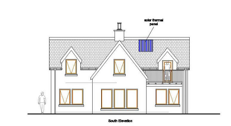

Thedreamer Posted October 14, 2018 Share Posted October 14, 2018 I went from this: To this via a non material varation. Luckly enough they started charging for NMVs a few weeks later, so cost me nil in planning fees. 1 Link to comment Share on other sites More sharing options...

Ferdinand Posted October 15, 2018 Share Posted October 15, 2018 7 hours ago, Thedreamer said: I went from this: To this via a non material varation. Luckly enough they started charging for NMVs a few weeks later, so cost me nil in planning fees. They would like that .. it is smaller and you can see fewer neighbours from upstairs :-). F Link to comment Share on other sites More sharing options...
