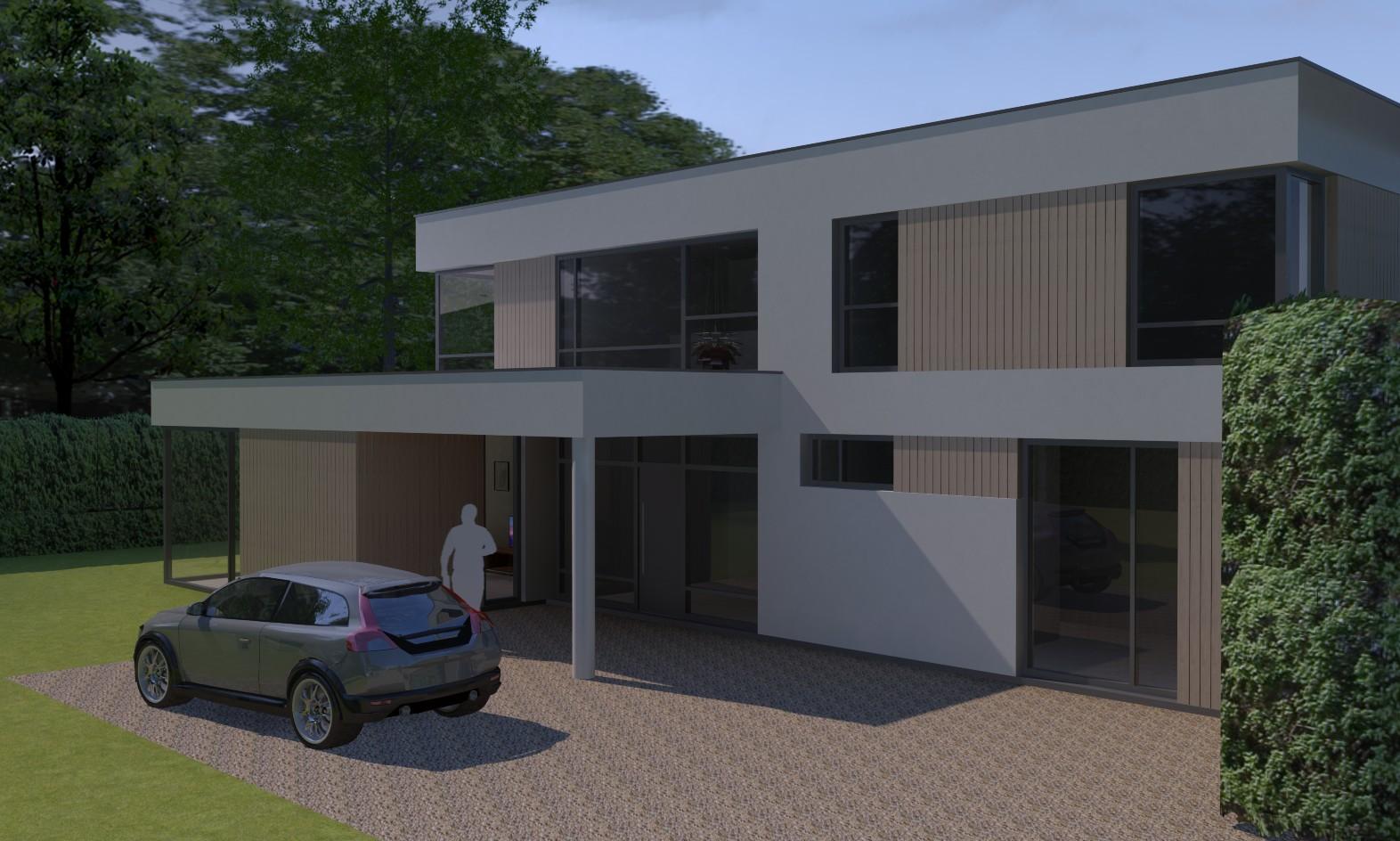

AliG Posted April 16, 2019 Author Posted April 16, 2019 My architect spoke to the planner today who told him that they plan to reject the proposal. We are quite annoyed as this is the first contact we have had with him. The decision deadline was 28th March and he did not return any calls from the architect or ask for an extension. He gave various reasons including that they want the house hard to one side of the plot, that the area is too large and that they don’t like the materials. My strong suspicion is that in fact he was going to approve it and then when he put it to his manager they said they didn’t want it approved. This explains why we didn’t hear anything from him, giving us no opportunity for discussion. The architect could yet request a meeting with them which they may deny. We can let it be refused and appeal but as they have passed the determination deadline we could also take it straight to review although I don’t know if that would be a good or bad idea. The application was made in January with a 28 March deadline and I think it is entirely unreasonable to ignore us until this point. It did change from awaiting assessment to awaiting decision at the end of March which is what makes me suspicious that he intended to approve it. 1
Mr Punter Posted April 16, 2019 Posted April 16, 2019 I'm sorry. That is a shame as I like the design. Can you find out the actual planning reasons for each of their grounds and perhaps modify the location or show in context / justify or modify the materials etc? Often a few small compromises is enough. 1
AliG Posted April 16, 2019 Author Posted April 16, 2019 They gave a few reasons verbally but it is difficult as I have never seen this situation where they have provided no feedback at all. The only way to see the reasons may be to allow it to be refused. We are not married to the materials and would happily change them. The architect thought that reason was just thrown in. The listed house next door has a zinc extension and the house across the road just built is in white render much cheaper materials with upvc windows and soffits. It too is in the garden of a listed house.

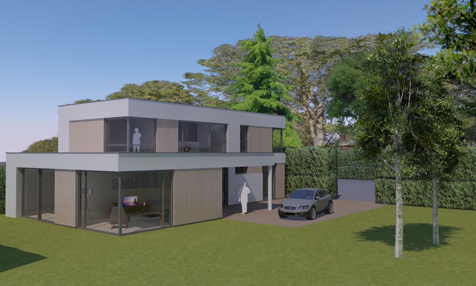

AliG Posted June 19, 2019 Author Posted June 19, 2019 We have employed a planning consultant and are going to redesign the house in line with the planners concerns. I seriously doubt that the new design will be as attractive or as unobtrusive, but the planners seem dead set on the house being on a certain part of the plot. In fairness the architect is very good at design and it may be that I am just comparing something I have seen to something I am just guessing at. So bizarrely given the choice of an unobtrusive single storey house they appear to want a two storey house that is more obtrusive but covers less ground. We are going to try to design something mainly one storey with a a guest bedroom upstairs. The argument seems to be that it stays further to the side of the listed house next door, but you wouldn't be able to see it anyway, so this is just odd. They also have an issue over the conservation area being described as open, despite the fact that the plot is actually entirely enclosed. The consultant's view is that it is best to look as if you took their concerns into consideration. He does, however, think they may just not want to approve anything different to what has already been approved. Our single storey house was much more well received by the locals, but this seems to be of no concern to the planners. And of course this is taking a lot of time, whilst my parents aren't getting any younger.
lizzie Posted June 19, 2019 Posted June 19, 2019 Complete madness, I feel for you. Our planning was only approved as we have a very modern single storey construction. They turned down flat a proposal for a 2 storey ‘vernacular’ and said only a statement modern house would do in the context of it being in the garden of a Georgian house (which is not listed but is noted as of special historic interest). I think it is all at the whim of the planner in charge. I hope you can get a resolution and get on and build it and get it done whilst your parents are still young enough to get some use and enjoyment out of it.
AliG Posted June 19, 2019 Author Posted June 19, 2019 (edited) It seems entirely random. On this site the current permission is for something that looks like the house next door, we don't particularly like it. Yet across the road when a house was built in another listed house garden they insisted on something modern and not a "pastiche". The funny thing is that after years of argument, they approved a modern house across the road. Someone then bought the land and reapplied for a much less interesting, cheaper to build house and it just sailed through with no argument. I am still suspicious that in fact the planner was going to approve our house and his boss stopped him. In the immediate vicinity of 7 or 8 houses, there is a render and brick listed house, a sandstone listed house, two rendered 1930s houses, a render and zinc 2015 house, a red brick 1980s house a render and stone 1980s house and a pebbledash 1970s house. Edited June 19, 2019 by AliG 1

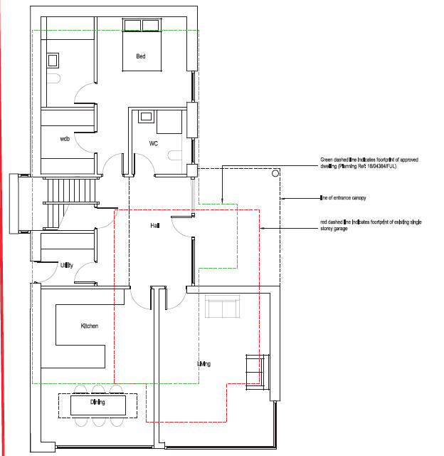

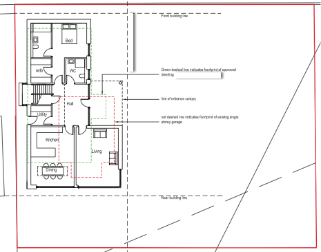

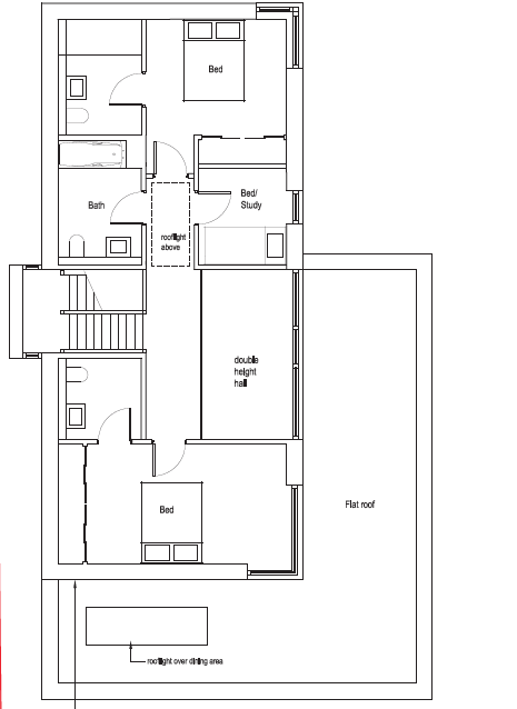

AliG Posted August 13, 2019 Author Posted August 13, 2019 (edited) OK. Take 2. Based on discussions with me the architect has pretty much nailed what we were looking for, hopefully planning like it too. We have ended up with 5 toilets. Any thoughts on doing away with the main bathroom upstairs and making it a plant room. With all the bedrooms being en suite it doesn't really seem necessary, but would people find not having a bathroom odd? If we keep the bathroom I might ask for a the downstairs shower room to be a little smaller allowing the bedroom to be bigger. I would also like the kitchen to be around 300mm longer, but there may not be space to do that, we could make the utility a little smaller. I would probably do away with the back door. I might want another window in the lounge. The architect may draw up a different exterior treatment and porch arrangement. Any other thoughts? Site plan Ground floor First floor Edited August 13, 2019 by AliG
newhome Posted August 13, 2019 Posted August 13, 2019 Is that the only bath? I think a 4 bed would need at least 1 bath TBH. Could you incorporate a bath into one of the other bathrooms? The one behind it maybe, then make a smaller ‘plant’ room out of the main bathroom. Do do you need the downstairs WC to have a shower given that there is one at ground level anyway and all of the other bedrooms are upstairs? Given that this is a house for your parents is there provision for a lift or stairlift eventually?
AliG Posted August 13, 2019 Author Posted August 13, 2019 If I lost the bathroom I would switch the en suite on the upstairs bedroom to having a bath instead of a shower. Their bedroom will be downstairs so they basically can just live downstairs if they start to struggle getting upstairs. Frankly the building regs on accessible showers in Scotland are daft. You cannot count an ensuite as an accessible shower. You either have to have one off the hall or provision to add one later. The room has to have 800x1100mm clear space in line with the door plus activity spaces in front of the equipment. Thus the architect has made it very large. However, if we make it future provision, I believe we can say that we will reverse the door at that point to swing out the way and cut 500mm off the size of the room, making it just a large WC.
Ferdinand Posted August 13, 2019 Posted August 13, 2019 (edited) I would move the door to the bathroom up, and that to the study down, so that by moving the door to the top bedroom down by 1m there will be the option of a second posh master suite like the one downstairs. Gives your parents similar suites upstairs and downstairs including the bathroom as a wardrobe should they want it. Not sure if that will help them, but gives a more flexible design. As to bathroom, one option we worked out for somebody else was put plumbing in behind walls, and use it for now as whatever you want ... of which above I give one example. Edited August 14, 2019 by Ferdinand 1
