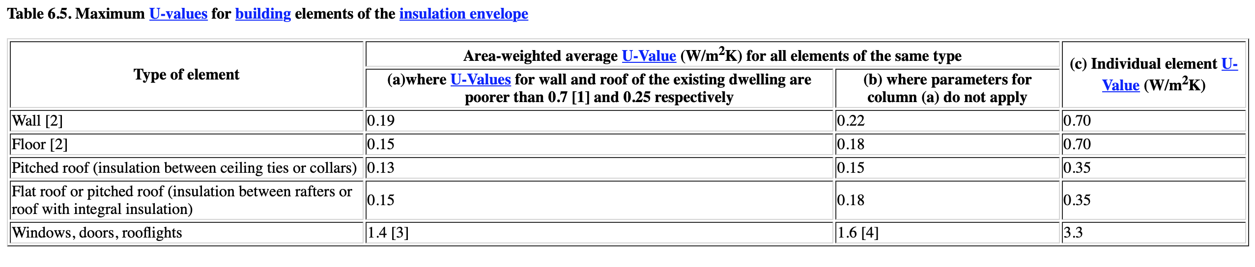

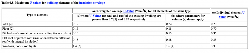

Last Cast Posted October 2, 2018 Author Share Posted October 2, 2018 Thanks for all the replies folks I should have said in my original post Im using TJI floor joists that I picked up as leftovers from a job. Regarding U values would building control let me away with 0.13 instead of 0.11 what are folks experience of this? Link to comment Share on other sites More sharing options...
AliG Posted October 3, 2018 Share Posted October 3, 2018 These are the figures from the building regs. Assuming that the house you are extending has a decent level of insulation the limit for a flat roof is 0.18. This can be varied if other elements are better than the limits. Link to comment Share on other sites More sharing options...
