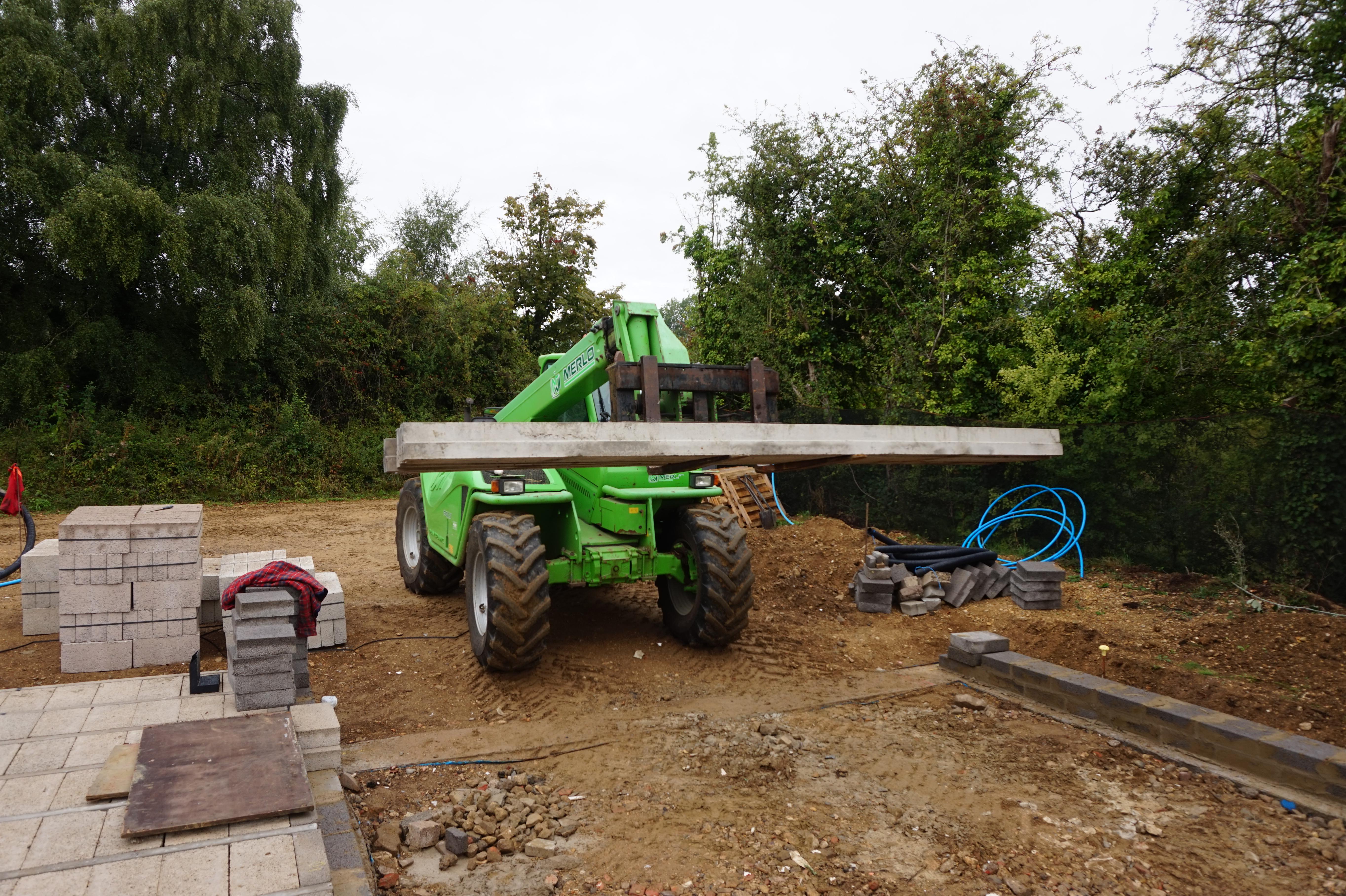

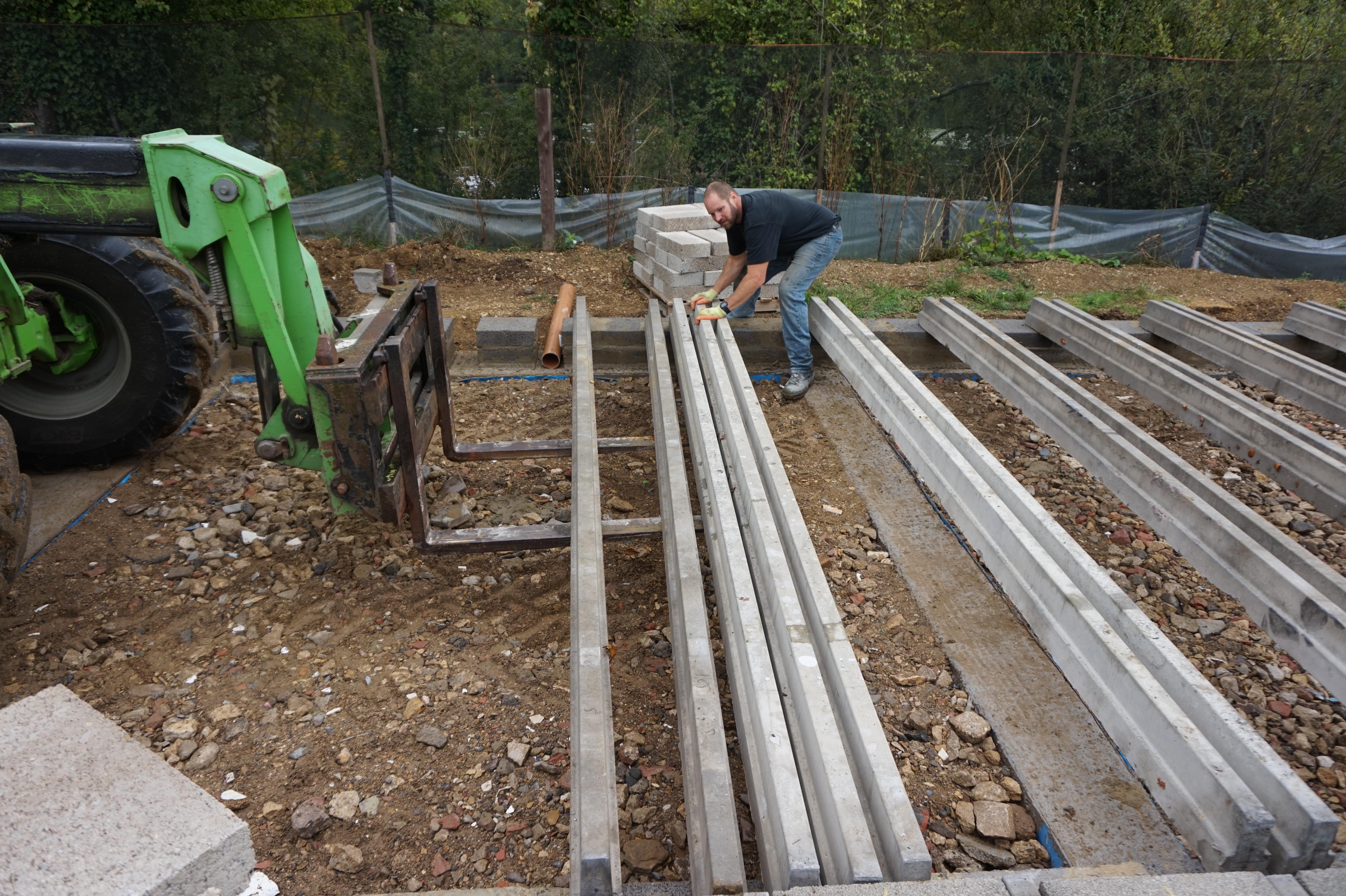

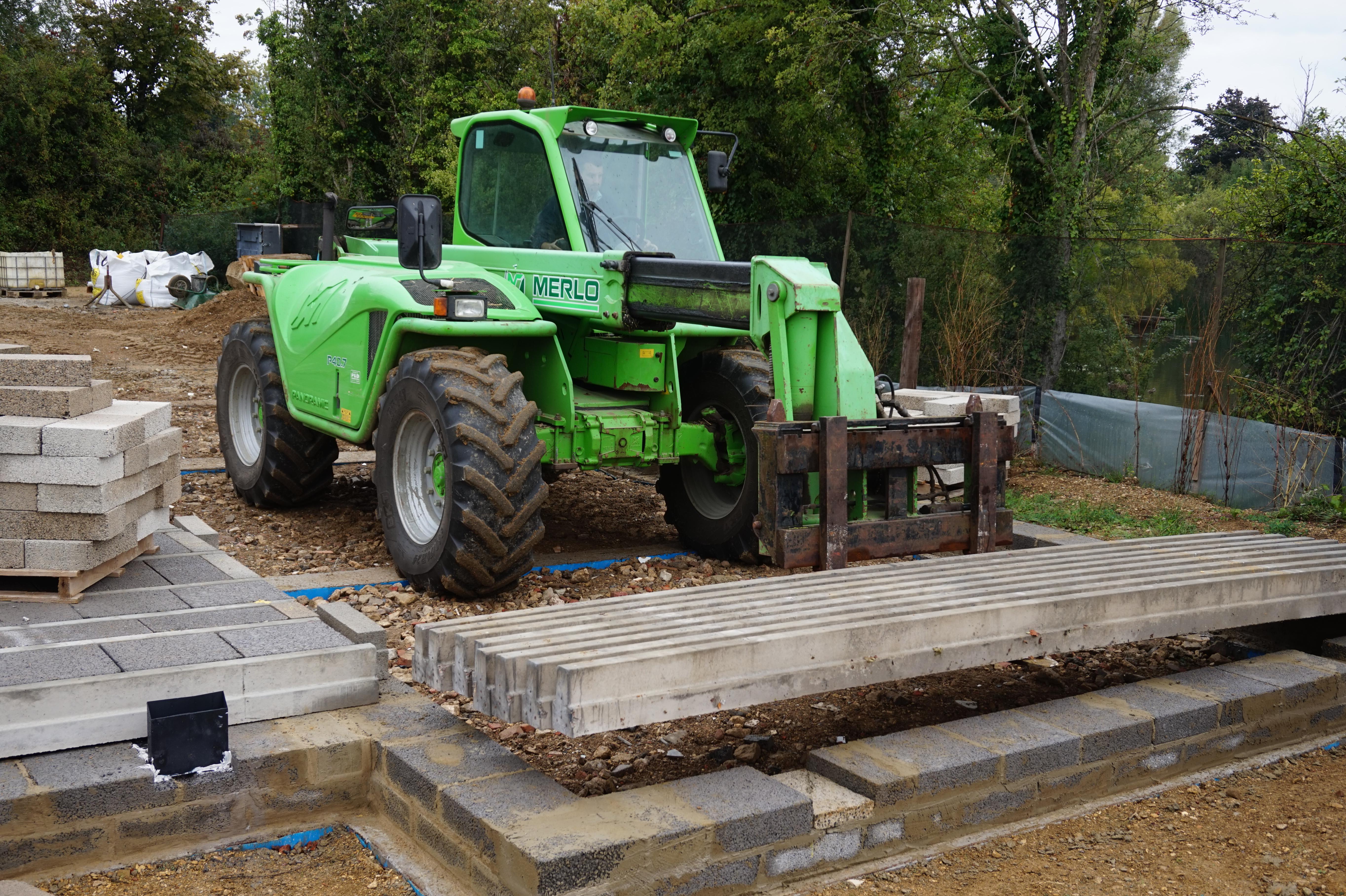

Russell griffiths Posted September 30, 2018 Share Posted September 30, 2018 Just a silly topic if anybody is having to do this sort of thing themselves i had 16 tonnes of concrete floor beams to put in place at a distance of 15m from where we could get the closest lifting equipment, answer don’t build the front wall of the house and drive the forklift inside the house working your way out until all beams in place, once all in place finish off the last bit of wall. Pic one the forklift sitting in the back bedroom, pic 2 halfway, pic 3 just exiting the garage. All done. 3 Link to comment Share on other sites More sharing options...

Russell griffiths Posted October 1, 2018 Author Share Posted October 1, 2018 MORE THOUGHT. I don’t borrow equipment ever pay the farmer to come and do it, it’s his if it gets damaged it’s down to him, blowing up a diff or breaking a gearbox will hurt you in the wallet dept big time. Slinging under the forks. Why. It’s a forklift use it as it was designed look at the pic and you can see the beams are not in the final position. Why. Placing them exactly takes time, I paid our farmer for an hour of his time, he was crazy busy as it was harvest time, so he said he could help but only quickly. plonk the beams down to within 100mm of their final destination, send farmer Fred on his way clutching a pile of readies, move beams to final resting place by a gentle lever with a bit of 4x2 TOP TIP. Don’t put your damp course under them until the end, sliding them about will only scuff it and tear it one bloke can easily lift a beam end with a bit of timber as a lever, the other bloke fits dpc all nice and flat. Link to comment Share on other sites More sharing options...

Russell griffiths Posted October 1, 2018 Author Share Posted October 1, 2018 @epsilonGreedy not really the beams where 4.7 long the forks are spaced the furthest apart you can get them, let’s guess a metre, so they are sitting there very firmly, forklift bounces over a rut in the ground, er nope, all ruts levelled and filled with hardcore, as the saying goes smooth as a babies bum. Link to comment Share on other sites More sharing options...
