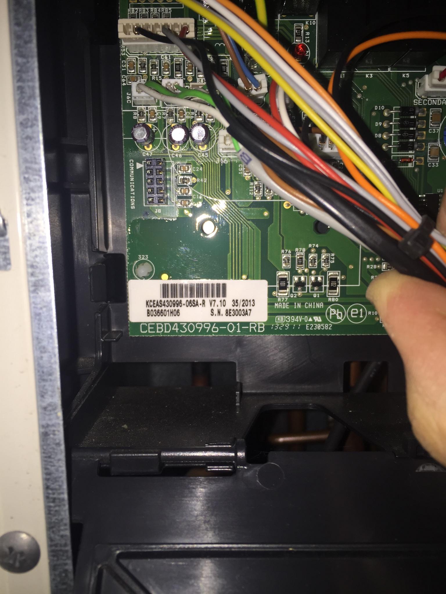

@Gav_P  Your board arrived this morning.  I am glad you sent the complete assembly including the transformer.
First finding, there was no output from the transformer.  Primary winding appears open circuit.

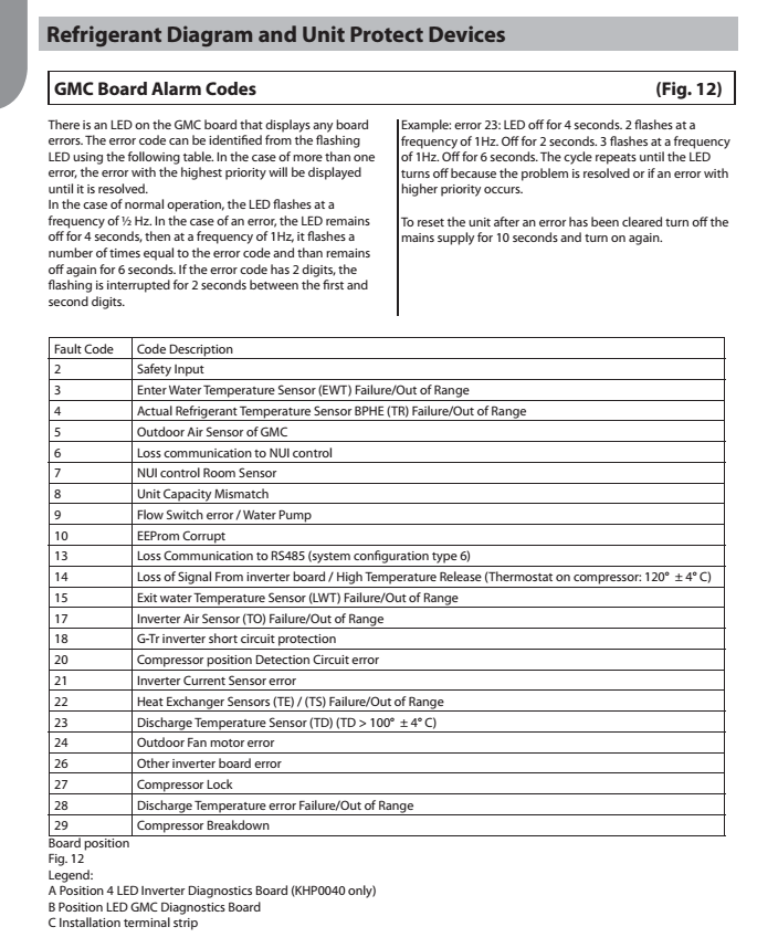

Step 2 try powering the board from a bench power supply fed into the transformer input. As this feeds into a bridge rectifier, the polarity from the bench supply should not matter.  The board powers up and the LED is flashing away. giving 4 flashes, a pause then 1 flash. No doubt a fault code as just about everything is unplugged.
It looks like the overload on the power supply due to the short circuit caused the thermal protection in the transformer to blow.
 It may or not be possible to repair the transformer, it might need a new one. I will keep you posted.
These are the GMC fault codes:
Sounds like good news, @ProDave.  As it's giving fault codes it suggests to me that the board is alive and working and only the 12 V supply got shorted.  Fingers crossed that replacing the bridge rectifier and fixing/replacing the 12 V transformer fixes it.  With luck it will still have retained the settings in the non-volatile memory, too.
Sounds like an error 14 which would indicate that the board can’t see the inverter board which does indicate a heartbeat.

Hooray, my new board has arrived. BEWARE, IT HAS A STATIC DEVISE NOTICE, ONLY HANDLE ON A STATIC SAFE WORKSTATION. I will earth myself before unwrapping it and installing it. I will check the 12volt supply. Currently shifting building materials around site so will attempt to fit/check 12v ASAP and will report back.

.........Stop press........., now it’s stopped raining I have looked at mine and I am getting about 14v ac from my 12v transformer. (So that’s not blown, ) phew. I have replaced the board and.............my little led is flashing as it should ?and no error codes on the command unit. I am going to review the wiring and confirm it’s all ok then try it out. Here’s hoping. ?
