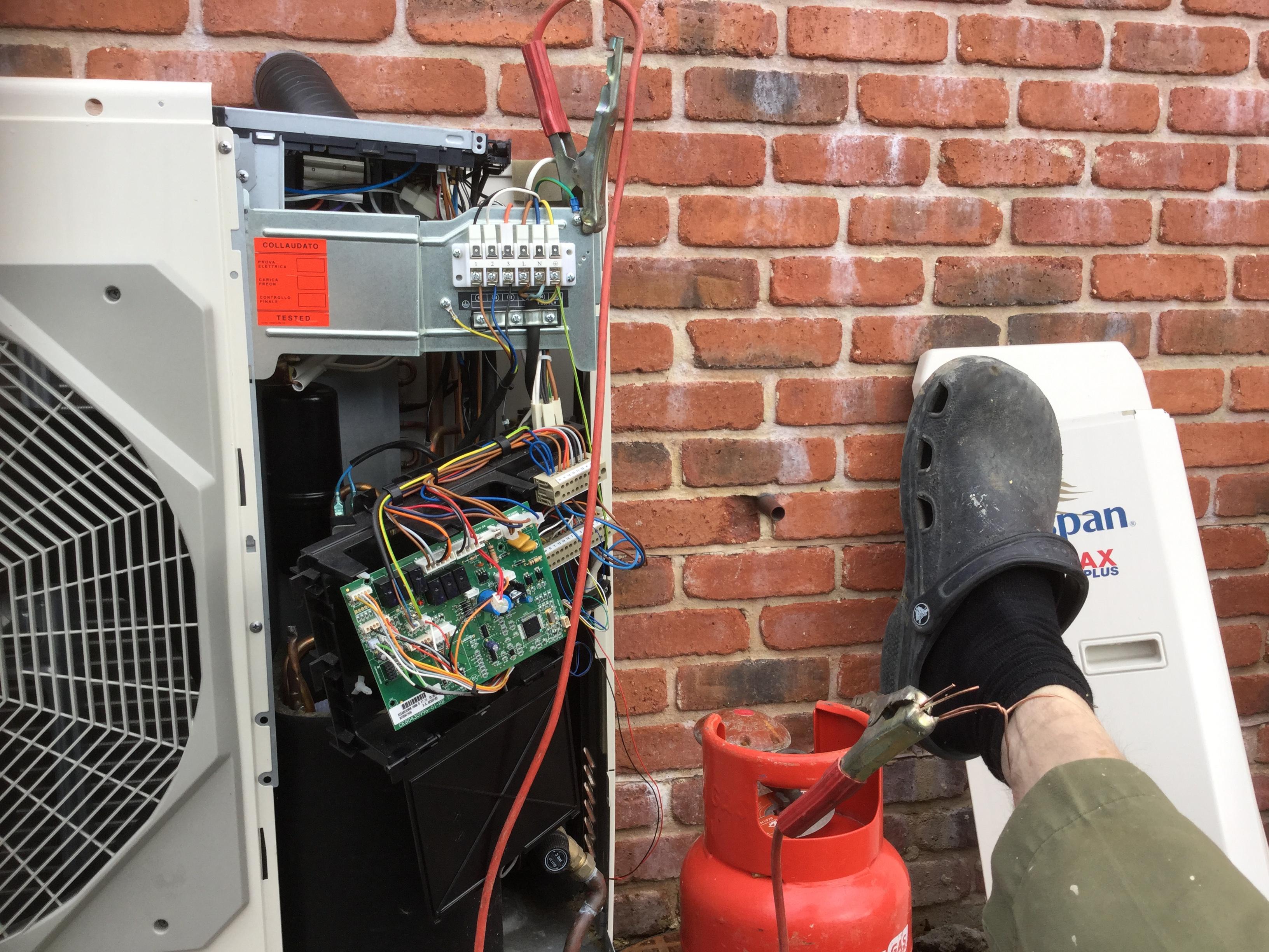

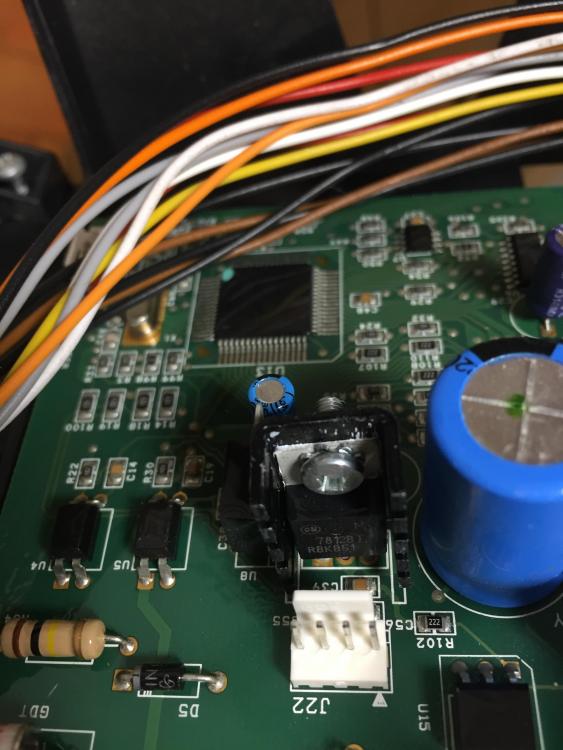

.........Stop press........., now it’s stopped raining I have looked at mine and I am getting about 14v ac from my 12v transformer. (So that’s not blown, ) phew. I have replaced the board and.............my little led is flashing as it should ?and no error codes on the command unit. I am going to review the wiring and confirm it’s all ok then try it out. Here’s hoping. ?
what do do you think of my high tech earth strap???
A bucket of dirt with a rod banged in makes a convenient portable earth point...
:ph34r:

The transformer arrived today and your unit is now working @Gav_P
I will post it back early next week.

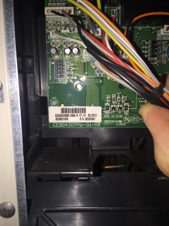

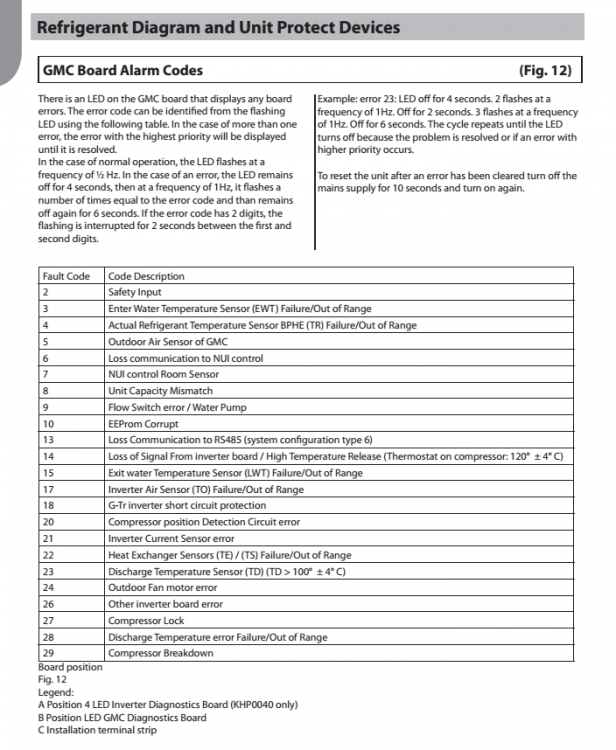

So I received the board back from @ProDave on Thursday but wasn’t home until today to fit it.
Popped it in and powered the unit up. Turned on the room stat and the ASHP fires up... for 10 seconds, then turns off. The LED is blinking an error code (9), and before I check what it is I’m certain it’s low flow as I turned the pump down when using the willis heaters. So I crank the pump up a level and the ASHP fires up again.... but then I realise the fan isn’t turning and I have a different LED fault code flashing away (24).... it’s the fan.
I’m thinking I’ve managed to bugger up the fan motor now! So I try to give it a little help with a screwdriver, kind of hoping a bump start would sort it. But it doesn’t budge, it’s solid!
So I take the fan cover off and it appears a bit of foam has come unstuck and fallen down between the fan and the housing. I take it out put the cover back on and, third time lucky ????
Its working great! Thanks @ProDave for diagnosing and replacing the transformer and thanks everyone else for your advice and input!!
