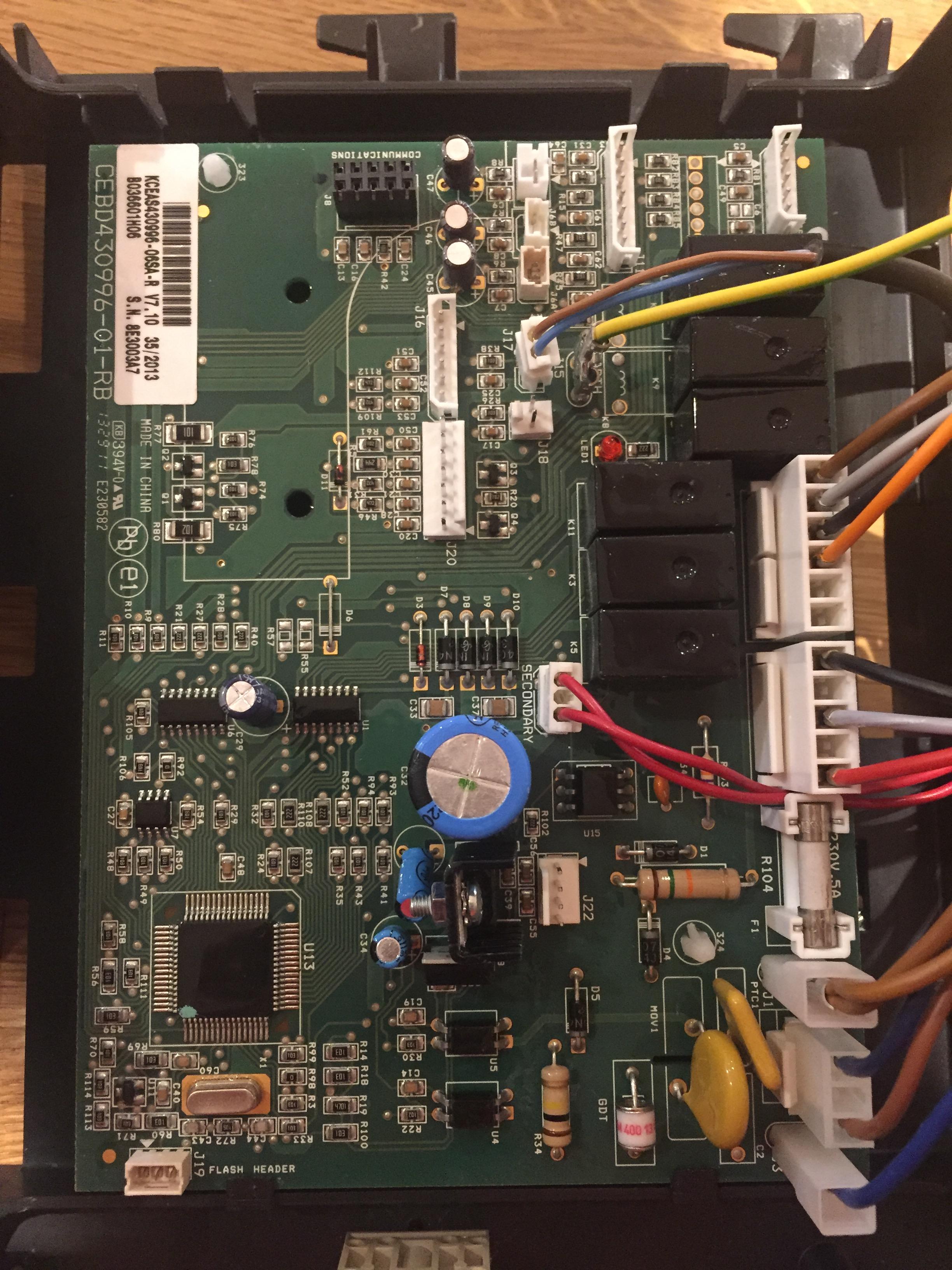

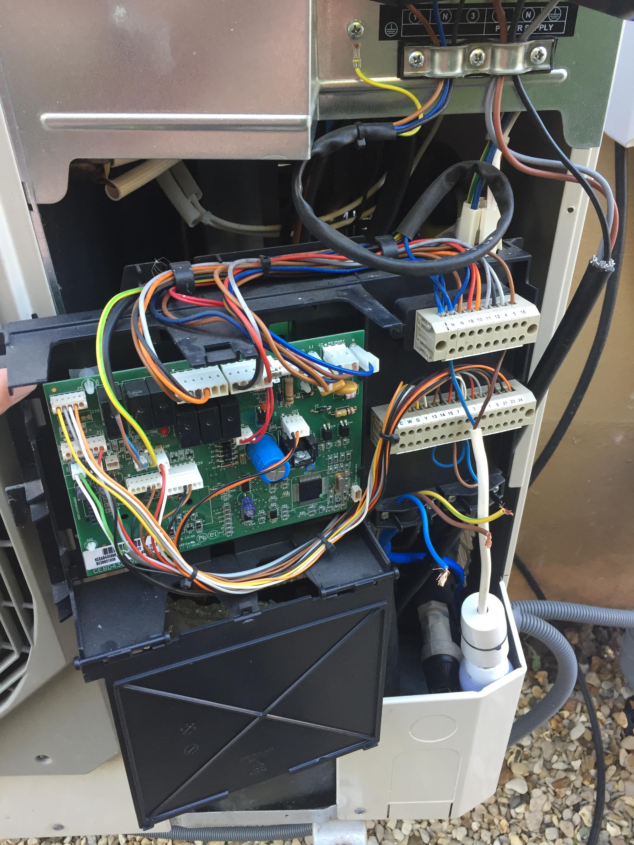

Gav_P Posted September 26, 2018 Share Posted September 26, 2018 Hi all, I’ve been a long time lurker, but this is my first post on the forum... of course it’s because I have an technical problem that I need help with, and based on all the previous discussions on here I’m thinking there is more than enough experience to enlighten me! I have a 4kw Kingspan Aeromax Plus KHP0041 (made by Carrier), heating my UFH system downstairs and radiators upstairs, all was working fine until...it wasn’t. I have 240v in the unit, but no blinking LED on the GMC board. Now i’m not certain what the issue/cause is, but it might be related to the fact that I decided to wire in the alarm unit, so I could see from indoors if there were any issues without having to go out and open up the unit to look at the blinking LED on the GMC board. For some reason I thought it was a 0v feed so didn’t switch off the power and when posting the wire thought the wall I think I shorted it out... as I’m fairly sure it’s actually 12v. So without giving me too much grief for being stoopid, do you have any other suggestion of what would cause the GMC board LED to stop flashing or how I could test it? Before I go and buy a replacement PCB. In penance, I do have PDF copies of the Kingspan Installation Manual, the Carrier Service Manual and the Carrier Spare Parts document. If it’s of any use to anyone. Thanks Gav Link to comment Share on other sites More sharing options...

ProDave Posted September 26, 2018 Share Posted September 26, 2018 Can you post a high resolution (as high as you can) picture of the board? Link to comment Share on other sites More sharing options...
Gav_P Posted September 26, 2018 Author Share Posted September 26, 2018 @ProDave how’s that? Link to comment Share on other sites More sharing options...
ProDave Posted September 26, 2018 Share Posted September 26, 2018 Well there is the obvious fuse to check towards the bottom right of the board in line with all the connectors. And a bit left of that is a tab power device that I am willing to bet is a voltage regulator, check if it is delivering the correct (or any) output. Clue, a pair of red wires to the connector "secondary" is no doubt the output from a transformer, there are 4 diodes that look like a bridge rectifier, and a big capacitor, all points to that being the DC power supply for the board. Link to comment Share on other sites More sharing options...
Gav_P Posted September 26, 2018 Author Share Posted September 26, 2018 @ProDave thanks. I’ve check the fuse, that’s the 240v that go to the transformer on the back of the board returning (as you point out) via the 2 red wires as 12v.... after that I haven’t got a clue. And not sure how to test any of the components. Plus they are all coated with something (I assume to protect it from the elements) so I can’t get my tester on anything. Link to comment Share on other sites More sharing options...
ProDave Posted September 26, 2018 Share Posted September 26, 2018 Measure with a DC volt meter from ground (0V) to the bolt passing through that tab power device sticking up from the board. If the board has been hermetically sealed you should be able to get a connection onto that bolt. Link to comment Share on other sites More sharing options...

Gav_P Posted September 26, 2018 Author Share Posted September 26, 2018 @Triassic sorry no, I wasn’t very clear. This board has an LED that flashes at 1/2hz when the unit is on, but it flashes different sequences if there’s an issue. However this board is inside the unit and you have to remove panels to see it. So there is an external ‘alarm unit’ that you can wire into it that can be sited somewhere more convienent (like indoors). So I connected the 3 wires to the appropriate connecting block (off to the right side of the PCB pictured here) and then poked the wires through the house wall. But because I stupidly assumed it was 0v I left it live whilst doing it. Link to comment Share on other sites More sharing options...

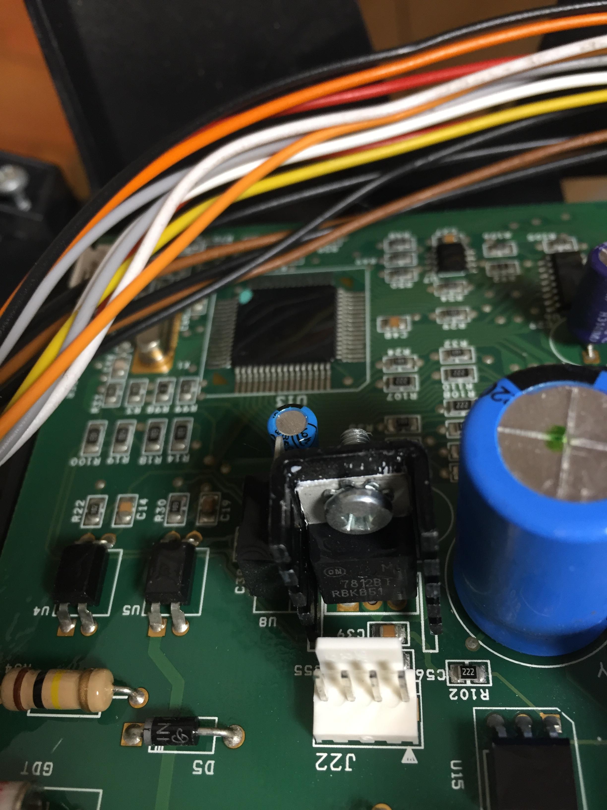

Ed Davies Posted September 26, 2018 Share Posted September 26, 2018 The orange and black wires on the plug in J22 (between the fuse and the heatsunk device) - where do they go? To 23 and 24 on the lower connector block to the right? Does the book say what they are? General purpose 12V supply? Worth checking? Too long a string of suppositions? Link to comment Share on other sites More sharing options...
Gav_P Posted September 26, 2018 Author Share Posted September 26, 2018 @Ed Davies yes they go to 23 & 24 which is.... *rummages through the book* an optional external airsensor apparently. Link to comment Share on other sites More sharing options...
Ed Davies Posted September 27, 2018 Share Posted September 27, 2018 OK, weird that's by the power supply stuff when all the other i/o is on the other side of the board. Link to comment Share on other sites More sharing options...

Ed Davies Posted September 27, 2018 Share Posted September 27, 2018 Can you see the part number on that heat-sunk device ProDave suggested putting a meter on the bolt of? Might have to unplug J22 to look at it. I'm thinking it's likely a 7812 voltage regulator or some modern equivalent. If it's a 7812 then the tab will be grounded so measuring the voltage on the bolt won't help much. If it's an LM317 or similar then the tab and bolt will be at the output voltage so a bit more interesting. Link to comment Share on other sites More sharing options...
Gav_P Posted September 27, 2018 Author Share Posted September 27, 2018 @Ed Davies Nice guess... it’s 7812B Link to comment Share on other sites More sharing options...
ProDave Posted September 27, 2018 Share Posted September 27, 2018 Don't see much any solder on that middle pin. As viewed, left hand pin is Vin should read in excess of 12V, middle pin (and tab) is ground, and right hand pin is Vout and should read 12V Simple checks to make. Careful not to short anything. Link to comment Share on other sites More sharing options...
Ed Davies Posted September 27, 2018 Share Posted September 27, 2018 … and careful not to touch any of those components below and left in that picture (GDT, MOV1 and neighbours like D5) as some are likely to have mains voltage on them. They're for protection against spikes on the power line, etc. Link to comment Share on other sites More sharing options...

Onoff Posted September 27, 2018 Share Posted September 27, 2018 Take a better photo of the label on the pcb and all the numbers etc on the board around it. There's people on here will take great delight in scouring the interweb thingy for a circuit diagram! Link to comment Share on other sites More sharing options...
