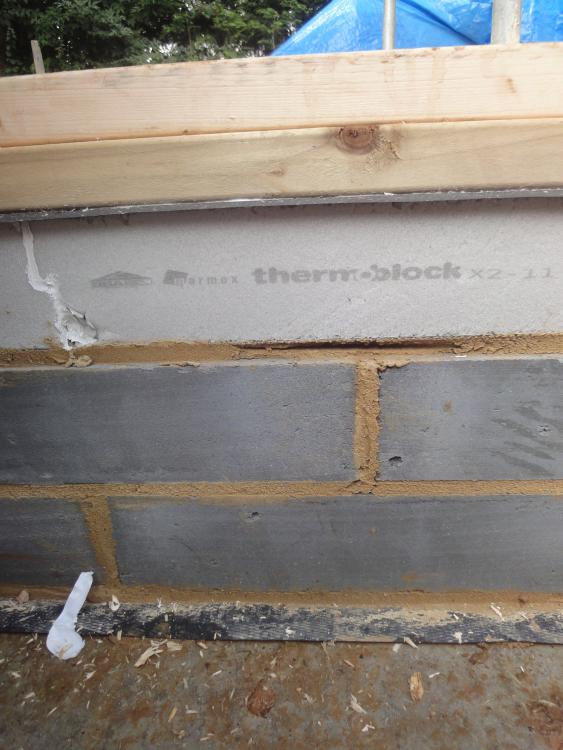

curlewhouse Posted July 25, 2016 Posted July 25, 2016 On the old eBuild forum a very good point was raised about the fact that with SIPs your sole plate will be sitting on your foundation wall, so that will be where any moisture in the air condenses... and your wooden sole plate will be sat in the wet, with potential problems. After a few conversations with my architect about this (and if you stop to think about it, it is a very good point) we are looking at something called Foamglass which is strong enough to build on. It will be interesting to see what our SIPs supplier's engineers and BC say as it could be an elegant solution, plus actually increase our insulation. 1
jack Posted July 25, 2016 Posted July 25, 2016 I looked at this before we started looking at raft foundations. I recall it being interesting stuff, but very expensive. I think it's produced somewhere in Scandinavia.
curlewhouse Posted July 25, 2016 Author Posted July 25, 2016 (edited) Yes, I haven't seen the price yet, but my architect did warn me it was expensive but that we'll only need one layer thank goodness. Product details link HERE Edited July 25, 2016 by curlewhouse 2

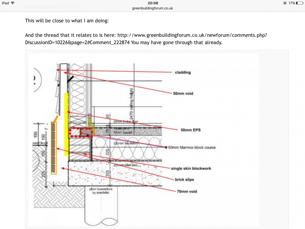

oranjeboom Posted August 4, 2016 Posted August 4, 2016 (edited) I used Marmox Thermoblocks under my sole plate. Also ££ but I think may have been slightly cheaper. I did end up going to Belgium as local merchant (Jewson) messed me around with supply of the size I was after. Worth checking on lead times and don't believe anything your merchants tell you - go direct to manufacturer for confirmation on UK stock. Blocks were easy to lay and nice and light to carry around. And should help protect the sole plate. Edited August 5, 2016 by oranjeboom photo 1

K78 Posted October 22, 2016 Posted October 22, 2016 I was reading a thread on another forum where it was suggested that a strip of 50mm EPS 150mm above and below the sole plate, solves the problem.
K78 Posted October 22, 2016 Posted October 22, 2016 14 hours ago, IanR said: What U Value are you targeting? While foamglass is better insulating than other block work, it's not quite as good as EPS, so to achieve a Passive-slab type level of 0.1 U value for the floor and perimeter you'd need roughly 350mm foamglass. But that's not the whole "issue" with SIPs. If you wish to eliminate cold bridging and condensation risk on the sole plate then you need an additional external layer of insulation that drops down passed the sole plate. Where as on a thicker twin-stud wall or I-Joist wall there is an opportunity to place an EPS upstand under the middle of the sole plate so that the inner face of the wall is over the warm floor and the outer face is over a cold ring beam (or on the EPS upstand itself in the case of the twin-stud) and therefore braking the cold bridge, you can't do this with a SIP panel. Hence the need for EWI to isolate the sole plate from the cold side. My experience is that SIP suppliers are much happier about additional insulation going on the inside than the outside, but I believe quite recently Kingspan have started to support EWI on their panels. It's worth looking into the Potton PassivHaus that used Kingspan SIPs, their foundation was very complicated to resolve the cold bridging issues and IIRC they specified EWI to cover down passed the sole plate. Seems to me there are easier solutions with twin-stud and I-Joist walls. Plus you get to use an insulation with better decrement delay and acoustic properties. My concern was with the condensation issue rather than a target u value. I want a warm comfortable house but I'm not looking for passive levels. One sip supplier sent me an article by Mark Brinkley regarding a 145mm sip house heated only by a wood burner and MVHR. The big benefit for me with sips over timber frame is that I have a open plan layout with a vaulted ceiling. I did have a twin stud quote from MBC, but I found it expensive and they were slow to respond. I've not looked into I-joist at all yet, I'll take a look. My budget is tight as I'm building without a mortgage. I would consider a block build, but it seems difficult to get a quote in the same way as you can from a timberframe supplier. So it looks like a choice between basic timber frame or sips.
