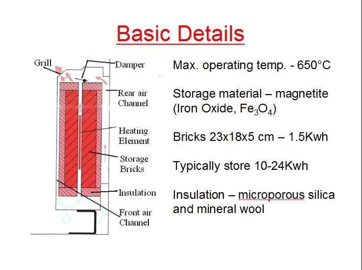

A_L Posted June 19, 2019 Posted June 19, 2019 26 minutes ago, zoothorn said: Ok if the customer were to unwittingly leave this dial/ flap open (or, it is unable to go into the closed position even if dial at min) over the duration of its night time 'charging up period'.. what state would you expect the heater to be in during this period? The flap should close automatically at the start of a charge period. If it did not you would simply be trying to fill a 'bucket with a hole in it'. The core would either never reach the temperature corresponding to the setting on the input control or it would take much more energy to do so and it would discharge continuously at a high rate. So the core would be cooler than expected at the end of the charge period.

ProDave Posted June 19, 2019 Posted June 19, 2019 14 minutes ago, A_L said: The flap should close automatically at the start of a charge period. If it did not you would simply be trying to fill a 'bucket with a hole in it'. The core would either never reach the temperature corresponding to the setting on the input control or it would take much more energy to do so and it would discharge continuously at a high rate. So the core would be cooler than expected at the end of the charge period. As I tried to explain, it is a local "heater" (a wire wound resistor) that heats up and closes a bimetalic strip to shut the flap during charging. If that resistor has goen open circuit then the flap may not close during charging.

zoothorn Posted June 19, 2019 Posted June 19, 2019 1 hour ago, A_L said: The flap should close automatically at the start of a charge period. If it did not you would simply be trying to fill a 'bucket with a hole in it'. The core would either never reach the temperature corresponding to the setting on the input control or it would take much more energy to do so and it would discharge continuously at a high rate. So the core would be cooler than expected at the end of the charge period. I think this is what's happening with my folks' heaters. A_L would a poor ammount of stored heat-release during the day period (heater barely warm) be the likely result of this incorrect night-time flap position, do you think?
ProDave Posted June 19, 2019 Posted June 19, 2019 19 minutes ago, zoothorn said: I think this is what's happening with my folks' heaters. A_L would a poor ammount of stored heat-release during the day period (heater barely warm) be the likely result of this incorrect night-time flap position, do you think? Or one or more of the heating elements has failed. There are up to 4 heating elements in a storage heater depending on it's size and if one has failed, that part of the core won't be heated. A competent electrician should be able to test them.
zoothorn Posted June 19, 2019 Posted June 19, 2019 24 minutes ago, ProDave said: Or one or more of the heating elements has failed. There are up to 4 heating elements in a storage heater depending on it's size and if one has failed, that part of the core won't be heated. A competent electrician should be able to test them. But the whole thing's barely warm during the day, & proper belting out heat at midnight tho..
PeterW Posted June 19, 2019 Posted June 19, 2019 Sounds like the flap isn’t closed when it’s heating and it starts at 11pm... so midnight is about right for heat out
ProDave Posted June 19, 2019 Posted June 19, 2019 If getting an electrician, tell hime to check the tiny heater (a wire wound resistor) that sits right under the bimetalic strip that operates the flap. Oh and make sure your folk are turning the boost knob all the way down before they go to bed. That should shut the flat even id the little heater is dead.
phatboy Posted June 19, 2019 Posted June 19, 2019 21 minutes ago, ProDave said: If getting an electrician, tell hime to check the tiny heater (a wire wound resistor) that sits right under the bimetalic strip that operates the flap. Do they all have this? On the old and very common Dimplex XL series I thought it was completely reliant on the user to close the flap? Also on the XLS series which was sold right up until LOT20 came in? Happy to be corrected.....
zoothorn Posted June 19, 2019 Posted June 19, 2019 Ah so the flap is operated both manually, & via the resistor-metalstrip ? is the thermostat then part of this circuit? Can you give me an overview of a storage heater system as a whole, say 5 rads. If there's a timed period at night when in the ''charging state" using the lower cost electricity (is this redcuced 'leccy rate even viable still in 2019?), & I cannot see on the rad a timer mech.. how are they controlled?

A_L Posted June 19, 2019 Posted June 19, 2019 1 hour ago, zoothorn said: Ah so the flap is operated both manually, & via the resistor-metalstrip ? is the thermostat then part of this circuit? Can you give me an overview of a storage heater system as a whole, say 5 rads. If there's a timed period at night when in the ''charging state" using the lower cost electricity (is this redcuced 'leccy rate even viable still in 2019?), & I cannot see on the rad a timer mech.. how are they controlled? The thermostat which operates the flap is the metal strip, it is purely mechanical, it does not switch electricity. There is no room thermostat on a storage radiator. If you turn the output control while looking through the upper air grill you should see the damper open/close (or hear it) Leave the damper in an open position and wait for the next off peak period to see if it closes automatically.(have the input control set to a small value). The storage rads are on a circuit which is only energised during an off-peak period, there will either be a electricity meter capable of controlling this or a on very old systems a separate time clock near the meter. The off-peak rate is more expensive w.r.t. to on-peak now than it used to be and I expect it to decline in advantage over time.
