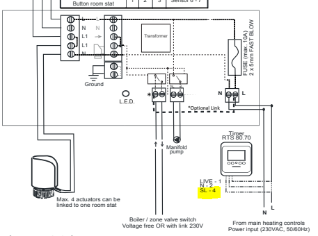

So I'll probably have 1 thermostat for each room and am using Wunda's wired touchscreen units W91.713:
From what I can work out, I will need to wire up each thermostat to the manifold's wiring centre (4, 3) and also power (2,1)from the consumer unit/fuse box, but preferably a nearby fused spur?
Image result for wunda w91.713
I have two rooms that will have a floor probe, so that gets wired into 7 and 6?

I have come into this thread part way through so excuse me if I have missed  something.
This is wet UFH isn't it?
Then that looks the wrong thermostat.  That has power into  1 and 2, and 3 and 4 connect to an electric UFH mat.
The thermostat for wet UFH just wants a volt free contact for the manifold controller.  You normally connect that to the UFH controller with a 3 core cable, it gets it's power from there, not direct from the consumer unit.

Both thermostat and wiring centre are from wunda so they must be compatible. From the instructions does 'SL' refer to switched L?
Yep - that’s the “dumb” wiring centre from Wunda.
Switched live - T4 - goes to the live on the board. The whole board goes live when the stat fires so it’s basically a way of controlling the boiler or pumps and the manifold actuators.

Ok, so L1, N1 use T3 and T4 o the thermostat back to the wiring centre. And the power (T2,T1) goes where - wiring centre also, or ?? Like I said, I am no electrician, but just need to know where to run the cables to/from! :S
3 hours ago, PeterW said:
How many zones  have you got..?
I will have 8 zones for the downstairs manifold with some rooms being covered by 1 zone.
As it shows, you need a 3 core and earth cable from each thermostat to the wiring centre.
L on wiring centre to thermostat terminal 1
N on wiring centre to thermostat terminal 2
L1 on wiring centre to thermostat terminal 4
No connection to the thermostat terminal 3
That is it. Repeat for each room stat.
The wiring centre is providing power to each thermostat and reading it's output.
