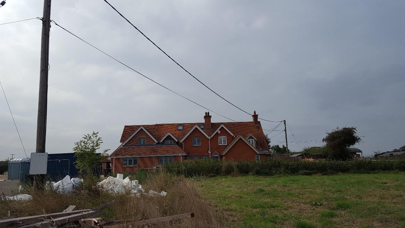

vivienz Posted September 4, 2018 Share Posted September 4, 2018 The electricity supply to my property currently comes in via an overhead line. The line originates from a pole on my neighbour's property and traverses my field/garden to another pole next to my property. Following exactly the same route is a long since redundant Openreach line which previously supplied my property and terminates there. There is no shared network from the pole on my property nor from the line between me and my neighbour. Openreach have said that because the line runs between 2 poles, it is a network and before they do anything a surveyor must come and look at it, for which there is a charge of £300. I have sent them photos and it's clear that the line goes nowhere else but they say they cannot rely on these. Do i have the right to simply tell them to get their kit off my land? There is no wayleave agreement in place for their equipment and i dont intend to use BT nor Openreach at the new house. More to the point, do I have to pay for them to remove their kit? Link to comment Share on other sites More sharing options...

vivienz Posted September 5, 2018 Author Share Posted September 5, 2018 I'm not sure if it's a problem or not, to be honest. The line that ran into the old bungalow is just wrapped around the pole that is close to where the old property was. The issue, I suspect, is that there's another line between the pole on my land and one on the neighbour's. These are both power line poles but both will need to be altered when I bury the electricity supply and I'm not sure how best to go about getting the Openreach equipment removed. I've emailed the following address: archive.ripple@openreach.co.uk These chaps are, apparently, pretty speedy with their replies so I should know shortly whether they have a wayleave or not. Once I have that, I'll do the usual recorded letter thingy to get Openreach to move their kit. If it helps, here's a photo of the line running between the pole on my land with the temporary supply cabinet and across to the pole on the neighbour's property. Link to comment Share on other sites More sharing options...
joe90 Posted September 5, 2018 Share Posted September 5, 2018 Frankly if you are removing the overhead power let the power company deal with openreach, I think if you tell them the tel line is redundant it will go with the poles. Link to comment Share on other sites More sharing options...
vivienz Posted September 5, 2018 Author Share Posted September 5, 2018 The power company have said that they won't remove the poles and that I need to contact Openreach to get them to remove their kit. Link to comment Share on other sites More sharing options...
Jeremy Harris Posted September 5, 2018 Share Posted September 5, 2018 It's the same situation we were in. The pole we wanted removed was an SSE pole but with an Openreach cable sharing it. Having got SSE to shift their cable (after months of delay) I struggled to get Openreach to move theirs. What's supposed to happen is that when SSE declare they are going to move a shared use pole, they are supposed to automatically send a request to Openreach (at Liverpool, IIRC) but in our case this didn't happen. Without the number of that request (I think it's called an ONR number) the local Openreach people can't shift their cable off the pole. The advice I had was to have all the new Openreach underground cables in place (they had been for weeks - we laid the ducts for them and pulled their cables through, leaving them coiled up at the base of the poles) and then, early one morning, "accidentally" snag the cable with the digger and immediately ring the Openreach hotline. We had an Openreach team there within about half an hour, they took one look at what had happened, saw the coils of cable waiting to be connected and said "This is a (name of local Openreach engineer) job, isn't it?" Worked a treat, though, except for annoying the lady up the road who had one of those emergency alarms, that started warning her that it wasn't connected, so she walked down the lane and laid into the Openreach guys until I calmed her down, saying it was just and accident and her line would be back up in a few minutes. Link to comment Share on other sites More sharing options...
vivienz Posted September 5, 2018 Author Share Posted September 5, 2018 It shouldn't be a big deal at all for Openreach as I don't plan on having a connection with them anyway, I'm going to have a Vonage phone connection via Wessex Internet along with the broadband connection. The Openreach kit is truly redundant. Link to comment Share on other sites More sharing options...
Russdl Posted March 30, 2019 Share Posted March 30, 2019 Help. I've got on Openreach 'flying wire' that looks like it's going to be very close to the new build. (@vivienz What did happen in the end with your Openreach cable?) We have a 'flying wire' that crosses a corner of our plot, to poles that are outside of the plot, and I reckon it's going to be very close to our new build so basically in the way, especially of scaffolding. I understand Openreach can 'fly wires' over property without Wayleaves providing it doesn't interfere with the 'normal business of the property'. I presume redeveloping the site is 'normal business'. Does anyone know where I stand with this? Link to comment Share on other sites More sharing options...
Jeremy Harris Posted March 30, 2019 Share Posted March 30, 2019 We had a real problem getting OpenReach to move a wire that was running over our plot. Getting them to agree that we could put it underground in Duct 56 that they free-issued was relatively easy, but actually getting them to take down the overhead wire and connect up the new underground one was a PITA. In the end we used subterfuge (at the suggestion of a local OpenReach employee) where we "accidentally" took the wire down early one morning, with the aid of the digger jib, then phoned their emergency number to report the wire was down. They sent two chaps out straight away, and when they arrived on site we just pointed them to the new cable neatly coiled up at the base of each pole, they grinned, mentioned the name of the local OpenReach chap and then set about just connecting up the new cable. The whole job was done in about 30 minutes or so. I don't know if the local chap I knew is still working for them, or whether he's retired, but as you're in the same area I could PM you the phone number I had for him back then. He was really helpful, unlike his management... Link to comment Share on other sites More sharing options...

Jeremy Harris Posted March 30, 2019 Share Posted March 30, 2019 Just now, Russdl said: That's surprising. It surprised me, but as one of our ground works chaps said at the time (when we were all moaning about the crap service from OpenReach) you get the service you pay for... In our case the wire over the top of the plot was connected to an SSE power pole that had been replaced in a new location by SSE, leaving just the 'phone wire on it. Apparently OpenReach are obliged to move over-sailing wires free of charge if they are causing an obstruction, as this wire was. Link to comment Share on other sites More sharing options...
Russdl Posted March 30, 2019 Share Posted March 30, 2019 12 minutes ago, JSHarris said: Apparently OpenReach are obliged to move over-sailing wires free of charge if they are causing an obstruction, as this wire was. That's the little gem I need to confirm. ~~~ The Openreach wire affecting us comes from a telegraph pole and goes to an SSE pole and then on to the last house in the lane. I'm pretty sure scaffolding will be all around it if it stays put. Why has it taken me so long to realise this?? Link to comment Share on other sites More sharing options...
