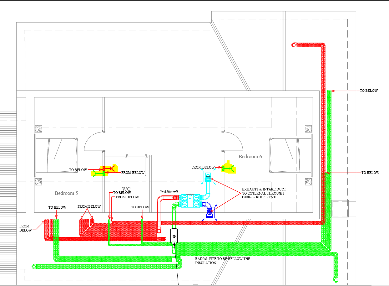

ultramods Posted August 31, 2018 Posted August 31, 2018 Seeing this topic I decided to look at the proposed MVHR plans for our house, can anyone tell me what the three items that I have highlighted are please? The plan shows the attic space, it will be a cold roof with the possibility to be converted into living space in the future.
le-cerveau Posted August 31, 2018 Posted August 31, 2018 Would need to see the other floor plan, but suspect that ducts go down along and then back up to wall vents.
Triassic Posted August 31, 2018 Posted August 31, 2018 You need to look at the layout for the floor below.

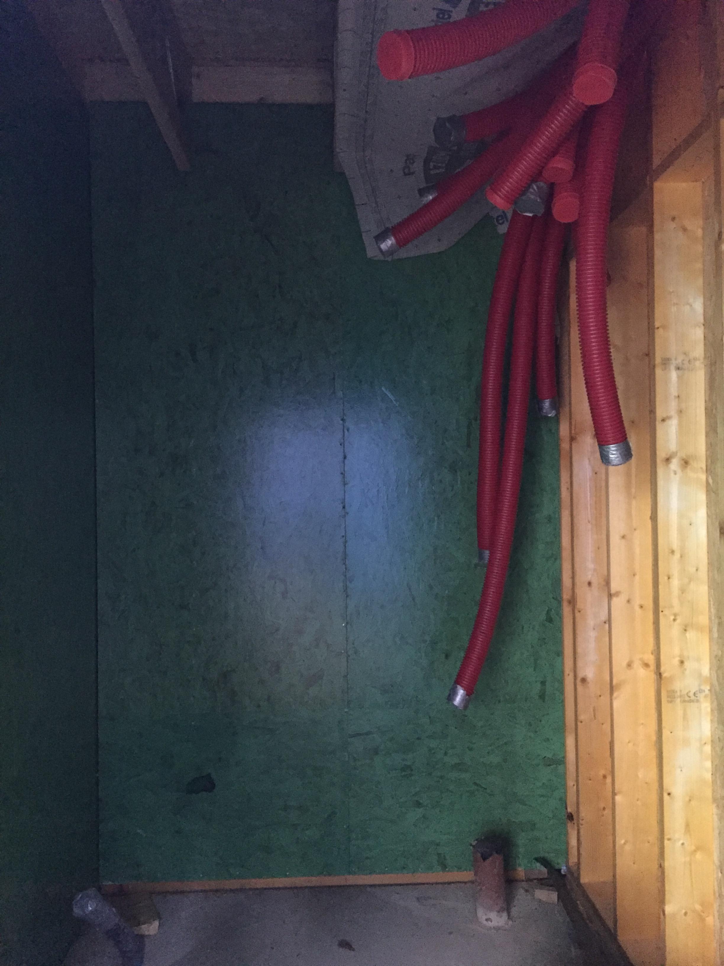

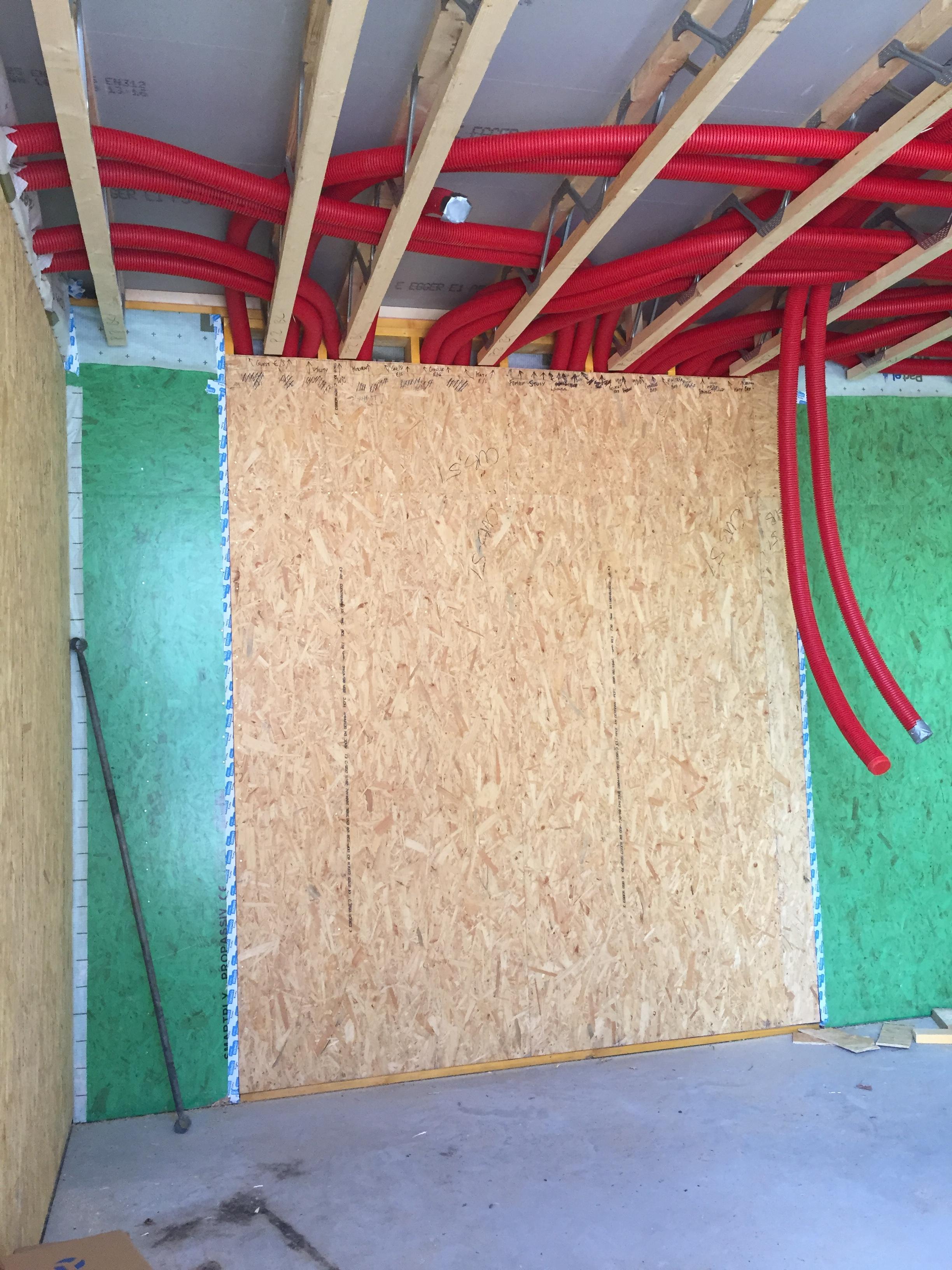

Weebles Posted September 15, 2018 Author Posted September 15, 2018 Radical duct mostly in now. Two or three pairs of hands worked well. So now the unit / manifold connections. We have worked out how it all fits together. Bends, couplings, silencer, flexible duct. Our unit needs to be in our plant room which single storey and is inside the thermal envelope. Should we fix the unit to the wall (it would be an outside wall) or mount it on a platform? The plan is to sit it high so the exhaust supply vents are as far off the ground as possible on the rear wall with vents out on the left hand wall as you look at it. Good idea or not an issue? First image shows duct runs going through to the plant room. Second image is the plant room.
Stones Posted September 15, 2018 Posted September 15, 2018 I would say mount it so you can easily work on it - i.e. unscrew the front, remove filters, remove core, clean inside of unit, whilst standing up. I had originally planned this for mine but ended up installing it in loftspace where it sits on the floor. TBH it's a bit of a pain to work on like that, so I may well end up putting it in the services cupboard although I'd have to muster the enthusiasm to do so first!

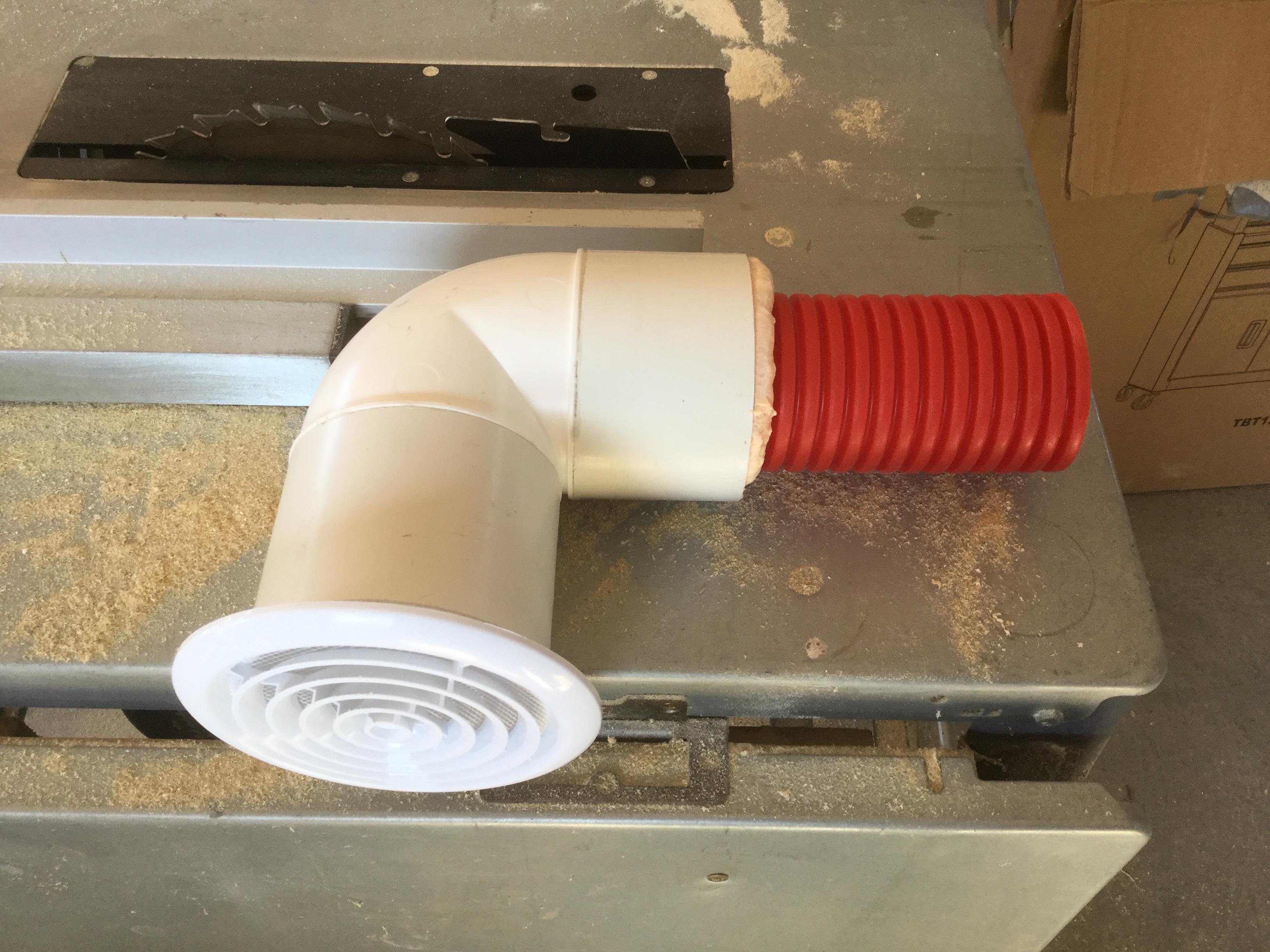

joe90 Posted September 15, 2018 Posted September 15, 2018 I made my own plenums from cheap bits, mounted them flexibly within the ceiling space, measured the centres from walls and wrote it down on the plans, plastered over and cut the ceiling after plastering, worked brilliantly, I even painted the ceiling before cutting the holes.

Weebles Posted September 15, 2018 Author Posted September 15, 2018 On 15/09/2018 at 10:48, Stones said: I would say mount it so you can easily work on it - i.e. unscrew the front, remove filters, remove core, clean inside of unit, whilst standing up. I had originally planned this for mine but ended up installing it in loftspace where it sits on the floor. TBH it's a bit of a pain to work on like that, so I may well end up putting it in the services cupboard although I'd have to muster the enthusiasm to do so first! Expand Thanks. We will look at running the ducts out of the top rather than the side to lower the unit. Otherwise it will be a stepladder to do anything and not sure I’d ever find enthusiasm to move it!
