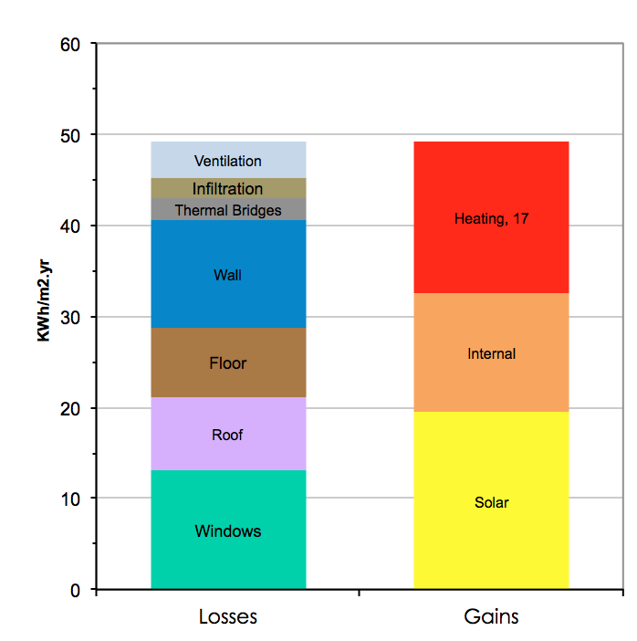

pdf27 Posted August 25, 2018 Share Posted August 25, 2018 6 hours ago, NSS said: Projected total imported electricity cost for first 12 months (we have no gas) - £790 Projected FiT payments - £280 RHI payments - £444 Net energy cost - £66 165m2 = 40p/m2a Exclude the RHI and that rises to £3.09/m2a It's a rather different calculation from that I originally proposed, but provides a very stark comparison to our previous home where the same calculation would have given a figure of £9.79/m2a Maybe not the best comparison - excluding subsidies (FIT and RHI), you're at £4.78/m2a: all the work you've put into the fabric is only worth as much as the government subsidy for some of the additional technology you're using. Link to comment Share on other sites More sharing options...
Cpd Posted August 25, 2018 Share Posted August 25, 2018 11 hours ago, Onoff said: Nom: Oil 2K Leccy 1K Poll Tax 2.5K Well it’s going to get worse before it gets better but...... Electric £2500 Council Tax band C £1,110 Gas £120 No Water or sewage Virtually no insulation and living in a south westerly wind funnel between two hills...... This is a barbaric house and one day I will strip it back to bare walls and rebuild but for the moment it’s home. 5.5mx11.5m 1.5 storey So 63.25m2 2 children and 3 adults min. £59.44per m2 ....... dooomed Thank god I don’t have any debts / mortgage. Link to comment Share on other sites More sharing options...
NSS Posted August 25, 2018 Author Share Posted August 25, 2018 1 hour ago, pdf27 said: Maybe not the best comparison - excluding subsidies (FIT and RHI), you're at £4.78/m2a: all the work you've put into the fabric is only worth as much as the government subsidy for some of the additional technology you're using. Should perhaps have mentioned that we'd spent a pile on the old place improving the insulation, glazing and installing a high efficiency boiler and LED lighting. And it's not all about cost. Comfort has to come into it too. Link to comment Share on other sites More sharing options...
pdf27 Posted August 25, 2018 Share Posted August 25, 2018 9 minutes ago, NSS said: And it's not all about cost. Comfort has to come into it too. That's one of the places where just providing bills falls down - humans have a strong tendency to take improved efficiency as comfort, rather than cost savings. If the sort of thermal comfort acceptable in the 1950s were applied to a Passivhaus, they really wouldn't need any heating system at all. 1 Link to comment Share on other sites More sharing options...
ProDave Posted August 25, 2018 Share Posted August 25, 2018 Interesting. Our electricity for the last 12 months has cost £800, Mostly that has been in the caravan and not much of that has been heating (WBS) nor cooking (LPG). We clearly use too much "stuff" as that is mostly just washing, tumble drying fridge, freezer, tv's, computers etc etc. So if we assume in the house now we use the same "stuff" that's £5.70 per square metre of house, even before we add water and space heating (now ASHP) and an electric oven. I get the impression, space and water heating might cost less than all the other "stuff" we use. Solar PV will bring that down (but there won't be any FIT) when we eventually add it. Link to comment Share on other sites More sharing options...
Jeremy Harris Posted August 25, 2018 Share Posted August 25, 2018 I think it's reasonable to not include the FIT, and definitely right and proper to exclude RHI, but when doing this sort of calculation I think we do need to include any export payment, as that is energy going back to the grid for others to use. If I re-jig our costs to ignore the FIT payment, but include the export payment, then the figures are (including VAT): Council Tax = £2081.32 Imported electricity cost p.a. (inc. standing charge) = £436.69 (includes some winter electric car charging) Imported electricity energy p.a. = 2,445 kWh Exported electricity energy (deemed 50% of generation) = 2,493 kWh Exported electricity payment = -£130.63 (2,493 kWh * £0.0524) Net cost of imported electricity = £306.06 Water and sewerage = £0.00 Gas = £0.00 Floor area = 130m² Total grid energy consumption per m²/p.a (including partial car energy, excluding exported energy) = 18.81 kWh/m²/p.a. Total house (and partial car energy) energy running cost per m² (allowing for exported energy payment) = £2.35/m²/p.a. Total house running cost per m² including Council Tax = £8.05/m²/p.a Council tax makes up about 71% of our total house running cost, excluding the FIT payment. I can separate out the heating energy element from this reasonably well, as I have an energy meter on the ASHP supply, so I know that we use a bit under 12 kWh/m²/p.a. for space heating, but a small part of that will come from self-generation, so it's impossible to work out how much grid energy we use for space heating, or how much grid energy we use for everything else, including a bit of car charging. Worth noting that at least 80% of the hot water comes from energy we self-generate, plus quite a lot of the other house energy use comes from self-generated energy as well. Our energy use is heavily skewed towards the winter, with the summer bill being dominated by the standing charge. Link to comment Share on other sites More sharing options...
