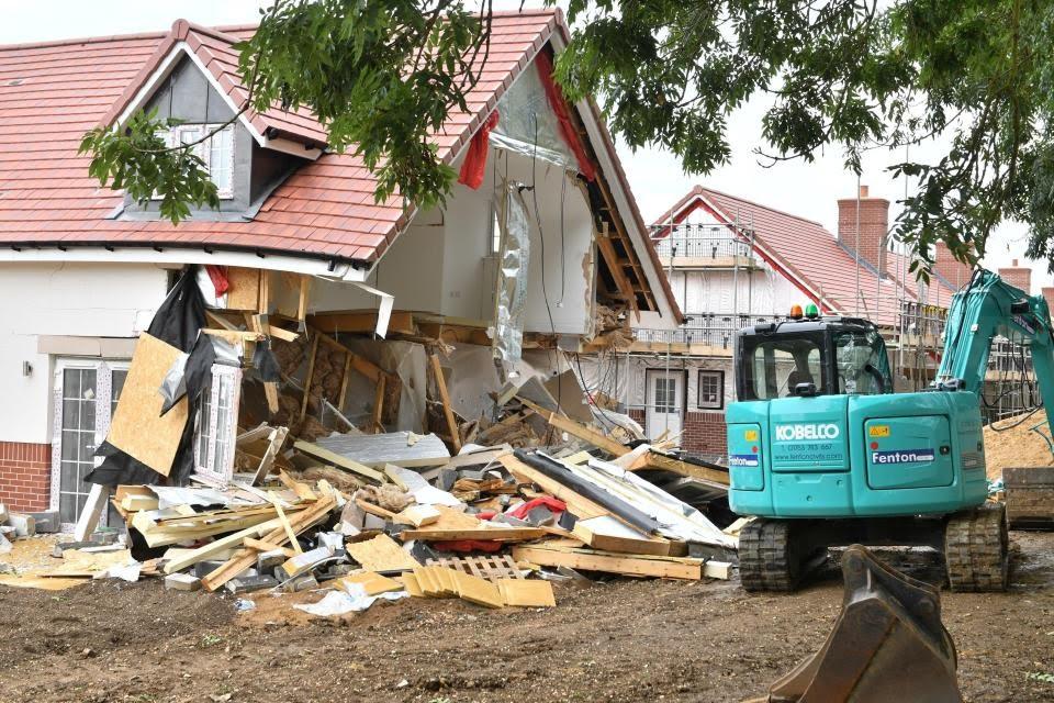

newhome Posted August 16, 2018 Share Posted August 16, 2018 The way developers get around getting poorly built houses to pass the current tests I doubt it would make a huge difference. These look like balsa wood. Link to comment Share on other sites More sharing options...
ProDave Posted August 16, 2018 Share Posted August 16, 2018 ^^ I am impressed the upstairs plasterboard is largely intact, even though all traces of any frame it might have been attached to has long since gone. Link to comment Share on other sites More sharing options...
