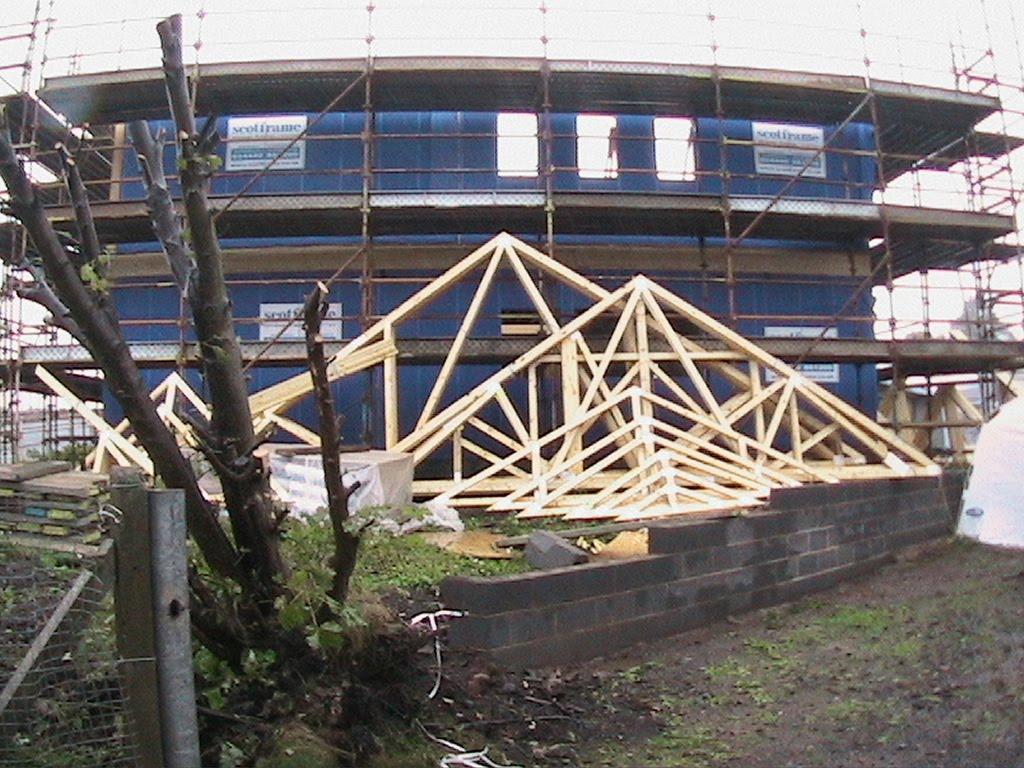

Jeremy Harris Posted August 15, 2018 Share Posted August 15, 2018 Just as a guide, this photo was taken at about 08:30 on day one of our build, as the timber frame arrived on the truck: This photo was taken on the same day at around 16:30: After three blokes, plus a crane a driver, working flat out for around 8 hours the whole ground floor frame was up, almost all the internal stud walls were up and they were getting ready to start putting in the first floor joists. Link to comment Share on other sites More sharing options...

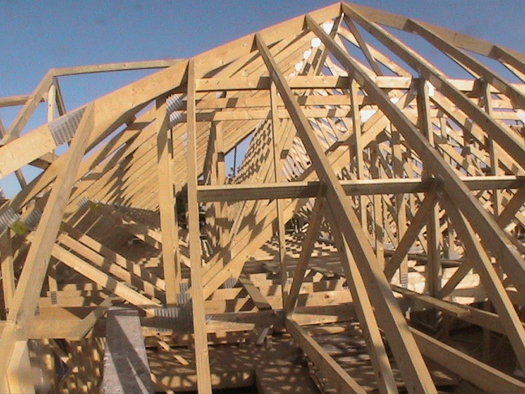

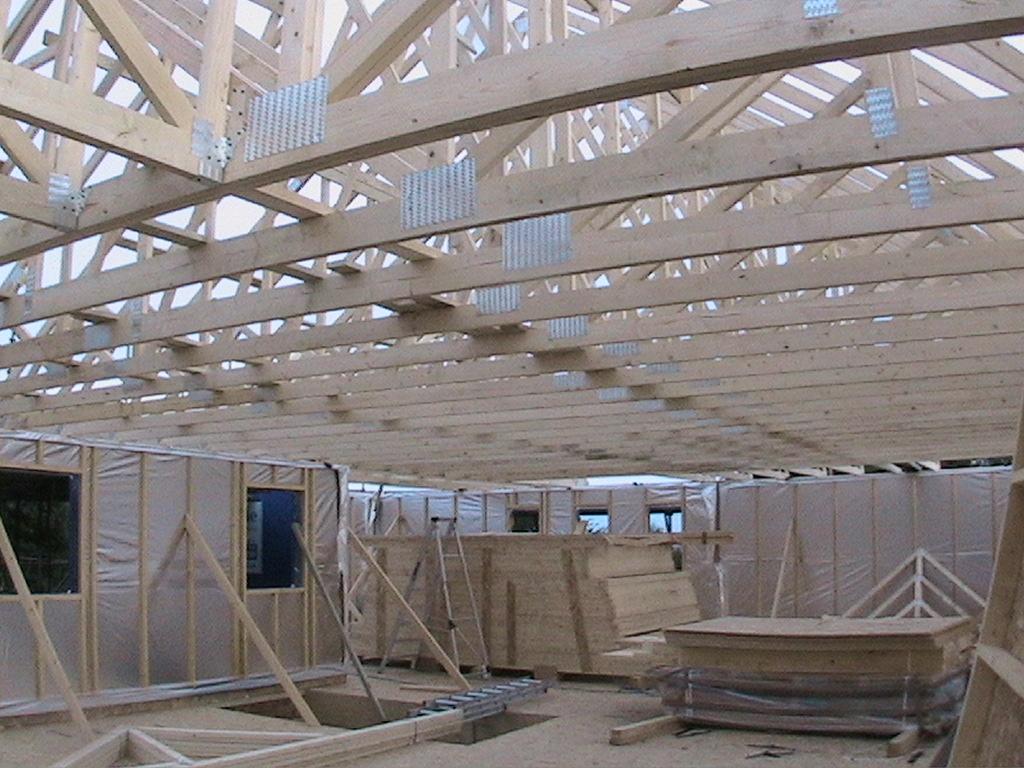

newhome Posted August 15, 2018 Share Posted August 15, 2018 Welcome! It will depend on the kit TBH as to how much needs to be done on site but mine was a timber frame closed panel system for a 2 storey 350 m2 house and this was the timeline: 3 joiners (and 1 crane driver for 3 of the days). After the trusses were complete we went down to 2 joiners. It was a fixed price job. Day 1 - ground floor panels complete. Day 2 and 3 - internal ground floor frame completed, and first floor joists Day 4 - first floor panels erected Days 5 - 8 - roof trusses (it is a fairly large and complicated roof so it took some time). Days 9 and 10 sarking (we went down to 2 joiners then) Day 11 internal first floor panels completed. Windows were fitted a bit later due to a delay at the manufacturing end but as you can see it was all up fairly quickly. I would estimate circa 34 working days plus 3 days for the crane driver. The timber frame company paid for the third day crane hire as the trusses didn’t turn up on time so that caused a small delay but they got on with the internal walls instead. Link to comment Share on other sites More sharing options...
