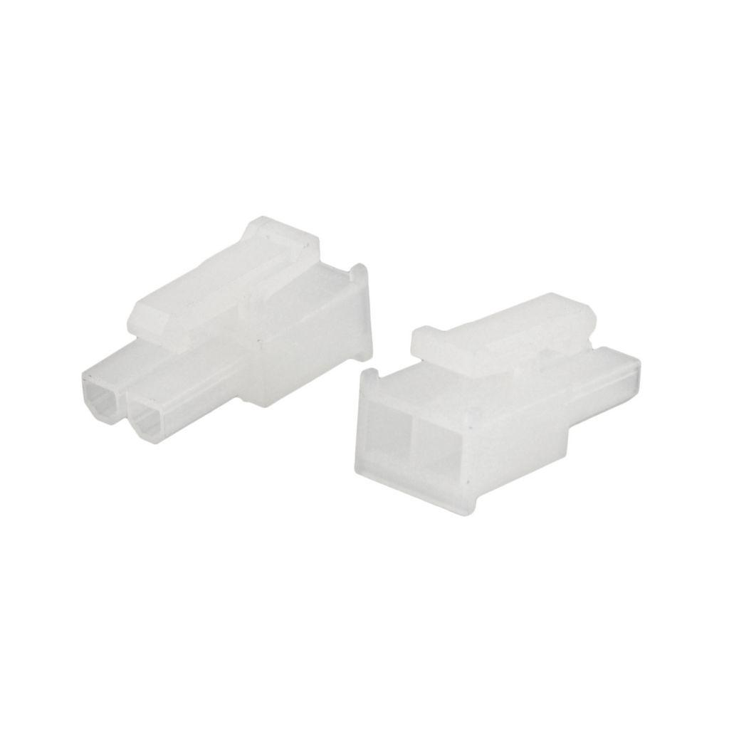

Radian Posted July 20, 2022 Share Posted July 20, 2022 FFS. A penny resistor in what looks like a Molex Mini Fit plug Someone's gotta know the resistor value? Or stick a 100k Pot on it and turn it until something shows up someplace? 1 Link to comment Share on other sites More sharing options...
Radian Posted July 20, 2022 Share Posted July 20, 2022 Correction: Picture of vaillant-0020269259 shows the catch on the side: So connector is Mini-Fit Jr. 5557 26pence + crimps 1 Link to comment Share on other sites More sharing options...

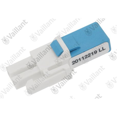

Dan F Posted July 20, 2022 Share Posted July 20, 2022 (edited) 1 hour ago, Dreadnaught said: Hey @Dan F, you could get your multimeter out and test the resistance of your one for us. You could sell the information to each of us for £250 a head and we'd all still make a profit after we've spent less than a £1 on materials 😄 I've got it out of ASHP, but unluckily my multimeter battery is dead and don't have any spare PP3 batteries at home. 😞 It looks like this, with same code on the side. If you dig around on the internet it looks like Vaillant may sell this under different part numbers at different prices (cheeky if true). As searching for "20112219" brings up a different part number: 0020266328. This part is is a blue coding plug which looks like it may be available for £5! Edited July 20, 2022 by Dan F Link to comment Share on other sites More sharing options...
Dreadnaught Posted July 20, 2022 Share Posted July 20, 2022 8 minutes ago, Dan F said: It looks like this, with same code on the side. If you dig around on the internet it looks like Vaillant may sell this under different part numbers at different prices (cheeky if true). As searching for "20112219" brings up a different part number: 0020266328. This part is is a blue coding plug which looks like it may be available for £5! Yes, I see what you mean. Perhaps they are the same item, and with that part number it is for Vaillant's gas boilers. Or perhaps they used the wrong stock photo on the internet page. At just £5 it could certainly be worth a try! Link to comment Share on other sites More sharing options...

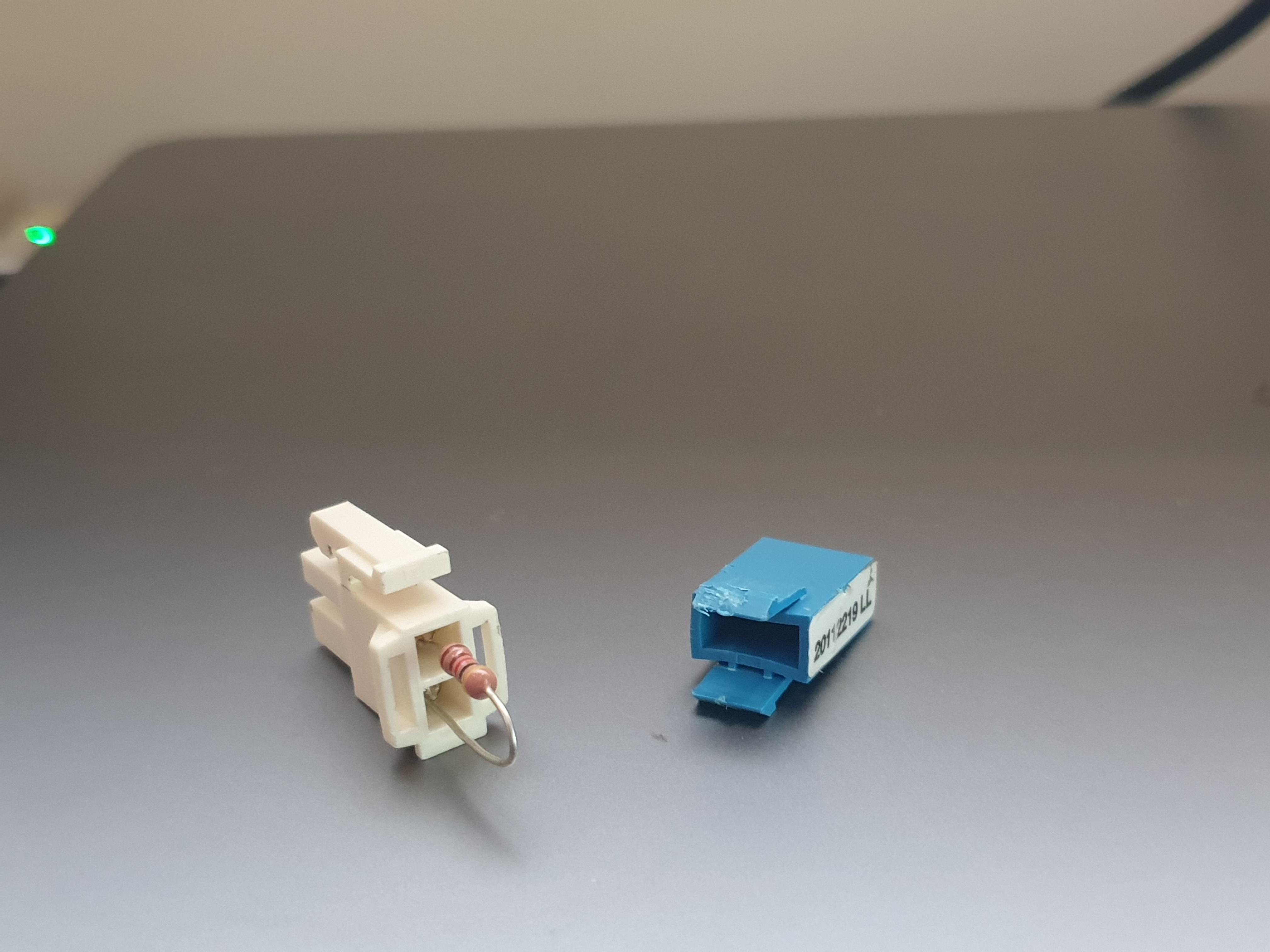

ProDave Posted July 20, 2022 Share Posted July 20, 2022 Is someone going to unclip the blue cover on this "dongle" and post a picture of what is inside? the suspense is killing me. 1 Link to comment Share on other sites More sharing options...
Dan F Posted July 20, 2022 Share Posted July 20, 2022 1 1 4 Link to comment Share on other sites More sharing options...
ProDave Posted July 20, 2022 Share Posted July 20, 2022 2 minutes ago, Dan F said: FFS if they charge more than £2 for that it is criminal. This needs naming and shaming. 1 Link to comment Share on other sites More sharing options...

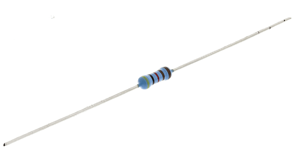

Radian Posted July 20, 2022 Share Posted July 20, 2022 (edited) Looks like 4-bands in which case: brown (1), brown (1), red multiplier (2), black tolerance = 1100 Ohms but black as tolerance is not right? If it was grey it'd be a ridiculous 0.05% The Other way round makes no sense either. Have I forgotten how to read old-school resistors? 😕 Edited July 20, 2022 by Radian Link to comment Share on other sites More sharing options...
ProDave Posted July 20, 2022 Share Posted July 20, 2022 I made it brown, brown, red, black, gold, = 112 ohm 5% https://www.digikey.co.uk/en/resources/conversion-calculators/conversion-calculator-resistor-color-code It seems a very odd value? Can we have a macro shot of just the resistor please square on to see the colour bands better? Link to comment Share on other sites More sharing options...
Dan F Posted July 20, 2022 Share Posted July 20, 2022 (edited) 19 minutes ago, ProDave said: I made it brown, brown, red, black, gold, = 112 ohm 5% https://www.digikey.co.uk/en/resources/conversion-calculators/conversion-calculator-resistor-color-code It seems a very odd value? Can we have a macro shot of just the resistor please square on to see the colour bands better? I was deliberately hiding the band somewhat so noone beat me to it selling DIY versions on ebay 😉 Nah. I read it as yellow-black-red-brown-brown. i.e. 4.02kΩ ±1%. Edited July 20, 2022 by Dan F 1 Link to comment Share on other sites More sharing options...
