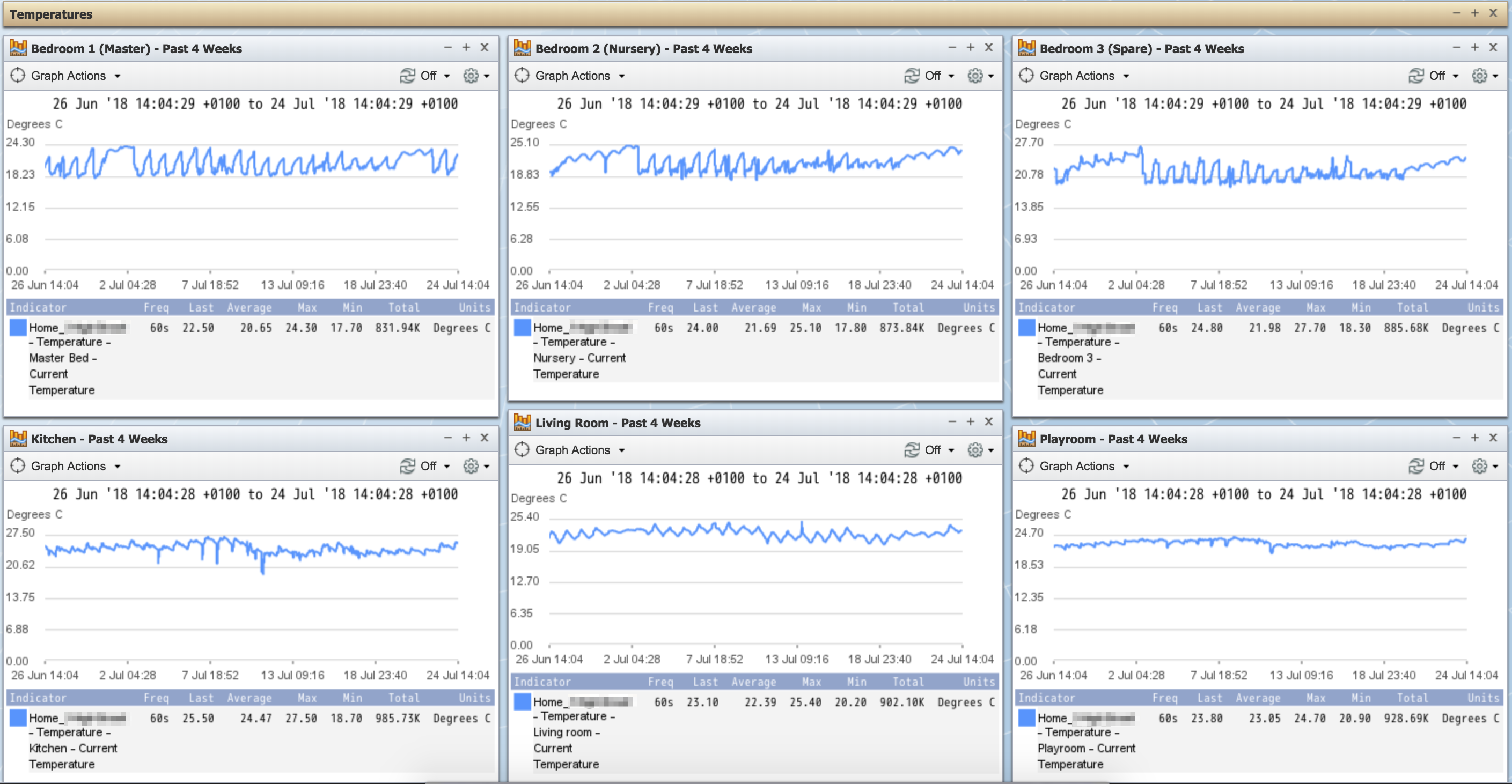

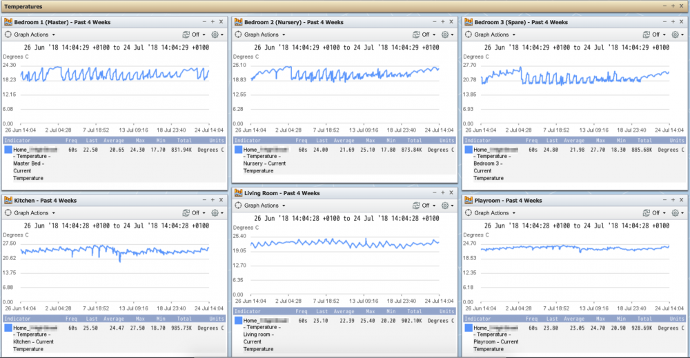

MrMagic Posted July 24, 2018 Posted July 24, 2018 Scorchio! The bedrooms have A/C, hence the 'sawtooth' graphs. The downstairs rooms are reasonably stable - the kitchen is suffering from overheating tho, keeping the blinds closed down over the bi-folds helps to keep it down a bit. Living next to a busy road during the day somewhat limits the purging options, plus we're in a kind of a dip so the through air flow is hard to achieve.
