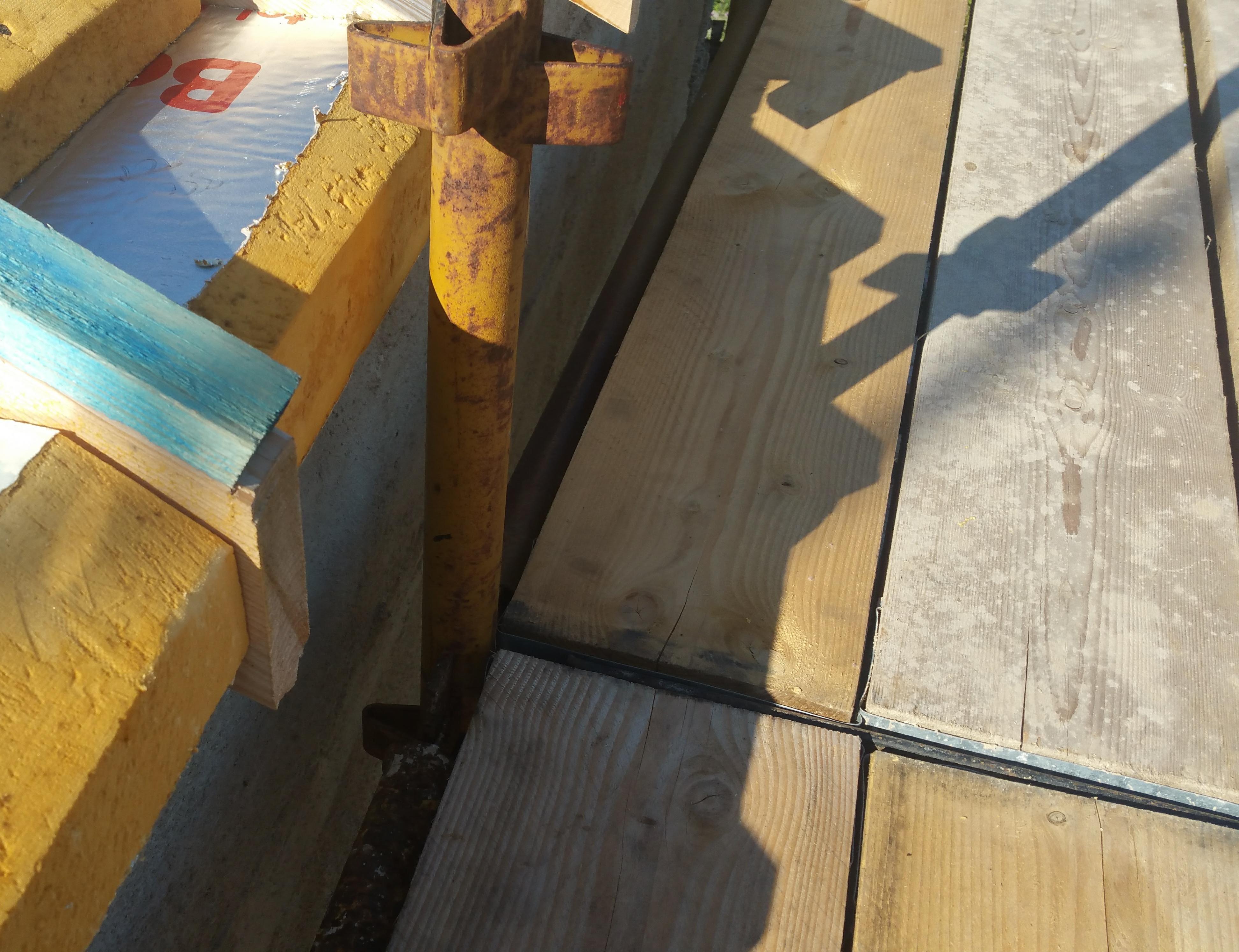

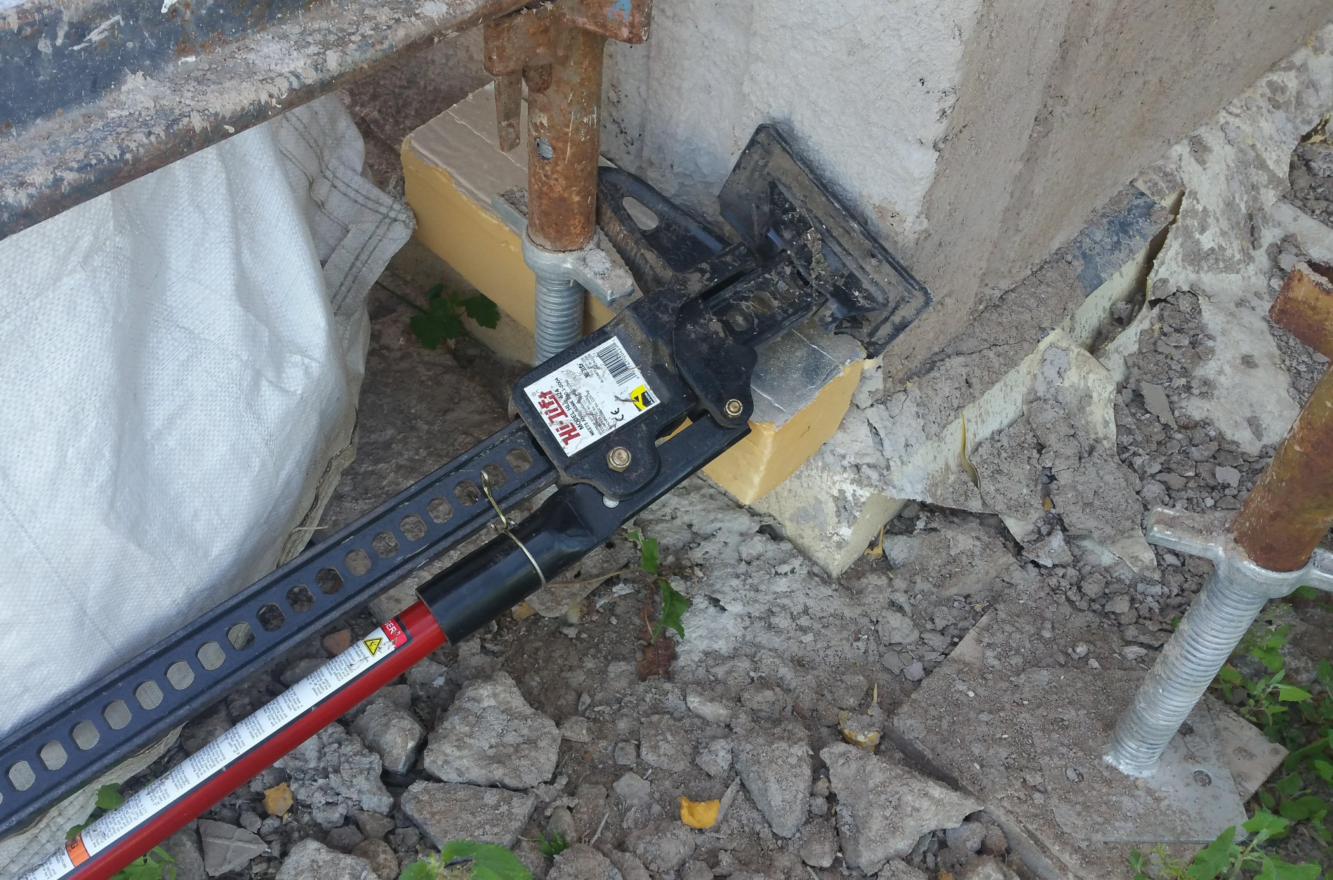

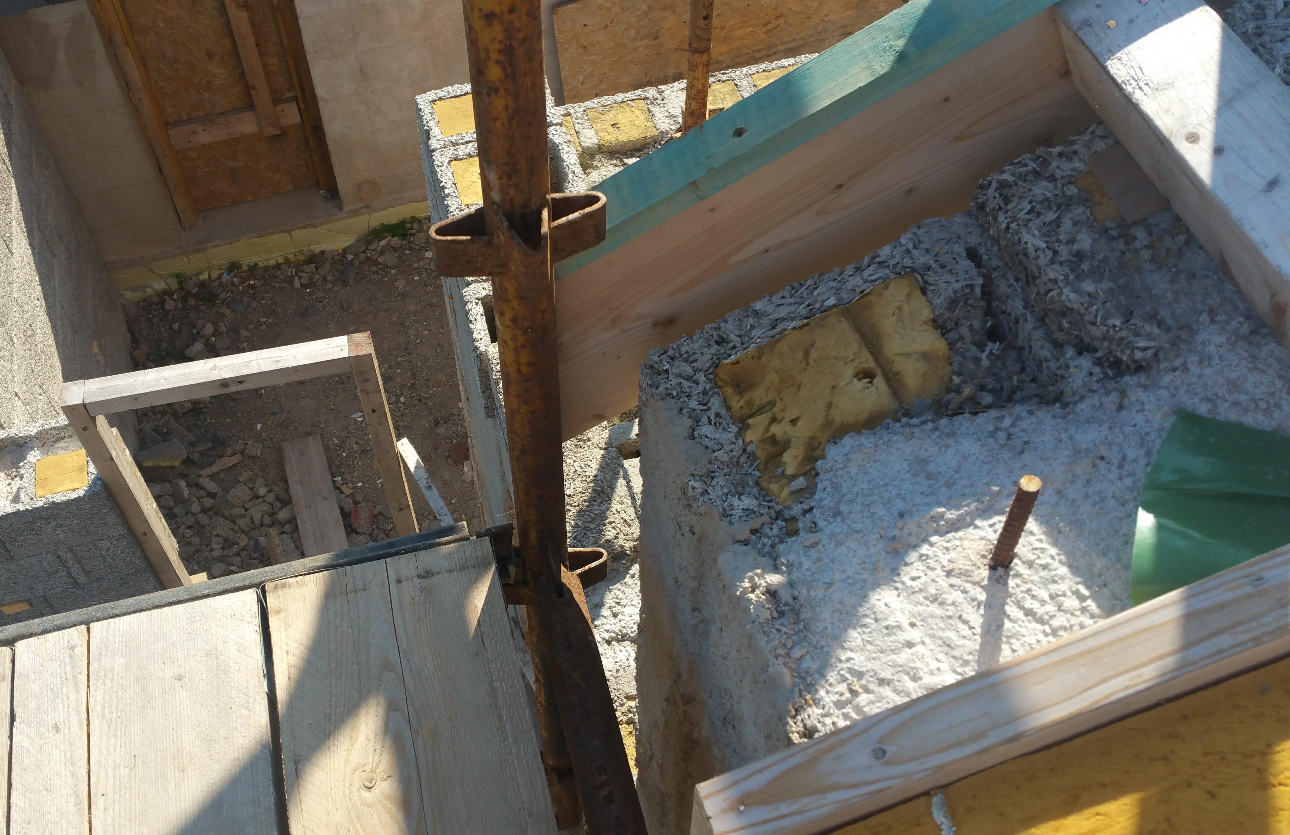

ToughButterCup Posted July 8, 2018 Author Posted July 8, 2018 Here's the problem ..... and I checked earlier: I have 7 points where the scaffolding is attached to the building. Once I have loosened (but not detached) those, I'll hit the problem with my farm jack. Don't use it often, but when you need one, you need one.... Aldi first, though.... (wonder what they have in the Big Boys Toys alley?)
PeterW Posted July 8, 2018 Posted July 8, 2018 Farm Jack is the perfect solution to this - slow and steady.
