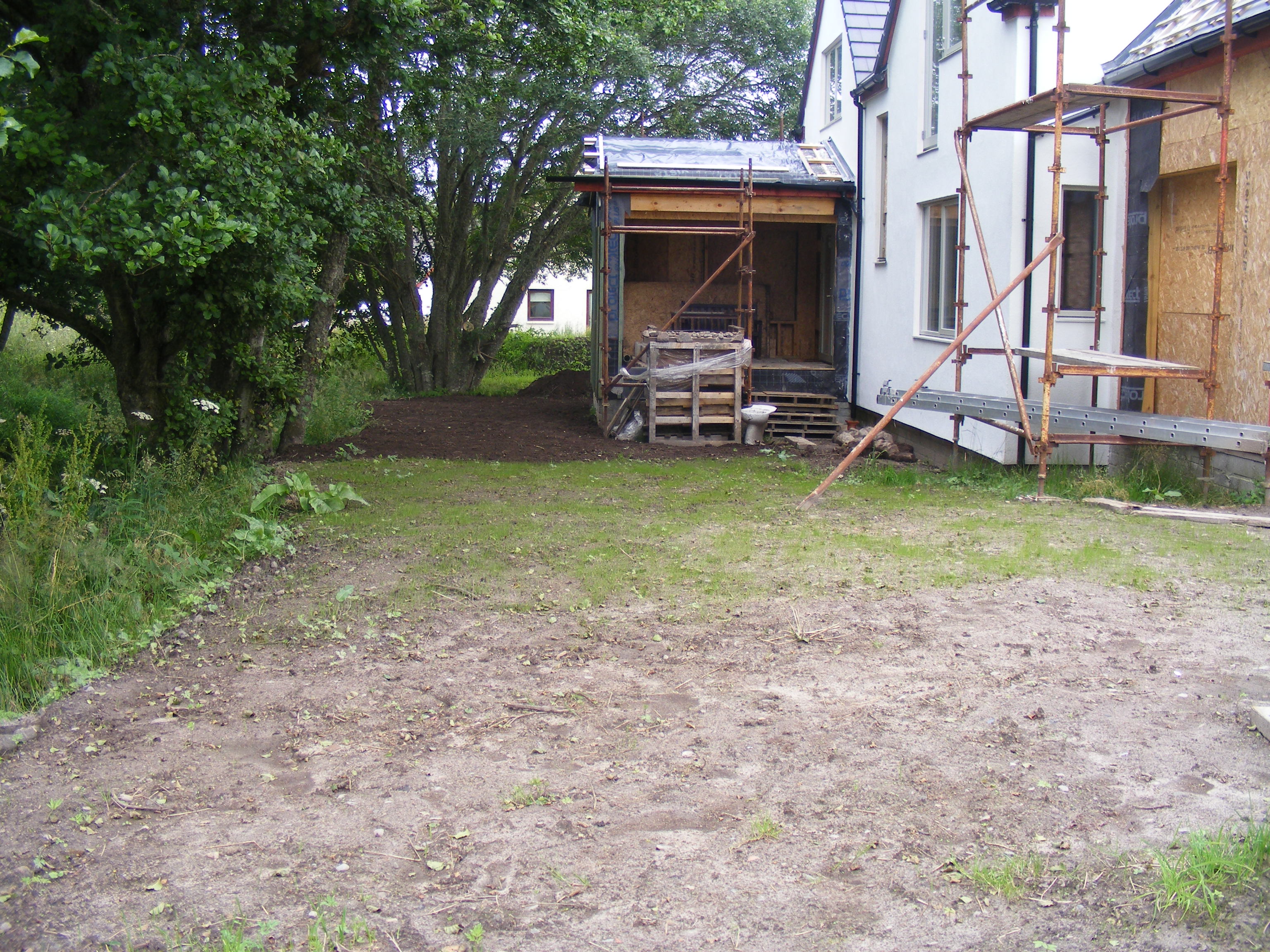

ProDave Posted July 27, 2016 Share Posted July 27, 2016 Here's my first efforts on this build. I am trying the easy approach this time. Ground flattened and compacted with the digger, then just raked over to remove the last of the stones and get it a little flatter. Then grass seed sown. The bit in the foreground was seeded 3 weeks ago, but with old seed that was in the shed for who knows how many years. It is just starting to grow now (or is that the weeds) The bit in the middle was seeded about 2 weeks ago with new seed. The bit in the distance next to the sun room was only flattened today and has not been seeded. I regard this as "stage 1" landscaping. I know it's not going to be a perfect lawn from this. Some bits will settle more than others, particularly where drain trenches have been dug and filled in, and will need topping up and leveling again later on. But at this stage it establishes the rough ground levels and by seeding it and then starting to mow it, it shouldn't be such a mess of weeds than if I just left it without doing anything. Regarding watering. If it rains it gets watered, if not........ Link to comment Share on other sites More sharing options...
