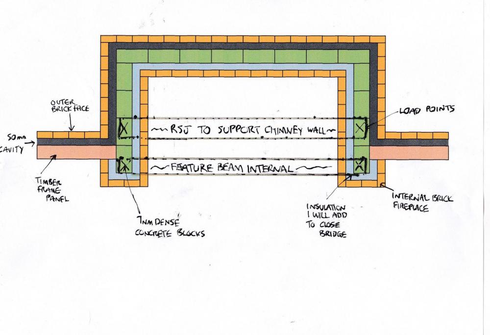

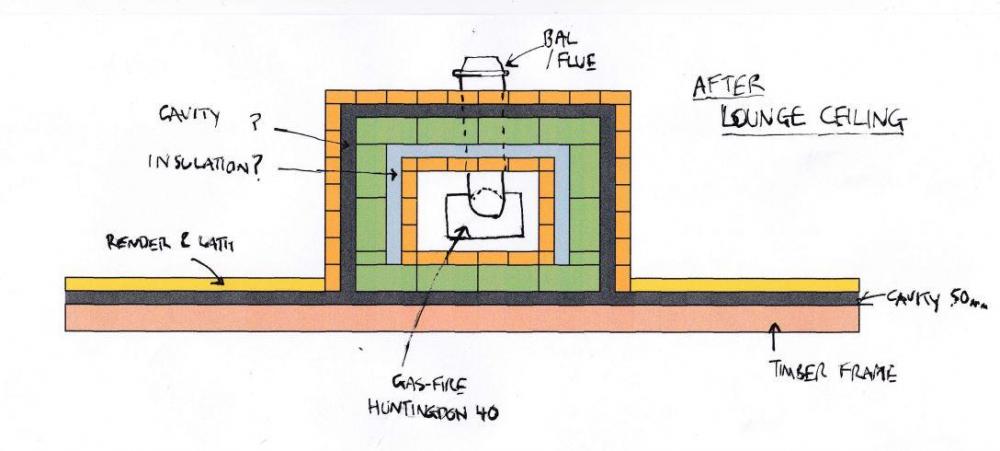

I agree Peter!...I know we have been talking in message about this ....but I finally see what you mean.
For others
....it is a TF Frame with a 50mm Cavity Faced off in Brick
....The lower 9-11 courses have a "plinth" and under that it is "Brick and Brick on Edge" to get extra width for plinth stand-off
...no problems wit the plinth me thinks ...
Now I can draw this Chimney area easily and it has the same structure as the wall too ...plinth, face and even put in the 50mm cavity
Of course this cavity will now be between Brick (Outer Skin) and Concrete Common ..but it will still go all around ...good ?
The issue here is the where the chimney abuts (is that a word) the building...
For strength I was thinking that the planned RSJ/Lintel  (which would carry the weight of the chimney wall up the building) would need to be
fixed SOLIDLY to the TF itself,  ...via copious L Arcon Ties ?
This would of course KILL the cavity above the lintel effectively
i.e.  Inner chimney course upward from there...would have no cavity ...basically in the below image it is the area that shows
the fixing points.
Oh ...and the Rendered area ....which will be done later on ...does have a "stand off" on renderboard from the TF ...not sure now much. but of course it would be
"beaded" where it is to meet the chimney..I presume
I mean it is drummed into us ...Cavity, Cavity ...CAVITY !!
But in a case like this ..is there any alternative for this area where we could ADD ..something, a barrier or something ...and kill the cavity ?
I mean the chimney itself ...Tall Run is NOT humongous...externally it could be as narrow as we wanted .....but as the wife wanted a twin pot
(God knows why ..its only a gas fire) ..,it will probably end up with external dimensions of 1000 x 450 ..so slightly FATTER as you look from side elevation

Right....
minimum depth from the TF is going to be 600mm from the front of the chimney as you need 250mm for the liner, 200mm for the bricks and 100mm for the vermiculite all round (50mm each side) and then your 50mm TF cavity.
Good news is 550mm for the chimney works bricks so thats an easy one. If you really want 2 pots then one is a blank; chimney will need to be 1050 wide to cope with the liner and the pot at the top.  That’s a big chimney ..!!
cavity will need trays and some clever detailing to close the cavity to drafts
Other issues include getting some insulation between the brick skins ...

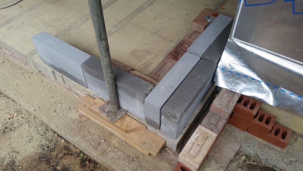

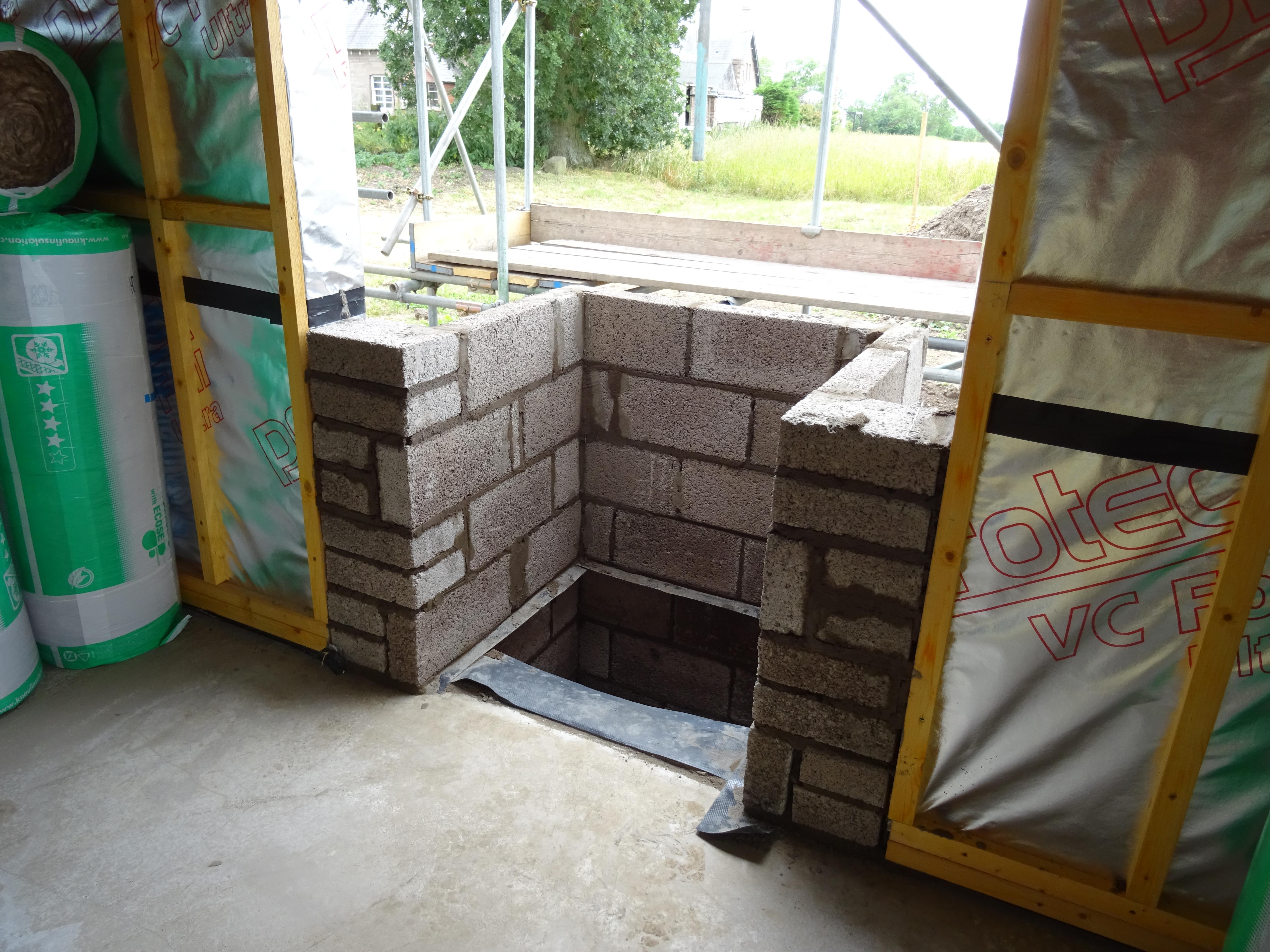

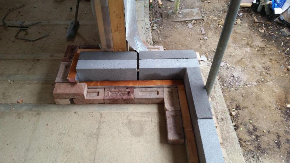

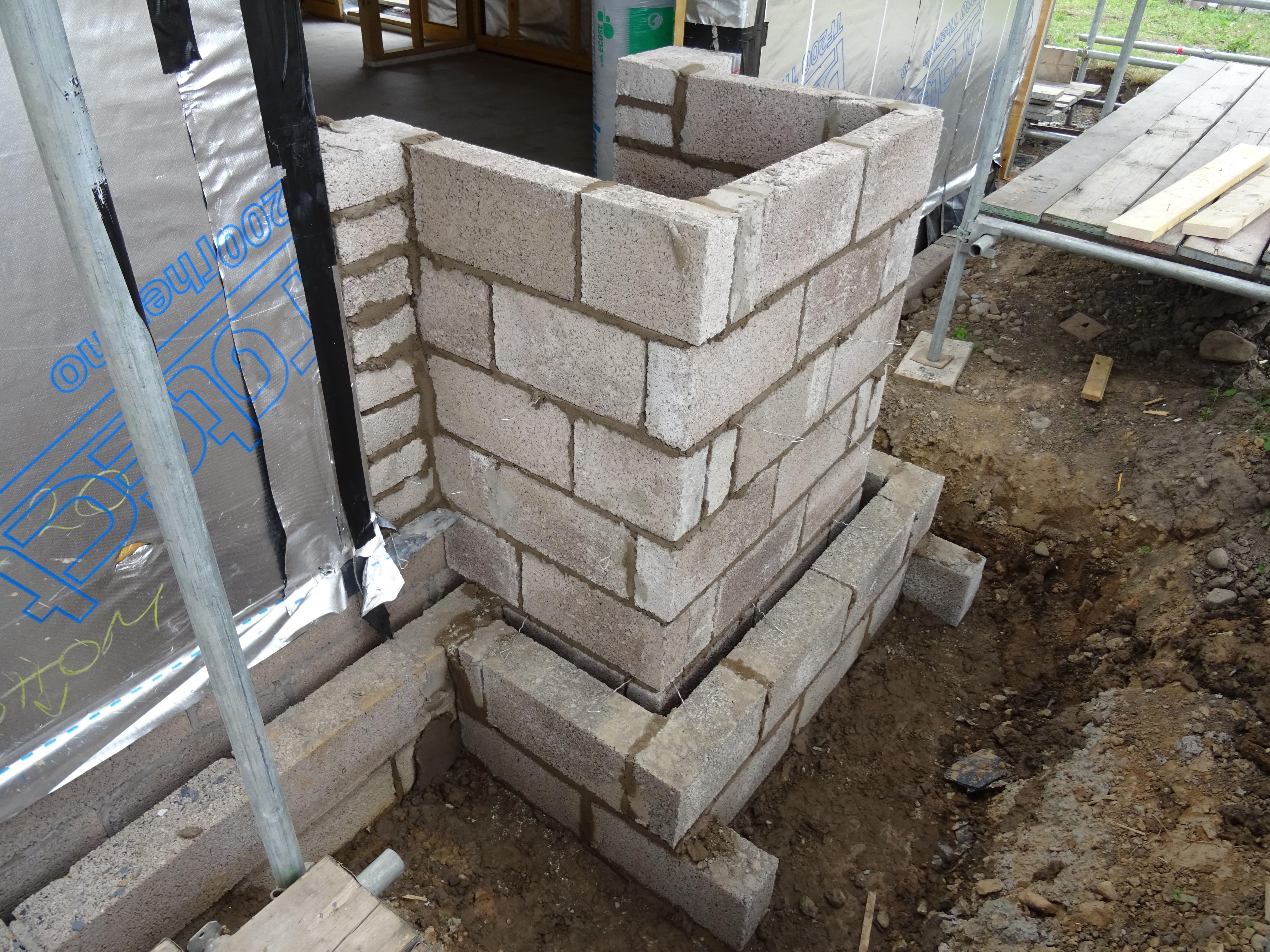

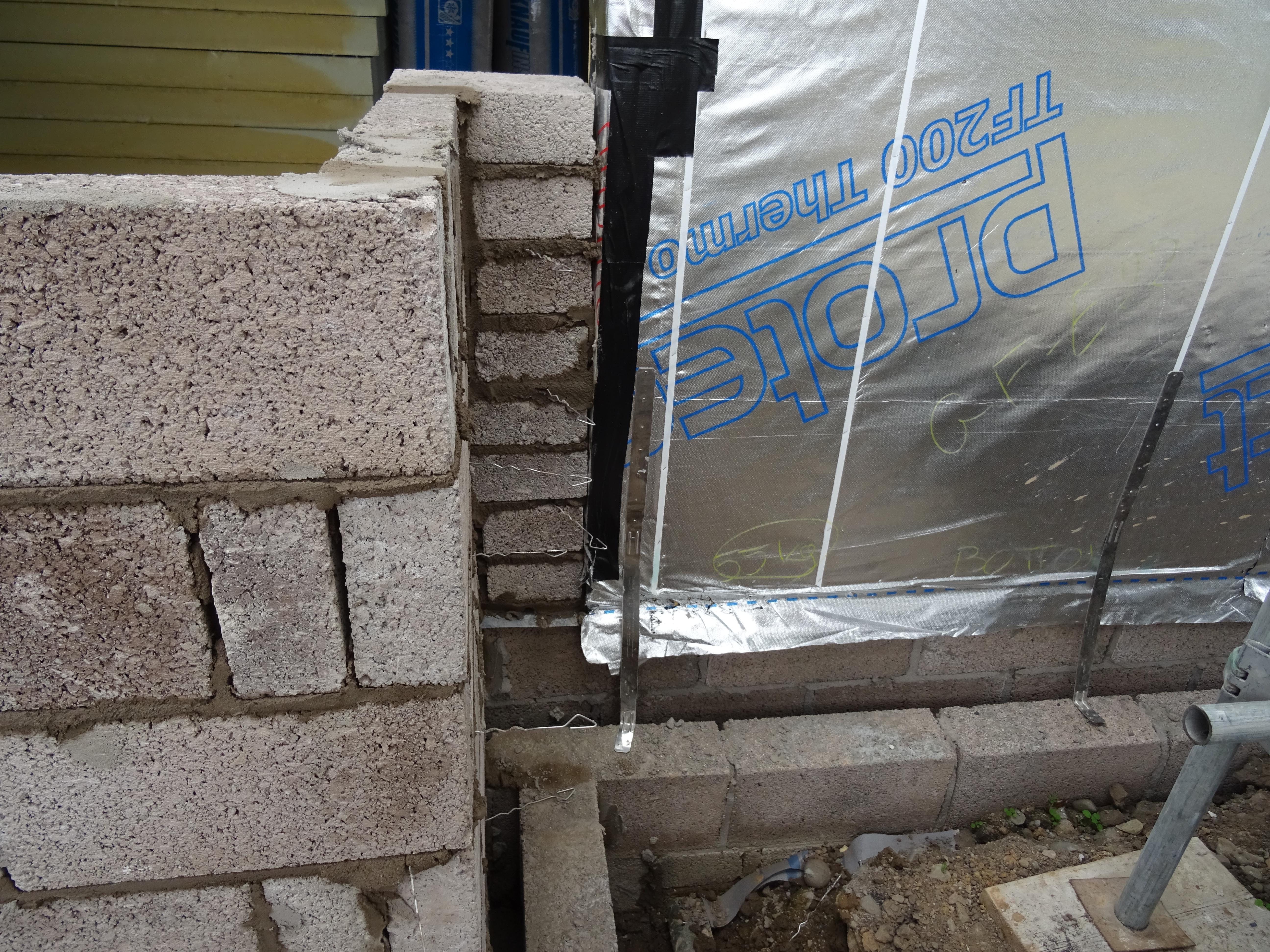

@Ed_MK Not sure how advanced you are with teh chimney but as I mentioned previously, ours started today and these photos may be of assistance.
The basically show the external chimney being constructed in block work, a cavity and then the blocks on which the external stone will sit on and rise up from. The chimney has been constructed so that it sits flush with the internal panels of the TF.
Link to comment
Share on other sites

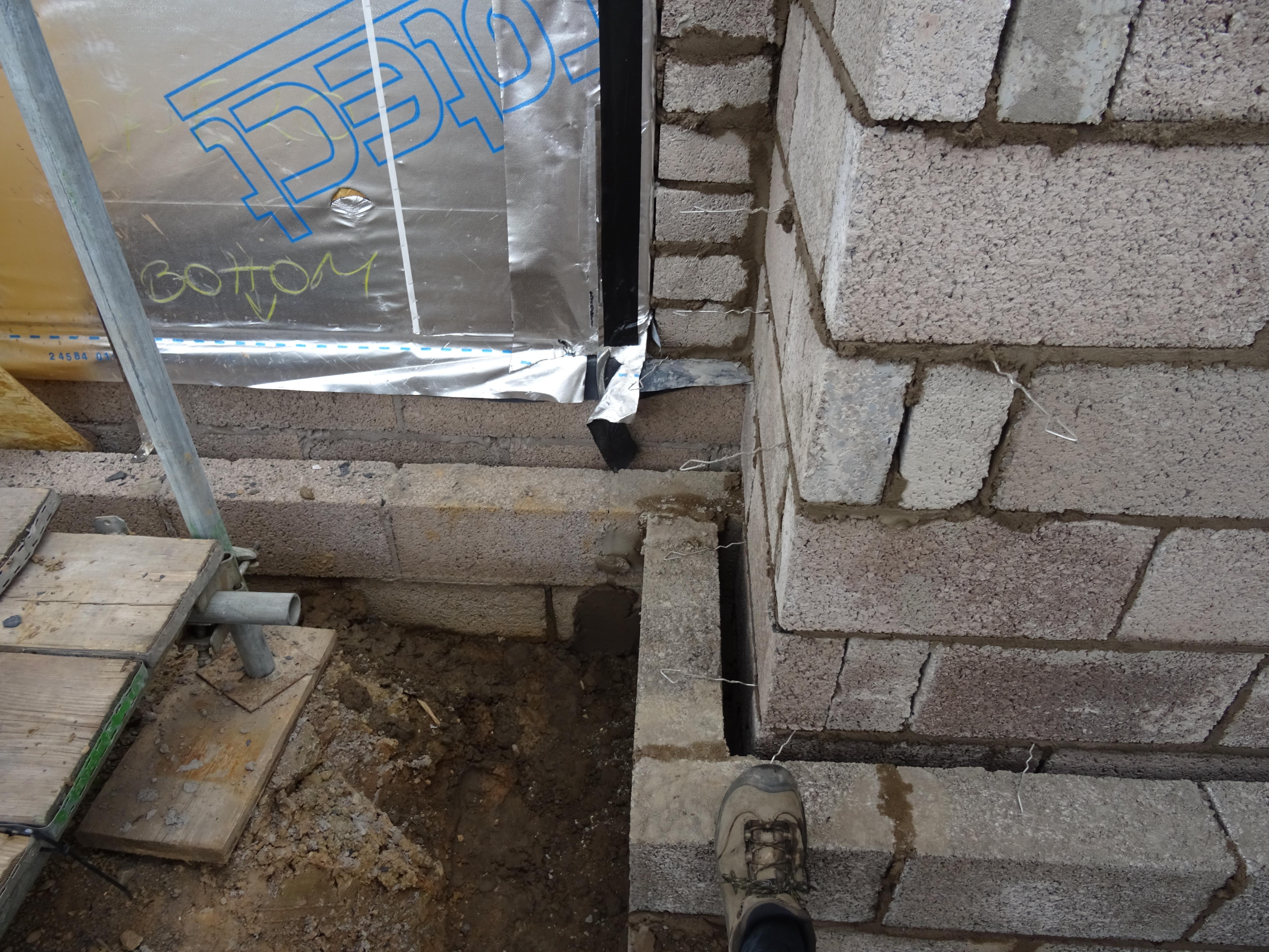

So how are you insulating that cavity ..?
otherwise you have a monumental cold bridge through that corner.
Link to comment
59 minutes ago, Redoctober said:
Good point @PeterW What are my options ?
Only real option is pull down that external skin and move it out to give you 100mm cavity. Then full fill the cavity with rock wool and wrap it past the edges of the block onto the TF.
What chimney system are you using ..?
Link to comment
 Thanks. I will know more in the morning as the guy doing the internal bit and the WBS installation will be in site.
Link to comment

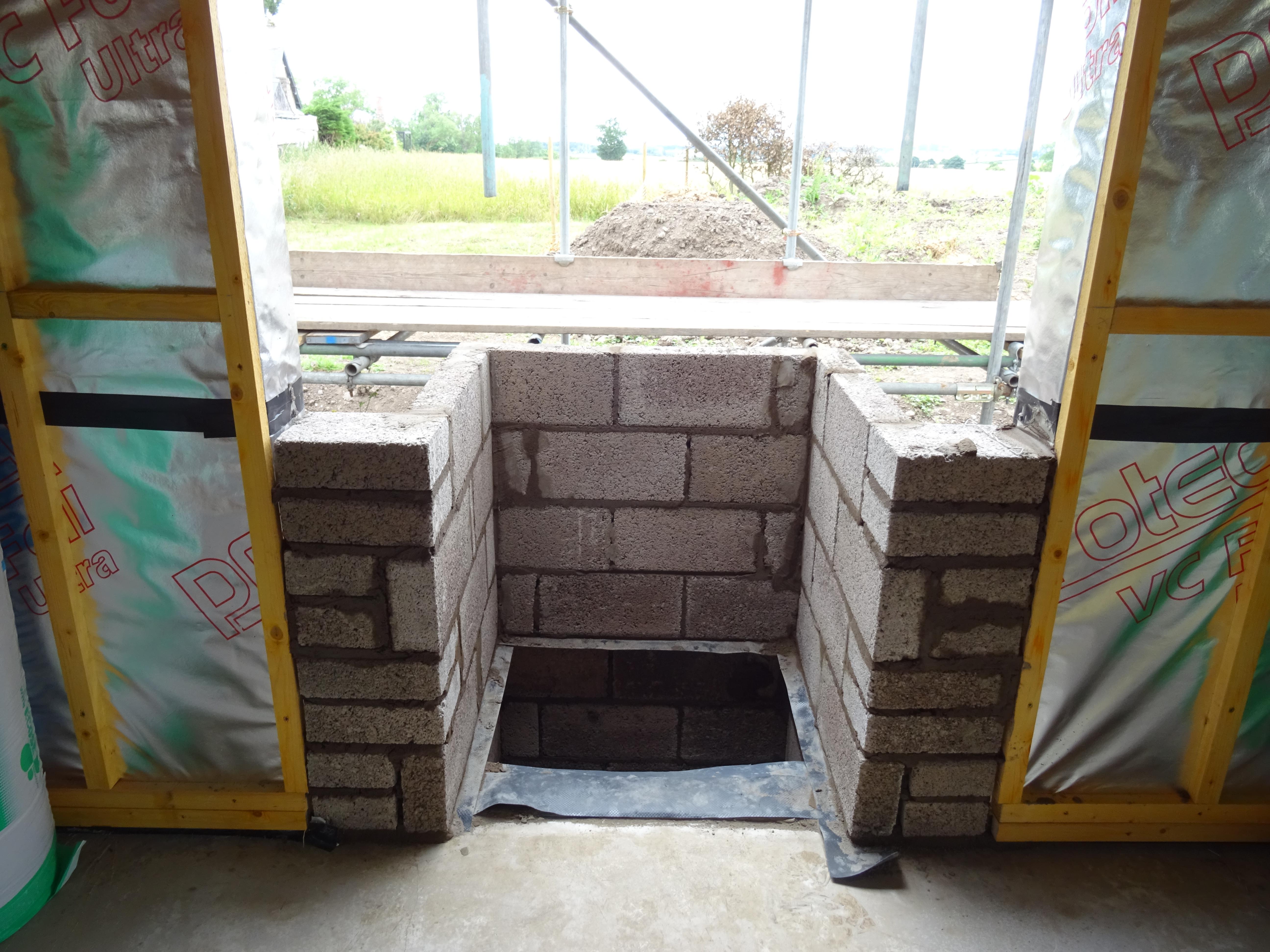

we did what @PeterW suggested.
If you use a concrete liner / rings make sure you used the correct one to start with - my brickie balanced it on a few blocks (on top of some lintels) - complete pain in the arse to connect the stove to this - this headache hasn't been fully resolved yet.
Pictures 4 & 5 here.
http://www.selfbuildselfhelp.com/Advice/DoingStuff/ChimneyFlue2.htm

1 hour ago, PeterW said:
But  my money would be to spend on a  balanced flue gas fired log burner. Something like the Gazco Huntingdon 40 would fit perfectly and it can be routed up above the inner lintel so it “looks” like a proper stove and then out the back of the chimney breast and you will never notice it.
that is EXACTLY the one the wife wants Peter :)
although we are swaying between the 30 and 40
and still trying to get our head around the CF versus BF bit
but i hear your post above ....either way we are into a liner ...looks like back to Dunbrik config page again
