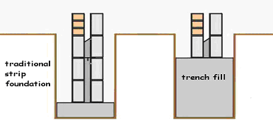

epsilonGreedy Posted June 23, 2018 Posted June 23, 2018 (edited) I met my "wise owl" building adviser on site this week to discuss the dig and concrete pour. He recommended opting for something less than a full trench fill at a typical 150mm below ground level and instead advised pouring the concrete to 300m below ground level. This he said will provide more flexibility with fine tuning the finished level of the foundation blockwork and also simplify routing services through the foundations. The building control chappie then joined us for a meet & greet and said he knew the ground conditions well enough at my plot to indicate a standard 250mm pour at 1m deep would suffice. In summary I had two wise gentlemen, with over 90 years in house building and building control between them, saying 850mm of trench fill is OTT for my plot. If I follow their combined advice my concrete will be 700mm deep and 700mm wide. Has any forum member ended up with foundation concrete somewhere between 250mm deep and full trenchfill (excluding passiv slabbers of-course)? Edited June 23, 2018 by epsilonGreedy
Russell griffiths Posted June 23, 2018 Posted June 23, 2018 It’s all 6 of one half a dozen of the other if you put a less amount of concrete in you will need more brickwork to get to ground level if you fill to within 300 of finished ground level you will have more expenses in concrete but less in brick work. I would work out your damp course level, and measure down from that, making sure you have enough room for pipes to exit under finished ground level but above concrete level. Laying bricks in a skinny trench full of water is not fun, concrete in relative terms is a cheap product compared to a days wages.

ProDave Posted June 23, 2018 Posted June 23, 2018 It does vary tremendously. We had no depth stipulation other than we had to dig through the thick layer of top soil down into the sandy clay sub soil. But for some strange reason our SE specified reinforcing mesh in the concrete strip foundation pour. No doubt it will be stronger but never seen that before. Less concrete and more blocks will usually be cheaper. Also has the advantage of more room to correct things if the concrete pour is not dead level.
PeterW Posted June 23, 2018 Posted June 23, 2018 Strip foundations - which is what your BCO is talking about - have to be a minimum of 2w where w is the width of the finished wall. The depth of the strip that most SE’s will specify is a minimum of w so either you have some skinny walls or your BCO is taking the regs and adding 100mm ... The biggest issue with strip fill is laying foundation blocks - you also need clearance and your brickies will hate you if there is no clear edges and they are having to hand ball foundation blocks from ground level to -750mm all day. A rough approximation from Spons shows Trenchblock at 305mm as £47 per square metre. The same linear metre with trenchfill is about £56 based on £80/cube for concrete. Trenchfill will take a couple of hours to complete - trench blocks are roughly an hour per square metre so 4-5 days depending on complexity. I can’t see why you would use strips and blocks based on that.
epsilonGreedy Posted June 23, 2018 Author Posted June 23, 2018 7 minutes ago, PeterW said: The depth of the strip that most SE’s will specify is a minimum of w so either you have some skinny walls or your BCO is taking the regs and adding 100mm ... In my case we are talking about 100+100+100 brick and block walls. 9 minutes ago, PeterW said: The biggest issue with strip fill is laying foundation blocks - you also need clearance and your brickies will hate you if there is no clear edges and they are having to hand ball foundation blocks from ground level to -750mm all day. As mentioned above the margin of debate is foundation blocks from either -300mm or -150mm. 10 minutes ago, PeterW said: A rough approximation from Spons shows Trenchblock at 305mm as £47 per square metre. The same linear metre with trenchfill is about £56 based on £80/cube for concrete. Trenchfill will take a couple of hours to complete - trench blocks are roughly an hour per square metre so 4-5 days depending on complexity. Thanks for the Spons figures. My Gen-1 concrete is being supplied at £74/cube which sways things further from a financial aspect. Linear house trenches are 60m including a supporting walls. Using Spons I am trading £460 of concrete for blockwork at £423 + labour + time. 16 minutes ago, PeterW said: I can’t see why you would use strips and blocks based on that. It comes down to having an extra 150mm in block height to level out any error in the finished height of the poured concrete and more flexibility for routing services through the foundations.
PeterW Posted June 23, 2018 Posted June 23, 2018 So don’t pour a full load but bear in mind you’ve got to be a min 450mm below ground level with any foundation, and most services will be within the first 300mm at most below the surface, pouring a 600 x 600 into a 900 x 600 trench gives you lots to play with. One course of blocks and you’re into engineering bricks anyway so easy money.

epsilonGreedy Posted June 23, 2018 Author Posted June 23, 2018 30 minutes ago, PeterW said: So don’t pour a full load but bear in mind you’ve got to be a min 450mm below ground level with any foundation, and most services will be within the first 300mm at most below the surface, pouring a 600 x 600 into a 900 x 600 trench gives you lots to play with. One course of blocks and you’re into engineering bricks anyway so easy money. In my case I reckon it will be 700 x 700 poured in a 1000 x 700 trench. Mr Wise Owl has twice tated his preference for 700mm wide trenches. Would I be correct in thinking the mains water is the only deep service entry buried in the concrete? Hmmm must check what the underground LPG tank people expect.

Construction Channel Posted June 23, 2018 Posted June 23, 2018 39 minutes ago, epsilonGreedy said: In my case I reckon it will be 700 x 700 poured in a 1000 x 700 trench. Mr Wise Owl has twice tated his preference for 700mm wide trenches. Would I be correct in thinking the mains water is the only deep service entry buried in the concrete? Hmmm must check what the underground LPG tank people expect. What exactly does mr wise owl intend to dig the 700mm wide trench with? 600mm is the standard and almost any groundworking firm will have a digger bucket to match that, 700mm sounds like a person that’s very good at drawing pictures but hasn’t had much real world experience of digging trenches. Just my 2 cents. 1 1

Russell griffiths Posted June 24, 2018 Posted June 24, 2018 My personal opinion is that there really isn’t any other option I would do trench fill, unless you dislike your bricklayers. 2
Russell griffiths Posted June 24, 2018 Posted June 24, 2018 (edited) 19 hours ago, epsilonGreedy said: At this time of year flooding on top of the set concrete 150 or 300mm below ground is not my current concern, should it be? Flooding from ground water may not happen, but what about rain. A deep trench with 250mm of concrete in the bottom will fill up like a bath tub if you get a good down pour. Shallow trench can be swept out with a broom and bailed out at a low spot. Edited June 24, 2018 by Russell griffiths
epsilonGreedy Posted June 25, 2018 Author Posted June 25, 2018 On 24/06/2018 at 12:15, Russell griffiths said: Flooding from ground water may not happen, but what about rain. A deep trench with 250mm of concrete in the bottom will fill up like a bath tub if you get a good down pour. Shallow trench can be swept out with a broom and bailed out at a low spot. Sure, though as mentioned above I am not contemplating the complete opposite to trenchfill. My remaining choice falls within the range of the concrete finishing 300mm or 150mm below ground level. A week ago I was not aware that, subject to engineering constraints, the concrete thickness could be 250mm or 1000mm (trenchfill) or any point between given a 1m deep trench.
Russell griffiths Posted June 25, 2018 Posted June 25, 2018 1 hour ago, epsilonGreedy said: Sure, though as mentioned above I am not contemplating the complete opposite to trenchfill. My remaining choice falls within the range of the concrete finishing 300mm or 150mm below ground level. A week ago I was not aware that, subject to engineering constraints, the concrete thickness could be 250mm or 1000mm (trenchfill) or any point between given a 1m deep trench. Ok 300mm it is then sorted. ??

Temp Posted August 22, 2018 Posted August 22, 2018 (edited) Concrete. See.. . http://www.nhbc.co.uk/Builders/Technicaladviceandsupport/TechnicalGuidance/61/filedownload,37205,en.pdf the concrete in a cavity wall should stop at least 225mm below the base dpc Edited August 22, 2018 by Temp 1
epsilonGreedy Posted August 22, 2018 Author Posted August 22, 2018 5 hours ago, Temp said: Concrete. See.. . http://www.nhbc.co.uk/Builders/Technicaladviceandsupport/TechnicalGuidance/61/filedownload,37205,en.pdf What is the recipe for such concrete fill? I have seen references to a lean mix and semi dry.
