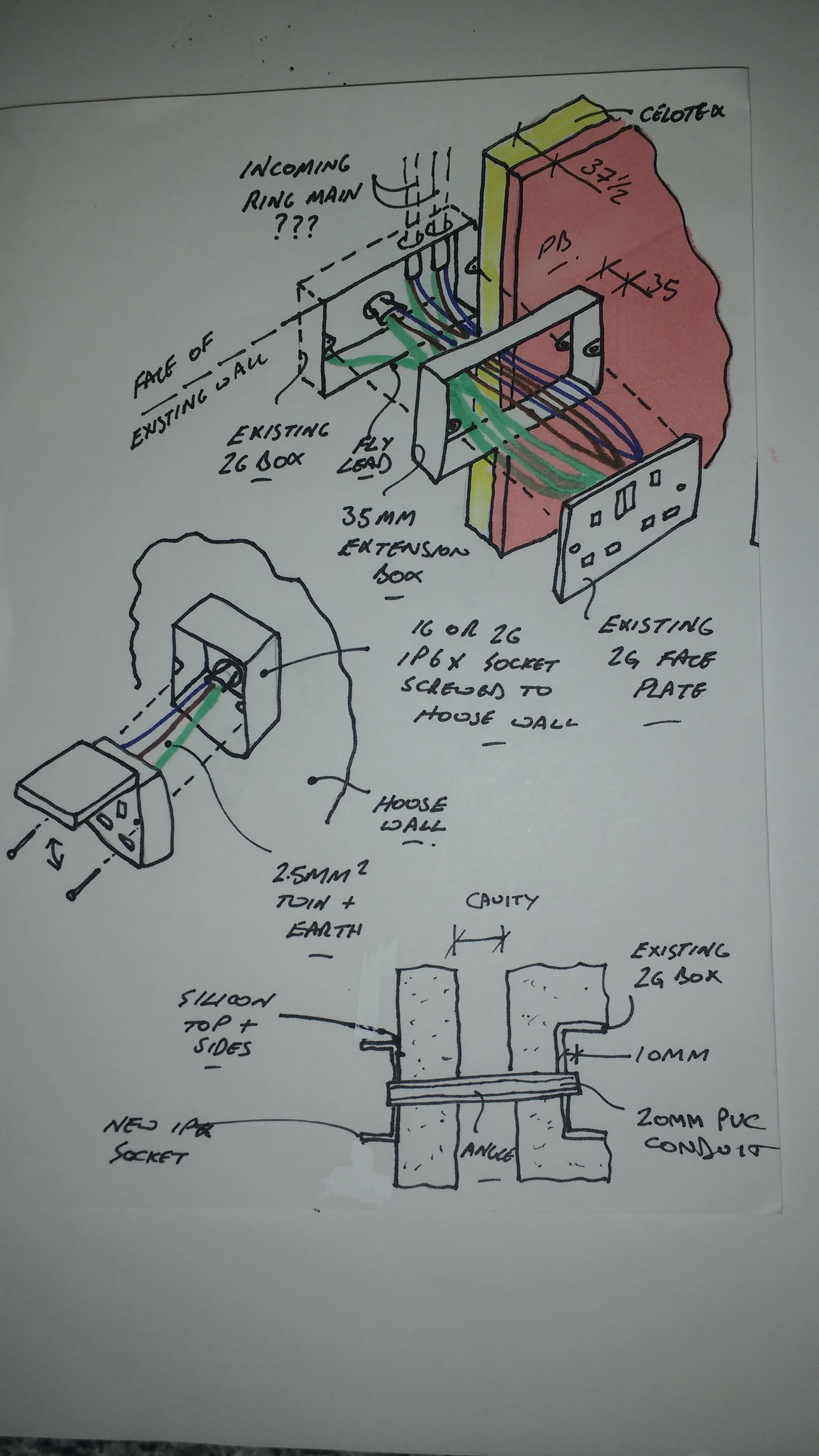

Onoff Posted September 1, 2018 Posted September 1, 2018 The existing socket stays where it is and in use. A short, new length of 2.5mm twin and earth connects it to the new outside socket which can be one or two gang. Something like this: I'm making assumptions that your ring main is RCD protected and that it is in fact a ring main. Your electrician would be able to advise better. 2
zoothorn Posted September 1, 2018 Author Posted September 1, 2018 Onoff that's flippin marvellous.. thanks (your drawings are great btw). Forgive me for asking a daft Q.. but how could I drill through the back of the socket, using leccy if the leccy's off for this work? battery drill? I think maybe I need an electrician for this job.. but mine's n/a for end of year. How would I establish if its a ring main.. only a spark can know the answer-?
Onoff Posted September 1, 2018 Posted September 1, 2018 1 minute ago, zoothorn said: Onoff that's flippin marvellous.. thanks (your drawings are great btw). Forgive me for asking a daft Q.. but how could I drill through the back of the socket, using leccy if the leccy's off for this work? battery drill? I think maybe I need an electrician for this job.. but mine's n/a for end of year. How would I establish if its a ring main.. only a spark can know the answer-? Ideally a gutsy cordless. Depends what's the walls are made of. If it's lightweight, aerated concrete blocks like "Celcon" then your cordless MAY do it., but if not... Isolate the circuit that that socket's on. MAKE SURE IT'S DEAD!. Plug extension lead into another socket on a different circuit....does the cooker switch (hopefully on a separate circuit) have a socket? Tape / clip the existing wires out of the way Prise/knock out one of the 20mm knockouts in the back of the existing back box. Drill through at a shallow angle. As to whether it's a ring, the proper way is by inspection and testing: Very roughly; isolate and test for dead. Prove your tester thereafter on a known source of supply; proving unit etc. Using a low reading ohmmeter, check for continuity of the ring final conductors i.e. P1/P2, N1,N2 then CPC1/CPC2. Cross connect the ends of the ring at the cu and test at each socket on the ring. Reading should be nominally the same at each socket on the ring. High readings should show up loose connections or spurs. Open circuits may indicate reverse polarity etc. Too much to teach you tbh. Go to college? Buy a book? Brian Scadden's stuff (imo) is a good, simple and informative read, the IET guide to the Building Regs book is good, Guidance Note 3 and so on. But.....at a push this: A ring main socket has generally two bits of 2.5mm2 T&E cable going to it, If you disconnected those two wires from the face plate they would both still be "live" as each "leg" goes back to likely a 32A breaker at the consumer unit. In rough terms then at each ring main socket the load is shared between each leg. So you isolate your power and disconnect the socket. Make safe the L,N & E of one leg (connector blocks, tape etc) and connect the remaining leg back to the socket. Power back on, does the socket work via that 32A breaker? If so that says it's likely going back to the cu. Disconnect and make safe the leg you know is "live". Do the same with the other leg. If both are showing as "live" it's likely it's a ring. If one leg is dead then it could be a spur or there's a break further down the line. None of this is certain and as you appear not to have even the most basic knowledge of domestic electrics there's great scope to kill yourself. Sorry, but that's the way it is, I'm not being rude.

zoothorn Posted September 1, 2018 Author Posted September 1, 2018 22 minutes ago, Onoff said: None of this is certain and as you appear not to have even the most basic knowledge of domestic electrics there's great scope to kill yourself. Sorry, but that's the way it is, I'm not being rude. Ok best I leave the electrics for another thread I think, it only gets you annoyed which isn't ideal! its last job now/ to separate. What I'll do is print off your info & give to my spark that'll be best idea. If I can just ask you on the plumbing, & the other stuff, I'll leave the electrics to only the finger plate addition, & the extension boxes. I'm on the downhill now/ done the hardwork (I fKN hope!) so should be generally rewarding from now on putting it all back together! Big thanks- zoot [look mods can we just scrap pgs 1-20 already? :-]
