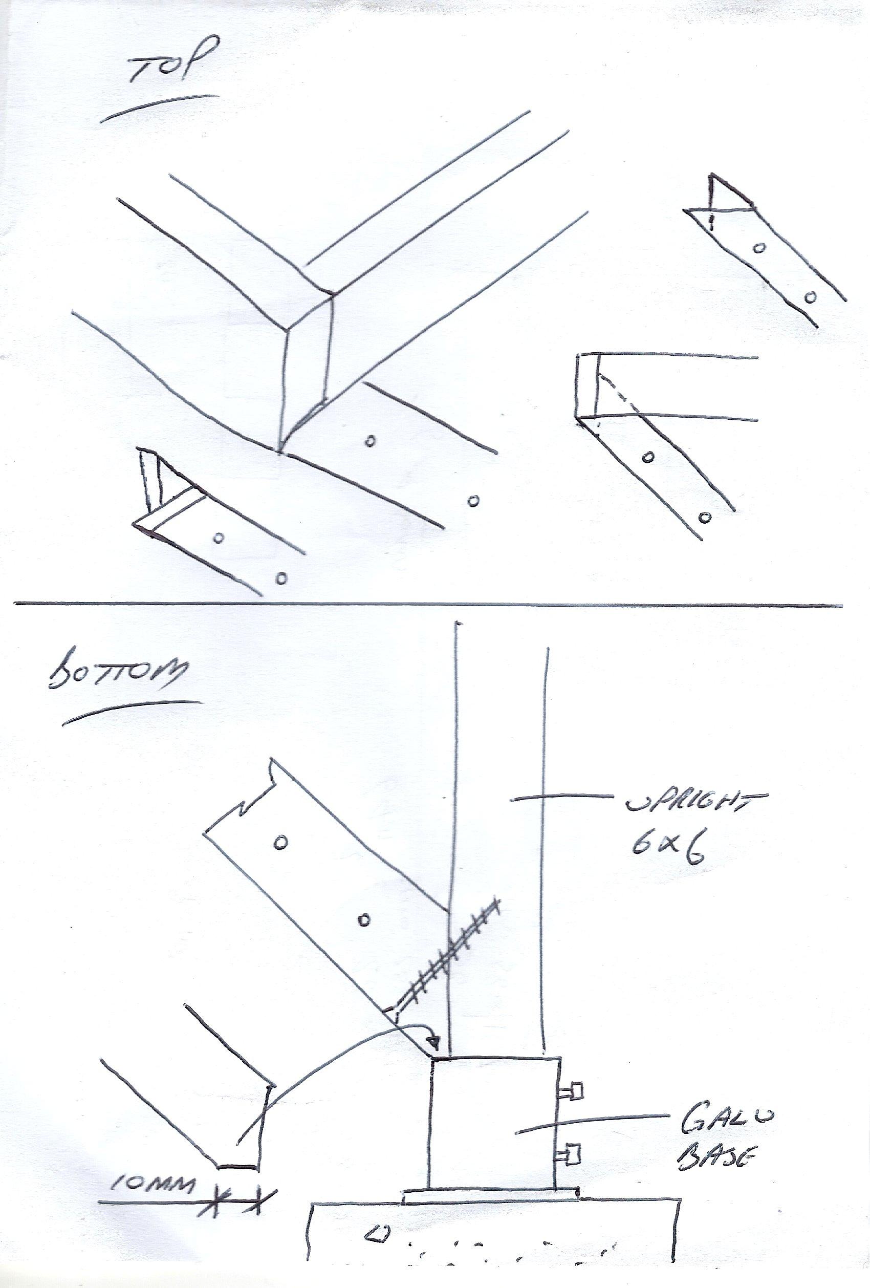

Onoff Posted June 12, 2020 Posted June 12, 2020 On 12/06/2020 at 13:07, zoothorn said: That's a great idea.. using the concrete cabin corner pad: so a big diagonal strut for the big-slope RHS? Expand Like I just said. Presumably mine was a sh!t idea? ? Think I drew it ages ago too. "a diagonal brace down to the chunky 6x6 for the other corner....."
zoothorn Posted June 12, 2020 Author Posted June 12, 2020 @Onoff spot on idea then! must admit I didn't know at the time what these two wee lines were (or could read yr words 'brace if rqd' either) until you've just pointed them out tho. Good that's a fine plan.. just how to attatch my 3x3 at each end to consider on the long RHS one. How about for the short vertical LH cnr.. dig hole say 6" wide x 6"deep, attatch 3x3 to cnr going down into me 'ole, fill ole with postcrete -? Yes names I'm considering are as said The Cambrian Alpine Chalet, or possibly 'F&ckwit's Shed'. I'm really torn between the two.
PeterW Posted June 12, 2020 Posted June 12, 2020 On 12/06/2020 at 22:03, zoothorn said: How about for the short vertical LH cnr.. dig hole say 6" wide x 6"deep, attatch 3x3 to cnr going down into me 'ole, fill ole with postcrete -? Expand Yep that’s the plan. Crack on.
PeterW Posted June 12, 2020 Posted June 12, 2020 On 12/06/2020 at 22:03, zoothorn said: just how to attatch my 3x3 at each end to consider on the long RHS one. Expand Cut at 45 degrees and just a couple of BFO screws through the bottom (drill them first) and then same through the side into the frame.
Onoff Posted June 13, 2020 Posted June 13, 2020 I'd be (coach)bolting 2 bits of 6x3 together to make that diagonal brace. It'd match the big uprights and the top "notched" detail like below would provide great support and all look flush. At the bottom I'd have it sitting on the edge of the galvanised post base then screw in as Peter says. That's just me though!

zoothorn Posted June 13, 2020 Author Posted June 13, 2020 On 12/06/2020 at 22:26, PeterW said: Cut at 45 degrees and just a couple of BFO screws through the bottom (drill them first) and then same through the side into the frame. Expand Aha I think I get it. Btm is fine & strongest join if resting on the galv. So the top join: just nip a 45* bit off the top, & BFO screw into the outer looong RH beam, just inside nearest front? so no need to notch it/ join onto the front section-? I was thinking this front 'tagged-on' section not perhaps the strongest bit to apply this posts' weight onto + outwards. Still think 3x3 ok? Onoff thinks 6x3.. but maybe just due to better look/ matching my 6x6 pillars. This stream side not seen tbh.
PeterW Posted June 13, 2020 Posted June 13, 2020 That’s because @Onoff has the middle names “Over Engineer”..... 3x3 is more than enough - it’s only to take the bounce out of the corner and tbh the cantilever is strong enough on its own unless you’re planning to host the All Wales Fat Lad Pastie eating contest * on the deck... *I believe @Nickfromwales was the southern winner 3 years in a row ... 1
Onoff Posted June 13, 2020 Posted June 13, 2020 On 13/06/2020 at 15:29, PeterW said: That’s because @Onoff has the middle names “Over Engineer”..... 3x3 is more than enough - it’s only to take the bounce out of the corner and tbh the cantilever is strong enough on its own unless you’re planning to host the All Wales Fat Lad Pastie eating contest * on the deck... *I believe @Nickfromwales was the southern winner 3 years in a row ... Expand My way you could likely wedge it in with no screws! Aesthetics & engineering are better all round. Flush etc. Do it Peter's way if you want Zoot. Screw another bit of 3x3 on top ofvthd first and it'll match the chunky verticals
Onoff Posted June 13, 2020 Posted June 13, 2020 On 13/06/2020 at 14:54, zoothorn said: Aha I think I get it. Btm is fine & strongest join if resting on the galv. So the top join: just nip a 45* bit off the top, & BFO screw into the outer looong RH beam, just inside nearest front? so no need to notch it/ join onto the front section-? I was thinking this front 'tagged-on' section not perhaps the strongest bit to apply this posts' weight onto + outwards. Still think 3x3 ok? Onoff thinks 6x3.. but maybe just due to better look/ matching my 6x6 pillars. This stream side not seen tbh. Expand Top end under the balcony corner...front bit does half the work. Inside bit shares the work & keeps it all there. Bottom resting on the galv shoe just keeps it up a bit out of the dirt. I'm sure it'll look the dogs danglies when done. You can relax on that deck with a beer!

zoothorn Posted June 15, 2020 Author Posted June 15, 2020 RHS diagonal support 3x3 done, turbo bolted & seems good support for this side. What's the idea with scaffold boards.. put them across (like the working two are at the mo), with a 5mm gap between.. & cut off flush with edge of my base frame? I guess then I need a handrail around 2 sides: LHS not needed as you step onto deck from here. Thanks- zH
PeterW Posted June 15, 2020 Posted June 15, 2020 On 15/06/2020 at 10:35, zoothorn said: RHS diagonal support 3x3 done, turbo bolted & seems good support for this side. What's the idea with scaffold boards.. put them across (like the working two are at the mo), with a 5mm gap between.. & cut off flush with edge of my base frame? I guess then I need a handrail around 2 sides: LHS not needed as you step onto deck from here. Thanks- zH Expand Tidy ! Turbo bolt a couple of upstands such as 3x3 to the frame and rout the tops/sides to make them pretty and then decide what you want as a handrail..?? if its only you using it then a low board to stop you kicking anything off into the stream, and then use nice rope..??
