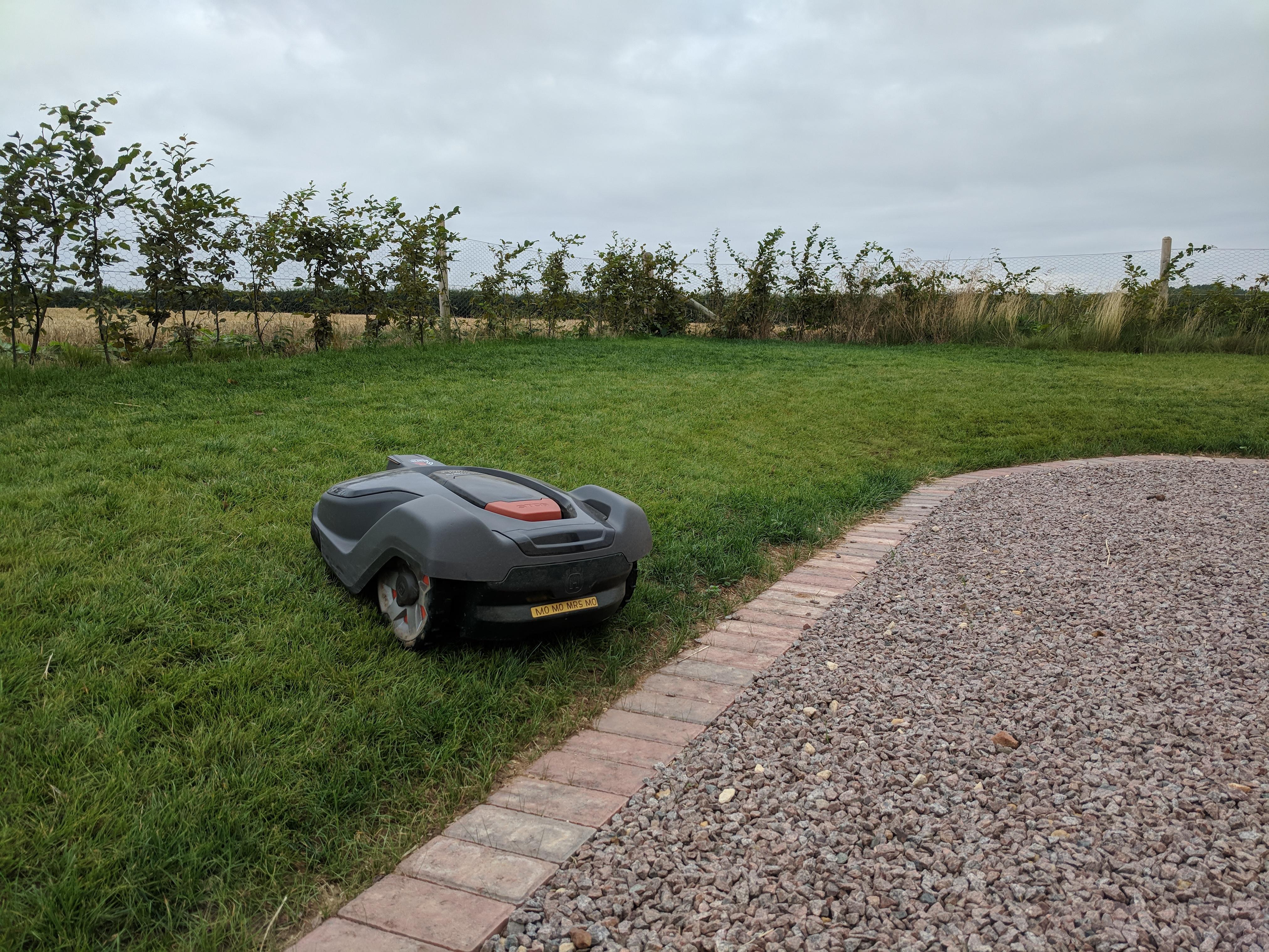

readiescards Posted August 22, 2018 Author Posted August 22, 2018 3 weeks in: loving it(her) Mo Mo Mrs Mo, as my son has called her, is doing a great job. Some great features including the alerts to my phone when she gets stuck or falls out of the cutting area. This is the trickest bit of my lawn a 22 deg slope on a corner. Currently once every few days I have to reposition her when she has been unable to back up and has fallen out of the zone - optional extra rough terrain wheels might help but I'm trying to avoid the extra cost atm. My 1100m2 lawn is looking fine with cutting period set to 8am to 4pm and I've just dropped the cutting height from 7/10 to 6/10. Roughly she does about 3 hours work before popping back to her home to have a 40-50minute electric juice snack. We've painted some bits of the lower body green, added some eye lashes and her name, along with some extra mods, to make her less nickable - though the useful GPS location function and security pin code should help. Had to clean the wheels of mud a couple of times - but that was my fault for letting her go to work when the lawn is still missing grass in places and it had rained. Apart from when she tried to mount a roller I left on lawn and she tried to climb over some bricks I'd put down as a 'wall' to prevent her getting to some fresh top soil, we had no major incidents. We zip round the very edge of the lawn using a light electric mower and use the supplied electric strimmer (also awesome) to finish off around the tree bases that she can't reach. (About 40 mins/week). So other than that, lawn cutting is a thing of the past for me ? 3
