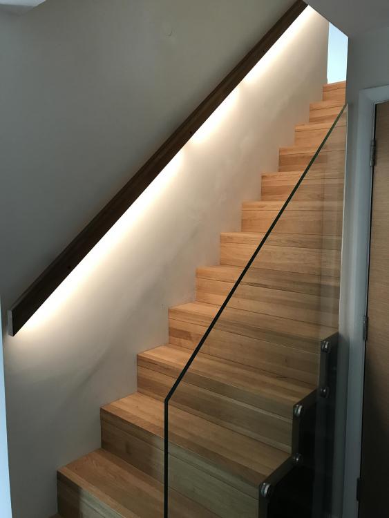

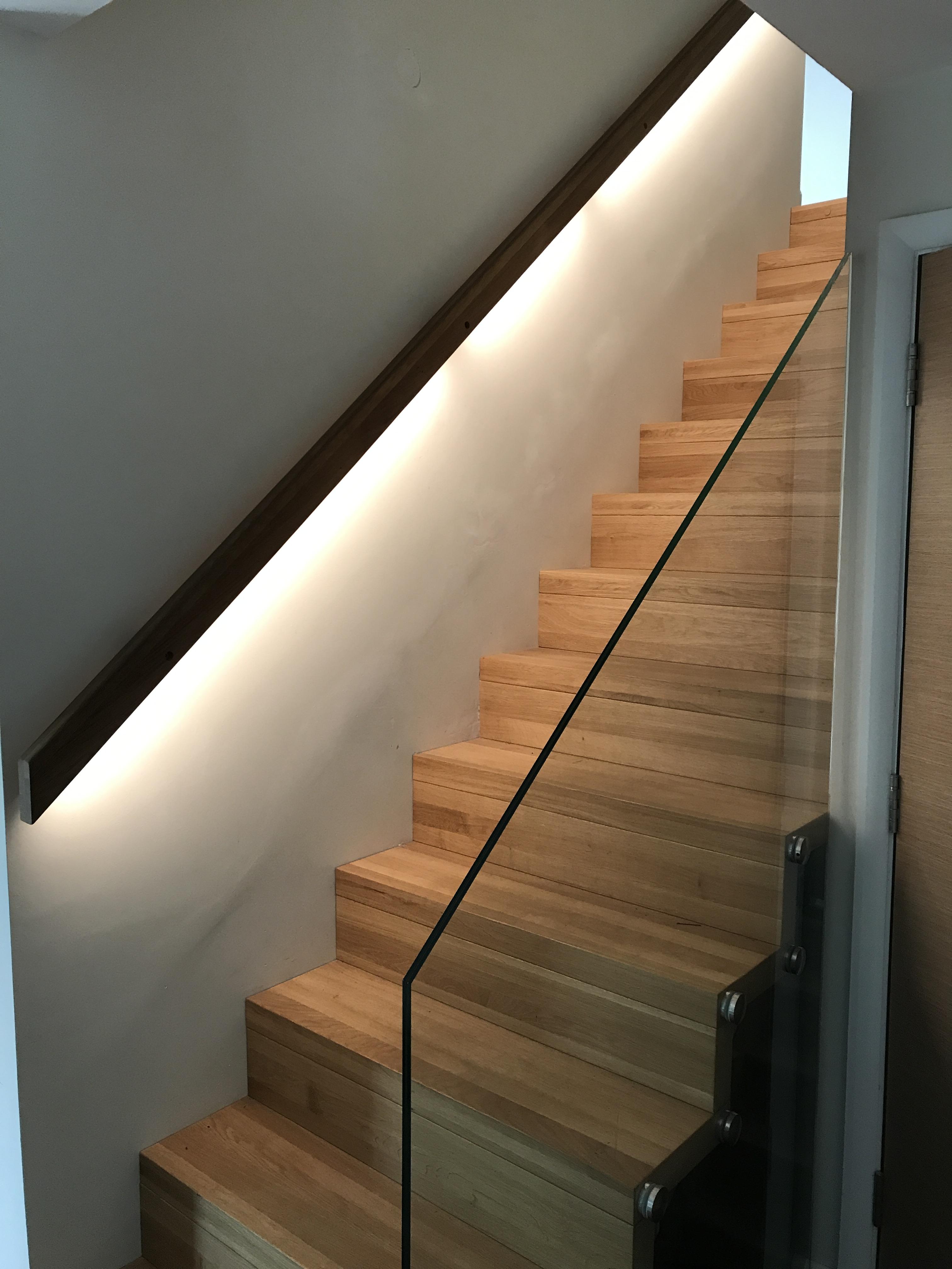

Bitpipe Posted June 7, 2018 Share Posted June 7, 2018 (edited) We put a LED strip in a routed recess (done by manufacturer) in the underside of the handrail, which is fixed to the wall. Sparky made provision for this at 1st fix with a low voltage cable placed behind the wall and the connection to the transformer made in ceiling behind a downlight. Only challenge has been how to control it - currently on a lux but that is not sensitive enough and is on all night. Going to switch to a PIR at some stage. Edited June 7, 2018 by Bitpipe 1 Link to comment Share on other sites More sharing options...
Hecateh Posted June 7, 2018 Share Posted June 7, 2018 37 minutes ago, Bitpipe said: We put a LED strip in a routed recess (done by manufacturer) in the underside of the handrail, which is fixed to the wall. Sparky made provision for this at 1st fix with a low voltage cable placed behind the wall and the connection to the transformer made in ceiling behind a downlight. Only challenge has been how to control it - currently on a lux but that is not sensitive enough and is on all night. Going to switch to a PIR at some stage. I'd like something like this but it is probably beyond my budget. Link to comment Share on other sites More sharing options...

Bitpipe Posted June 7, 2018 Share Posted June 7, 2018 2 hours ago, Hecateh said: I'd like something like this but it is probably beyond my budget. Was cheap to do - had handrail company route a groove and sparky installed an alu channel, LED strip and diffuser. Main challenge was remembering where the cable was hidden behind wall - wasn’t able to fish it out neatly so needed to cut a small disc out of wall, fish cable and make good. Link to comment Share on other sites More sharing options...

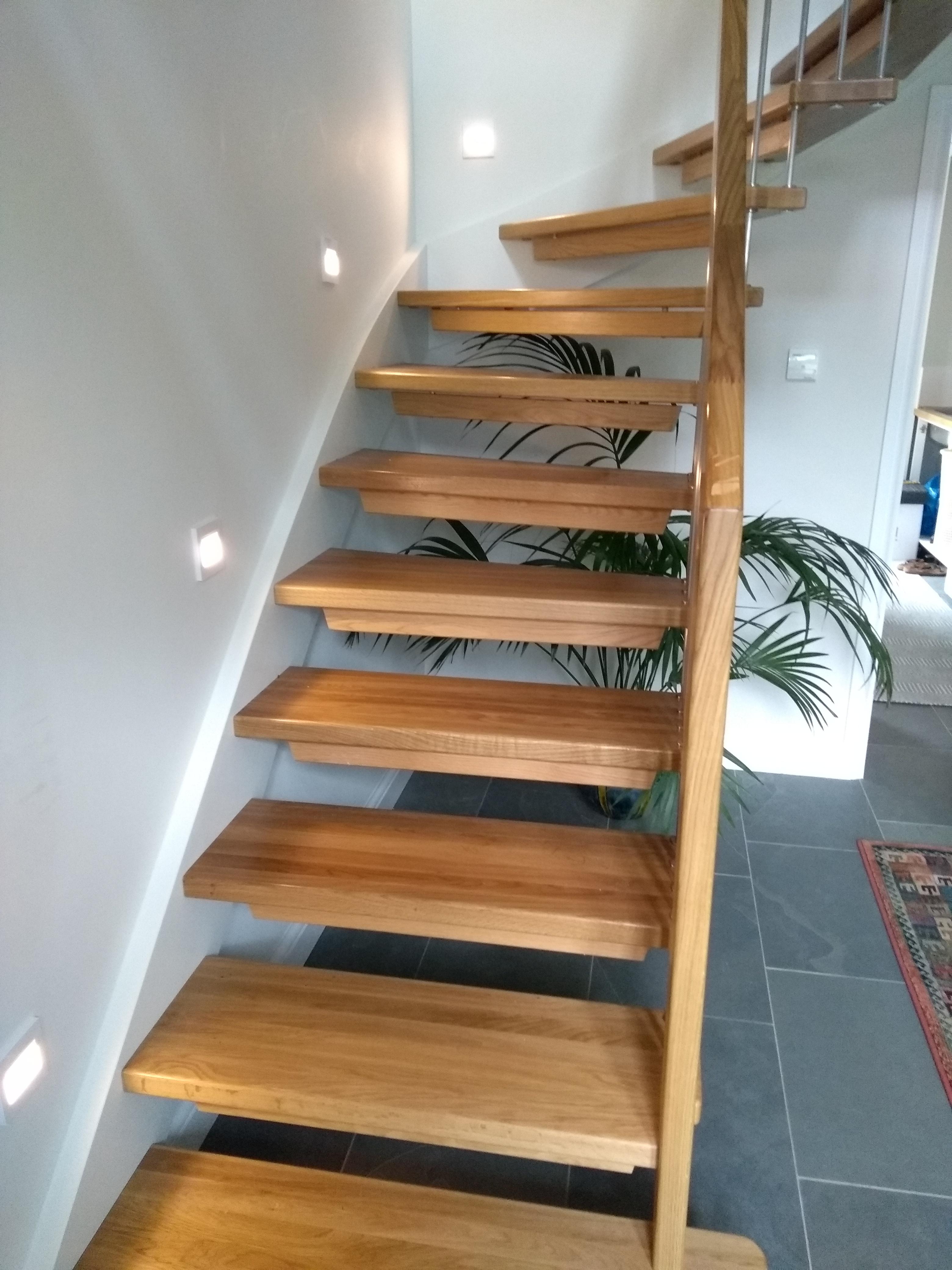

JanetE Posted June 8, 2018 Share Posted June 8, 2018 I was researching this when we were building and was horrified at how expensive this type of light was, in the end I found these; https://www.ledkia.com/uk/buy-apliques-b/464-randy-led-step-light-with-a-white-finish.html Which now we have them installed I love, they give off enough light that we hardly ever need to have the main ones on. 3 Link to comment Share on other sites More sharing options...
