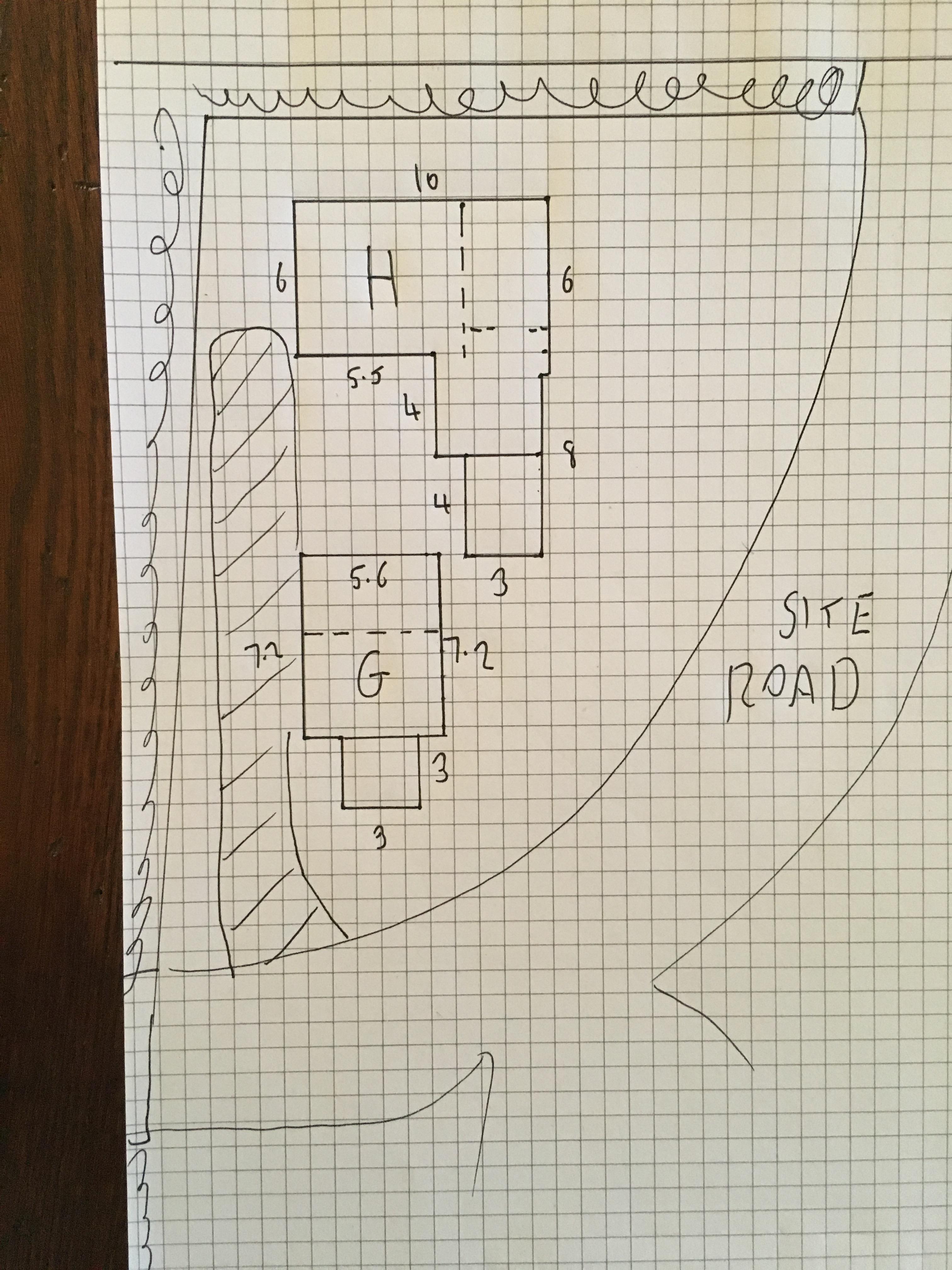

epsilonGreedy Posted June 5, 2018 Author Share Posted June 5, 2018 3 minutes ago, Declan52 said: How are you getting it from the chute to the founds, digger bucket, dumper, pump or poured straight in?? I have been considering this. There is a well compacted internal site road that has taken heavy deliveries in worse weather. The concrete lorry can get within 8 meters of the nearest house foundations while remaining on that site road and the far corner of the house is 10 meters further away. A bit of Google indicates a standard delivery chute has a 3m max reach. The green field site is now solid with a firm grass surface at the moment even so I doubt a 25 ton loaded lorry will venture onto that. There is time to lay the hardcore for the 15m long term drive into the plot. The pour team will be a scratch team, so I guess this all points to a pump? Link to comment Share on other sites More sharing options...
epsilonGreedy Posted June 5, 2018 Author Share Posted June 5, 2018 13 minutes ago, Russell griffiths said: Post up a pic of your site and we can tell you how you are getting it in the trenches. Thanks for this offer, give me 20 minutes to upload something. Link to comment Share on other sites More sharing options...
Russell griffiths Posted June 5, 2018 Share Posted June 5, 2018 If your thinking of a pump, just do it best money you will spend. Link to comment Share on other sites More sharing options...
epsilonGreedy Posted June 5, 2018 Author Share Posted June 5, 2018 Here is the site layout. The site road is actually half the width compared to my hand drawn attempt. Each square is 1m. The site is level and the lorry could leave the site road at any point subject to ground condition. The shaded finger along the left side of the plot is the future drive which could be laid to hardcore. Link to comment Share on other sites More sharing options...

PeterW Posted June 5, 2018 Share Posted June 5, 2018 Pump all the way ..... Get a price from a pump company to supply both pump and concrete and it becomes zero rated for VAT. That could save you quite a chunk on VAT reclaim. Pump grade is very different stuff though - 10mm aggregate and needs to be perfect consistency. You also need a couple of bags of cement to prime the pump and somewhere to wash out the pump which could have up to 1/2cube left in it depending on the machine. 1 Link to comment Share on other sites More sharing options...
epsilonGreedy Posted June 5, 2018 Author Share Posted June 5, 2018 1 hour ago, PeterW said: Pump all the way ..... Thank you for taking time to assess this. Was your clear advice influenced mostly by the unprepared ground/distance from the site road or lack of a heavyweight ground worker crew? 1 hour ago, PeterW said: Get a price from a pump company to supply both pump and concrete and it becomes zero rated for VAT. That could save you quite a chunk on VAT reclaim. Ok. Would a direct concrete only supply be subject to VAT as it is just a material, if so that is quite a large chunk of VAT saved. Link to comment Share on other sites More sharing options...
PeterW Posted June 5, 2018 Share Posted June 5, 2018 6 minutes ago, epsilonGreedy said: Thank you for taking time to assess this. Was your clear advice influenced mostly by the unprepared ground/distance from the site road or lack of a heavyweight ground worker crew? Ok. Would a direct concrete only supply be subject to VAT as it is just a material, if so that is quite a large chunk of VAT saved. Bit of both on the first one - you need a decent crew on a pump, and I would leave it to someone else to have the nightmares ! The other big plus is that if the pump and concrete are one supply, its up to them to co-ordinate and decide how much is needed etc. If you can get to a pour point near the trenches then use a self compacting and flowing concrete and save the £4-500 for the pump but you may find its not that easy. Direct supply would be VAT rated and 40 cuM is going to be £4k or thereabouts plus the 20% VAT depending on location. Link to comment Share on other sites More sharing options...

epsilonGreedy Posted June 6, 2018 Author Share Posted June 6, 2018 16 hours ago, recoveringacademic said: You can't . You need to know the people involved. Here Be Dragons. Lots of them. Get a contractor you can trust. I was rumbled within seconds, even so the outcome was good with a pleasant price for the pump-able stuff and plenty of advice. The supplier will assign two wagons to my site on the day and these will run in a shuttle (about 8 miles each way) to feed the pump, should be all done within 4 hours. Last night while reading the House Builder's Bible again I noted that trench fill is typically left 150mm below ground level so I was able to shave 15% off my cubic estimate. Link to comment Share on other sites More sharing options...
