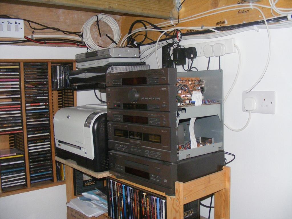

2 hours ago, Ferdinand said:
On this subject, what about paths for future internet and satellite TV etc?
Does anyone run those to the various potential media centres?
F
Yep, under my stairs.
All tv and satellite cables enter via a hockey sick built into the foundations which comes up in the under stair cupboard.
Still a work in progress but nearly there.
The hifi unit is in pieces as I am still awaiting the bluetooth receiver to incorporate into it so the girls can play their music from their phones.
Everyting is remote controlled, just out of shot high up on the left is the receiver part of a powermid IR extender set, this re generates IR remote controls and sends them to all the stuff shut in the cupboard.
CD storage built into the thickness of the stud wall.
The broadband wifi router is up in the ceiling structure of the half landing pretty much right above my head where I was taking the photo from, as near to the centre of the house as possible and seems to give a good wifi signal everywhere. I am only using the built in LAN ports on the router at the moment, but LAN cables is installed to each room and if I need to use more I will install a switch, again mounted high up out of the way.
Just out of shot to the right is the tv aerial distribution amplifier.
3 satellite receivers, the Sky HD box is the main one that will link directly to the 2 main tv's via long hdmi cables already built into the walls.  The sky mini box above that is essentially there just for satellite radio channels and it's audio links to the hifi. Above that is my "other satellite" receiver for Astra 1 and hotbird for such things as watching F1 live via the German channel RTL on the days when channel 4 are not showing it live here.
Network printer sits here out of the way can be accessed by wired or wireless lan from any computer.
This is all part of the strategy of keeping "clutter" out of the main rooms, without compromising quality, i.e. I still insist on a half decent hifi and decent speakers in each room, even though the unit itself is hidden away.
It has all taken up a lot less space than I thought, so there is still a good amount of useful storage space in the under stair cupboard.
Ha, well done Dave, never thought about the router under the stairs, perhaps next time ( not!).

I get a slight sense that you enjoyed explaining that little lot ??‍♀️?‍♀️?‍♀️?‍♀️.

In case it didn't prove good enough there, I have installed a phone and cat5 cable from the stair cupboard to where the coat and shoe cupboard will be in the entrance hall. That will give an alternative location for the router on a shelf high up by the ground floor ceiling.
On the subject of hiding stuff, a filing cabinet will be going in this cupboard.  By raising one of the dwangs a bit higher, the filing cabinet will recess into the thickness of the wall so it doesn't stick out too far which would otherwise make the coat and shoe cupboard too deep.
Our old hi-fi will go into the snug and stay there, no networking or anything.  OH and I don't share musical tastes and the snug is his for watching TV and listening to his music; as it is, he will need an entire wall for all his CDs and vinyl.  I will need some acoustic insulation in the walls of the snug.
