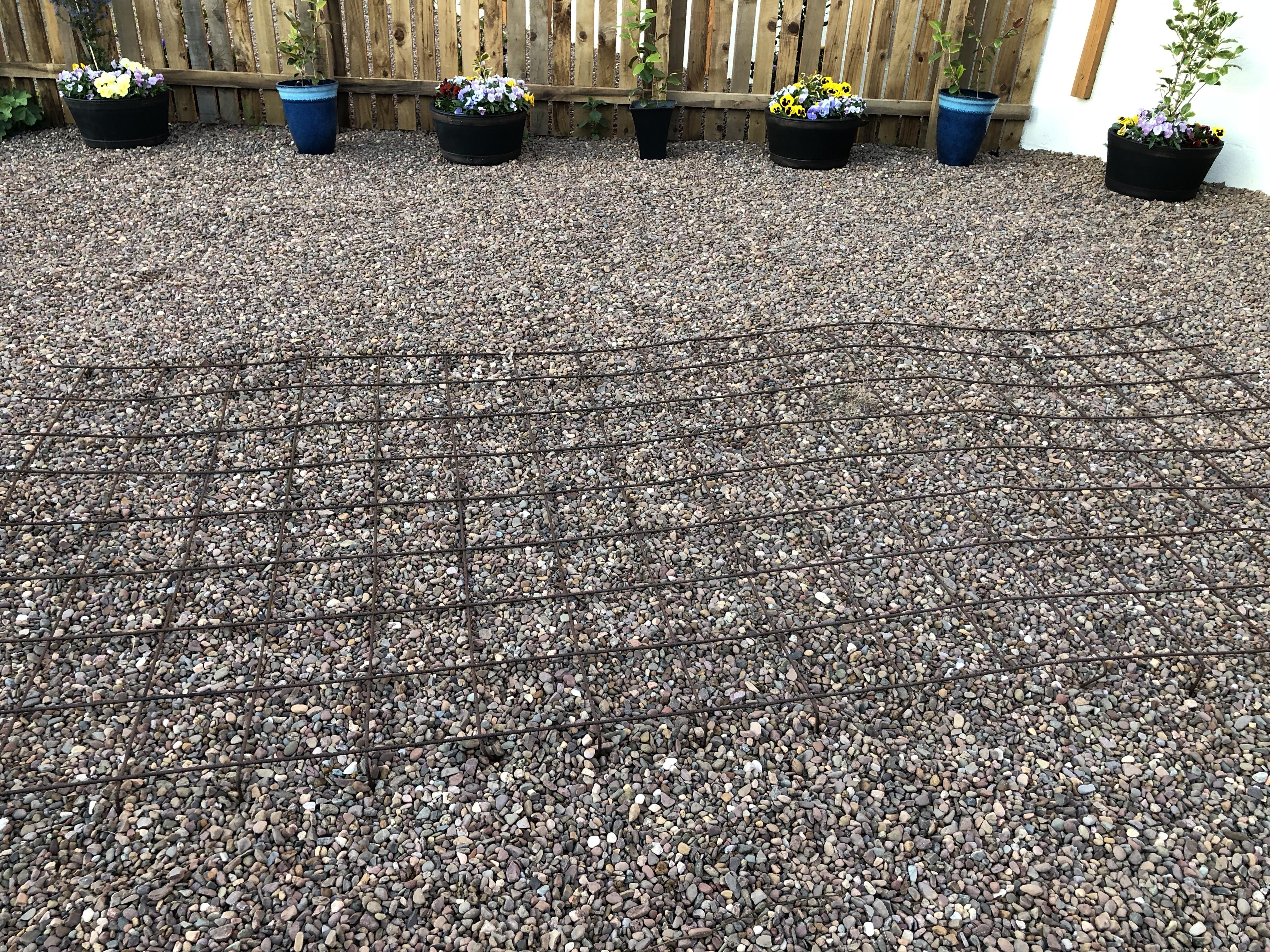

Roundtuit Posted May 29, 2018 Share Posted May 29, 2018 On 28/05/2018 at 21:40, newhome said: Need to take it to the tip so how can I chop it up? ie what can I use that isn’t dangerous? Angle grinder? Never used one before mind and don’t know if there is one here. What you have there is section of contemporary industrial-style trellis, aged to a rich brown patina. Screw it to the fence and break out the clematis! 4 1 Link to comment Share on other sites More sharing options...

newhome Posted May 30, 2018 Author Share Posted May 30, 2018 Going back to bolt cutters since no one has yet replied to my free ads to remove the mesh. What are the easiest bolt cutters to use? I only want a pretty cheap set and they do various ones on Amazon for pennies. Would this do the trick for example or do I need a longer / shorter / different type? https://www.amazon.co.uk/Blackspur-BC103-Bolt-Cutter/dp/B005EXLAZW/ref=sr_1_29?ie=UTF8&qid=1527720085&sr=8-29&keywords=bolt+cutters Link to comment Share on other sites More sharing options...
TerryE Posted May 30, 2018 Share Posted May 30, 2018 (edited) That set only has 3 reviews, one bad and one doesn't count so I'd give them a miss. I would go for a more expensive set such as the 450mm Draper ones. There are just some jobs where having decent cutters is just so useful. Also there is a knack to using them, such as taking two bites. Push the wire or rebar as far as possible into the jaws for the maximum leverage and squeeze in the handles. If this doesn't cut first time then it will cut into the sides and squeeze the cross-section more oval. Now open the jaws again and you can push the rebar further into the jaws for a second cut with more leverage. If you are cutting bolts or screws (useful if your screws are just too long and the points are braking through and you don't have a suitable smaller screw size), then the trick is to do a 2-cut but turn the bold / screw through 90° for the second cut so you end up with a more squared break. PS. If you are worried about strength then you might need to go for 600mm cutters, but they are also a but more heavy to manipulate. Edited May 30, 2018 by TerryE 1 Link to comment Share on other sites More sharing options...
newhome Posted May 30, 2018 Author Share Posted May 30, 2018 I think I’m more worried about strength than the weight of the cutters. I’m not a complete weakling but don’t really want to get some and struggle to cut anything with them. So longer makes it easier to cut then I guess. Another thing I’ve never done before! Link to comment Share on other sites More sharing options...
Ferdinand Posted May 31, 2018 Share Posted May 31, 2018 (edited) 7 hours ago, newhome said: I think I’m more worried about strength than the weight of the cutters. I’m not a complete weakling but don’t really want to get some and struggle to cut anything with them. So longer makes it easier to cut then I guess. Another thing I’ve never done before! I think I bought a 12” and a 24” set a couple of years ago, just to have the tools for when I lose padlock keys or have recalcitrant bits of cable that are a stretch for even big pliers or bolts. I guess I have used them 8 or 10 times since, even for things such as separating rusted studs. Will check which ones they were. F Edited May 31, 2018 by Ferdinand 1 Link to comment Share on other sites More sharing options...

newhome Posted June 2, 2018 Author Share Posted June 2, 2018 So I didn't buy a bolt cutter as someone said they would take it. I waited in all morning and into the afternoon for them to turn up having told them the size of it and specifically said that they needed a suitable vehicle. They drove from Galashiels which is about a 2 hour round trip (I would have thought the cost of the fuel would be more than the mesh is worth?). And they turn up in a car!!! No roof rack. They thought it would fit inside a Pajero FGS . He said he wanted it for a dog guard and couldn't visualise the size, and thought it looked small from the photo (really??!). So now I'm tempted by @Roundtuit's trellis suggestion. Reckon I could cut it into 3 or 4 bits and either use it for that or at least I could get it down the tip in smaller bits. Link to comment Share on other sites More sharing options...
ProDave Posted June 2, 2018 Share Posted June 2, 2018 Another way to get rid of stuff is put it by your gate with a price tag on, say £10 It will probably be gone next morning. 1 Link to comment Share on other sites More sharing options...
newhome Posted June 3, 2018 Author Share Posted June 3, 2018 2 more people wanted it but only had cars (I double checked how they expected to collect it this time). They either have very poor judgement of their car size relative to the mesh size or they think it will roll up somehow. Anyway, bored with that and my neighbour is now going to get shot of it for me. 1 Link to comment Share on other sites More sharing options...
