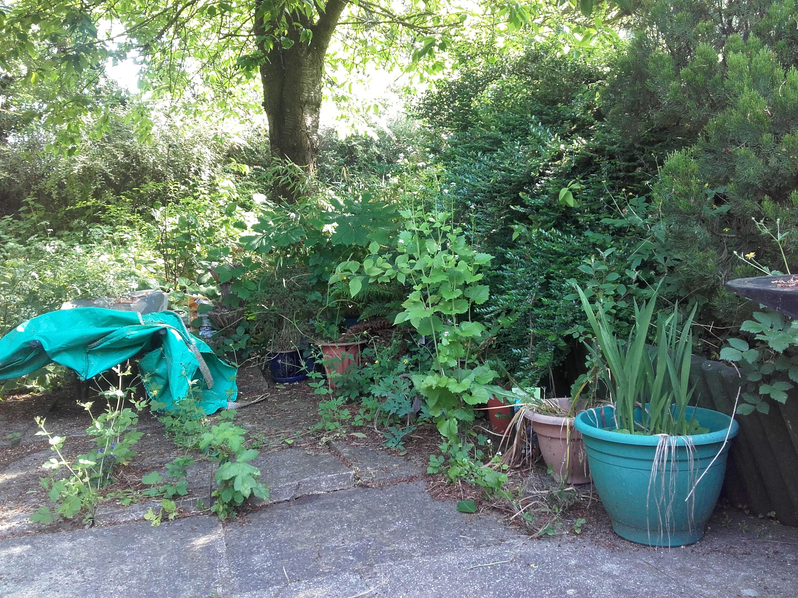

Onoff Posted May 28, 2018 Author Posted May 28, 2018 4 minutes ago, daiking said: Clearly, you should continue making justifiable improvements to the fabric of the building but leave the rest of it alone. I can't! Take the back patio. Seemingly formed by casting concrete slabs in situ, it slopes towards the house rather than away from it! The cherry tree in the background is lifting it too: We keep saying "we'll give it another year" then the bloody thing comes back with more fruit than ever and the birds love it.
