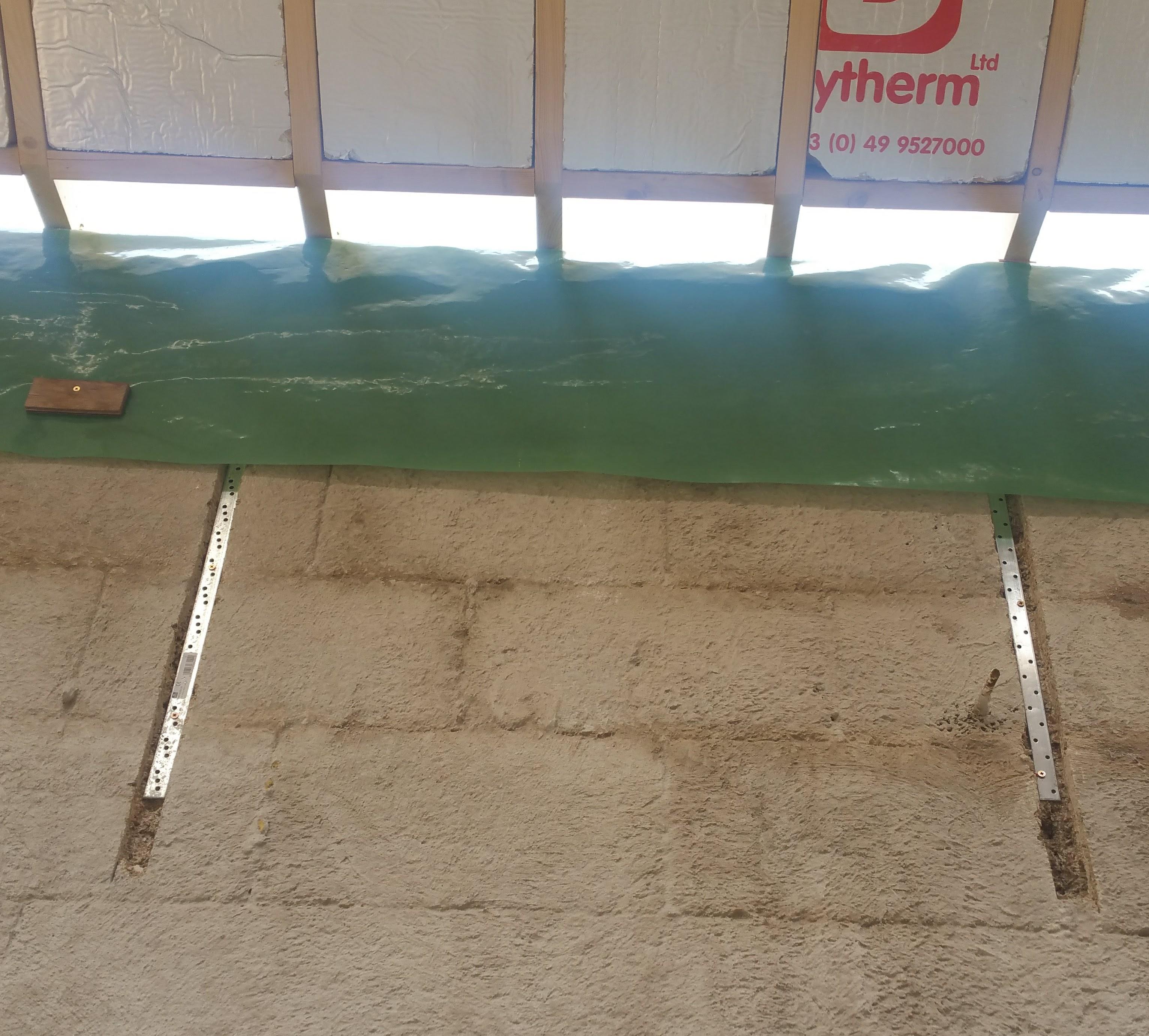

ToughButterCup Posted May 17, 2018 Posted May 17, 2018 Wallplate fitted, ridge beam fitted (nearly), rafters up, insulation fitted in between. Who's a clever boy then? ? Maybe over-worried about fixing the wall straps through to the concrete, I chased the Durisol back to the concrete and fitted the wall straps direct to it. This is where we are now (looking up from the floor); I need to make good on top of the wall straps. Which ? Foam, Durisol, Sand and Cement? (Can't Avoid.... )

joe90 Posted May 17, 2018 Posted May 17, 2018 Well done Ian, remember the hare and the tortoise, plus better to do it slowly and properly, if you rush you make mistakes and these are even harder to put right. From my perspective I wanted to enjoy my build ( which I have mostly) and so must you if possible, oh and yes, foam.
CC45 Posted May 17, 2018 Posted May 17, 2018 board adhesive - my skimmer seems to use Q a bit of this to create curves etc. He also adds a bit of cement into it - speeds up drying aparently. Looking good.
Nickfromwales Posted May 17, 2018 Posted May 17, 2018 Wet board adhesive may promote early corrosion of the metal, even though it's galv. Foam for me
