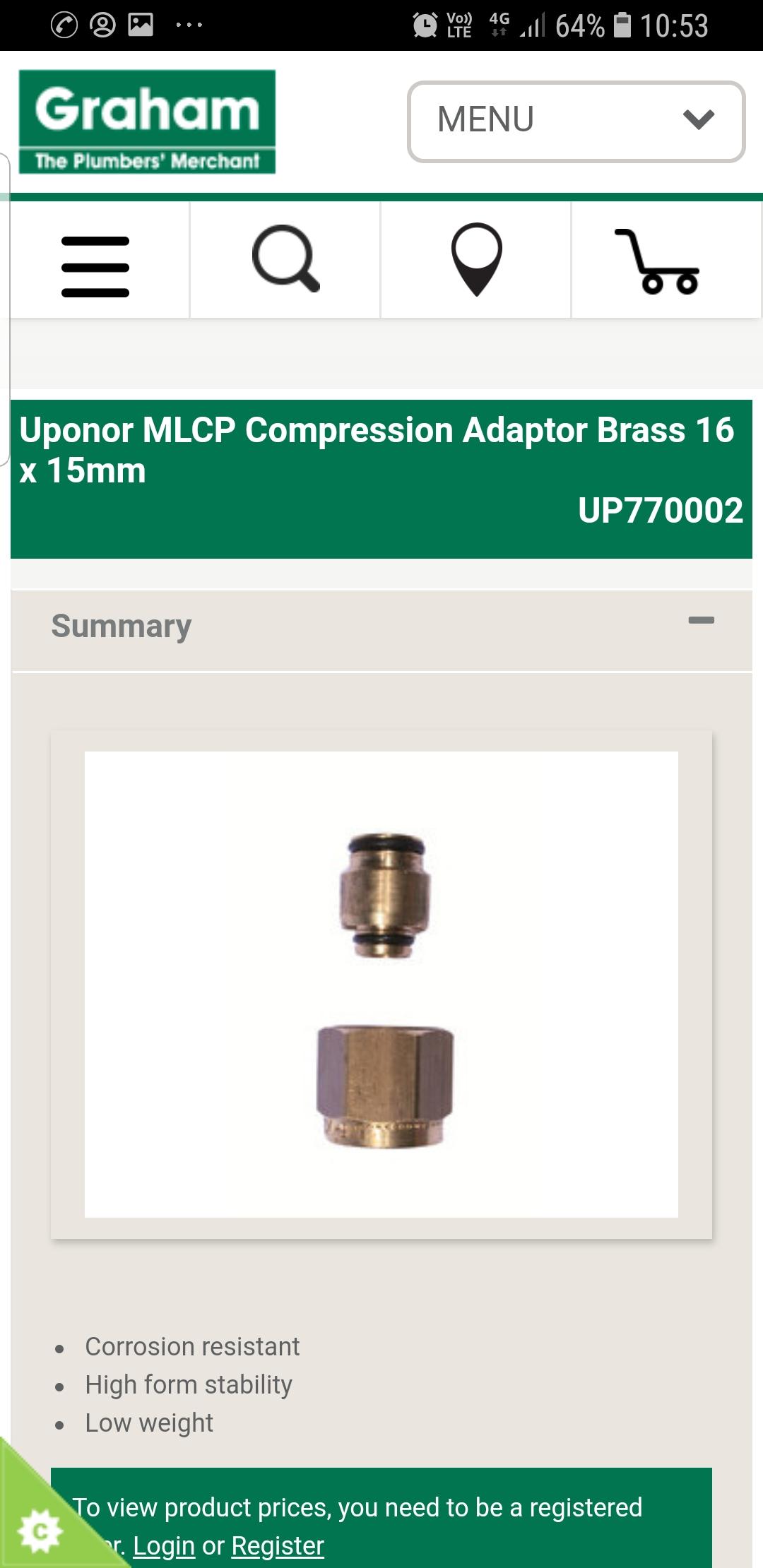

Alexphd1 Posted May 16, 2018 Share Posted May 16, 2018 (edited) Regarding 15 v 16mm as mentioned above. No reason why you can't use 16mm mlcp for domestic water but probably will need to use standard compression fittings plus a adaptor. You also get them in chrome. Roughly £1 each. Edited May 16, 2018 by Alexphd1 Link to comment Share on other sites More sharing options...
PeterW Posted May 16, 2018 Share Posted May 16, 2018 6 minutes ago, Alexphd1 said: Regarding 15 v 16mm as mentioned above. No reason why you can't use 16mm mlcp for domestic water but probably will need to use standard compression fittings plus a adaptor. You also get them in chrome. Roughly £1 each. I think they are the wrong way round - that’s for putting 15mm pipe into 16mm fittings. Link to comment Share on other sites More sharing options...
Alexphd1 Posted May 16, 2018 Share Posted May 16, 2018 1 hour ago, PeterW said: I think they are the wrong way round - that’s for putting 15mm pipe into 16mm fittings. Better not be..... or I am buggered, lot of unhappy customers.. I have been using them to join mlcp to brass compression for last 15 years. 1 Link to comment Share on other sites More sharing options...
PeterW Posted May 16, 2018 Share Posted May 16, 2018 30 minutes ago, Alexphd1 said: Better not be..... or I am buggered, lot of unhappy customers.. I have been using them to join mlcp to brass compression for last 15 years. Yep my bad - they are different to the ones I've used as they only have the one O ring. 2 Link to comment Share on other sites More sharing options...

Onoff Posted May 16, 2018 Share Posted May 16, 2018 The 15mm copper to 16mm pex al pex elbows I've used: Link to comment Share on other sites More sharing options...
ProDave Posted May 16, 2018 Author Share Posted May 16, 2018 ^^ TP sell that adaptor and it fits any 15mm compression fitting, straight, elbow or tee. Link to comment Share on other sites More sharing options...
