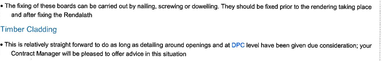

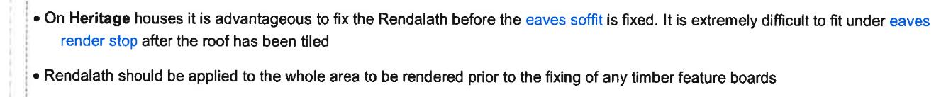

PeterW Posted July 13, 2018 Share Posted July 13, 2018 Ok The “architect” at Potton hasn’t even read his own spec as it recommends to use pre-bagged render and not sand and cement. Those instructions also say you have to fix the Rendalath or similar before the roof is fixed ..?? When are you roofing as it says to do it before the eaves boards are fitted. @nod do you know where to get Rendalath or one of the render carriers from at a decent price ..?? Link to comment Share on other sites More sharing options...

PeterW Posted July 13, 2018 Share Posted July 13, 2018 Looks lovely... how do you fit the render stop under those eaves..?? from the Potton builders guide So either Potton or their appointed contractor has it incorrect..? And this states Rendalath first then timber detail boards before render It also mentions Potton Contract Manager - who’s that and where are they in all this ..?? Does he arrive on a unicorn at the stroke of midnight ..?? Link to comment Share on other sites More sharing options...

nod Posted July 13, 2018 Share Posted July 13, 2018 2 hours ago, PeterW said: Ok The “architect” at Potton hasn’t even read his own spec as it recommends to use pre-bagged render and not sand and cement. Those instructions also say you have to fix the Rendalath or similar before the roof is fixed ..?? When are you roofing as it says to do it before the eaves boards are fitted. @nod do you know where to get Rendalath or one of the render carriers from at a decent price ..?? Hi looking back at my invoices The last lot we bought was from Encon about six weeks back We bought 300 mtrs at £9 per mtr that was Naufe 2.4 x900 sheets These are the best ones to use But we are stuck with what the Architect species Always fixed after the roof The odd job we have done before the roof is completed Useally gets damaged by other trades It needs to be glades then finished Scafold down No arguements over any damage Link to comment Share on other sites More sharing options...
PeterW Posted July 13, 2018 Share Posted July 13, 2018 Thanks @nod How would you finish the render detail under all of those rafter tails ..?? Link to comment Share on other sites More sharing options...
