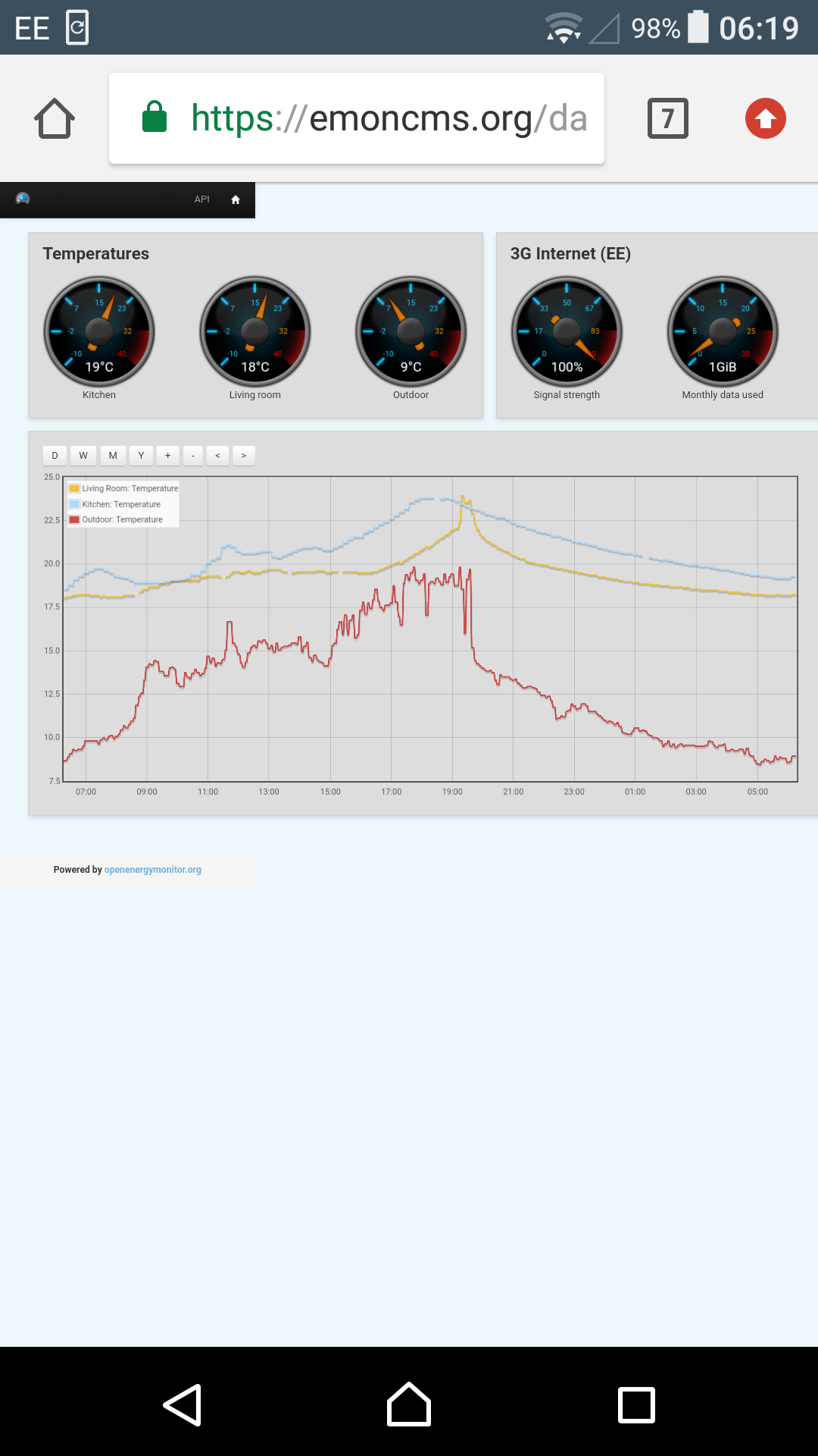

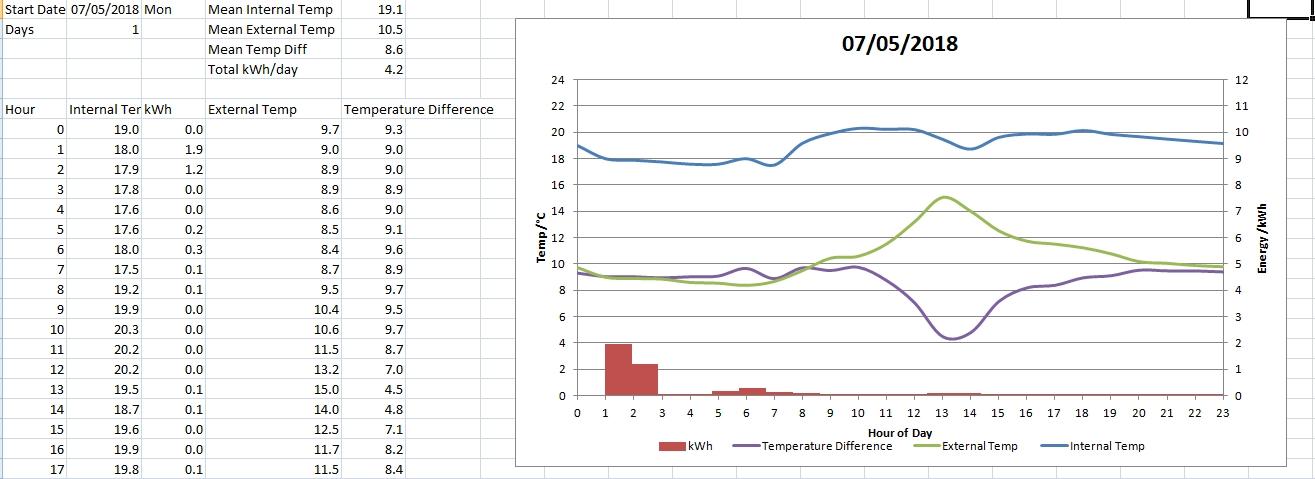

jamiehamy Posted May 8, 2018 Posted May 8, 2018 Do you know what the external air temperature has been day and night @lizzie? In hot weather, particularly sunny days, it will be very easy for things to get out if hand. There is nothing wrong with opening windows, particularly at night and let air flow up, through and out the house and the cool air circulate. If the air temperature is high however then there is little you can do. If it's solar gain but less extreme air temperature, then blinds will help, but also leave that window open to let the heat out rather than into the room. I've been watching our house the last few days where it has been very sunny. Doing okay, but will need careful management. If it gets too warm, plan will be to open two windows upstairs and one down to let warm air out and cool air in. Looking at graphs, we might need to start doing that soon. Overall air trips are fine with no heating input but likely to trend up at which point proactive e management is required. (btw, kitchen is south facing with 2m2 window and 2m2 Skylight both with solar glazing. Living room is actually bedroom which faces west (8m2 window) and North (1.5m2)). You can see how much our bedroom heats up when sun gets round in evening).
lizzie Posted May 8, 2018 Author Posted May 8, 2018 Yes windows on east and north side open. It was reading 30+ on terrace outside south and west where all the big sliders are even so i kept some open in shaded area to encourage through draught. I’m afraid nothing worked. However @Nickfromwales advice to adjust mvhr has had an impact this morning with living area readings at 24 and bedroom at 26 which is positively arctic compared to last few days. 1
lizzie Posted May 8, 2018 Author Posted May 8, 2018 @jamiehamy that is really useful info. I hope I might get some sort of similar data when they come back to set everything up at the moment I only have the room thermostats for ufh giving air temp plus my own stand alone weatherstations from previous house. Both have been giving the same temps so look accurate. Thank you for the advice.
