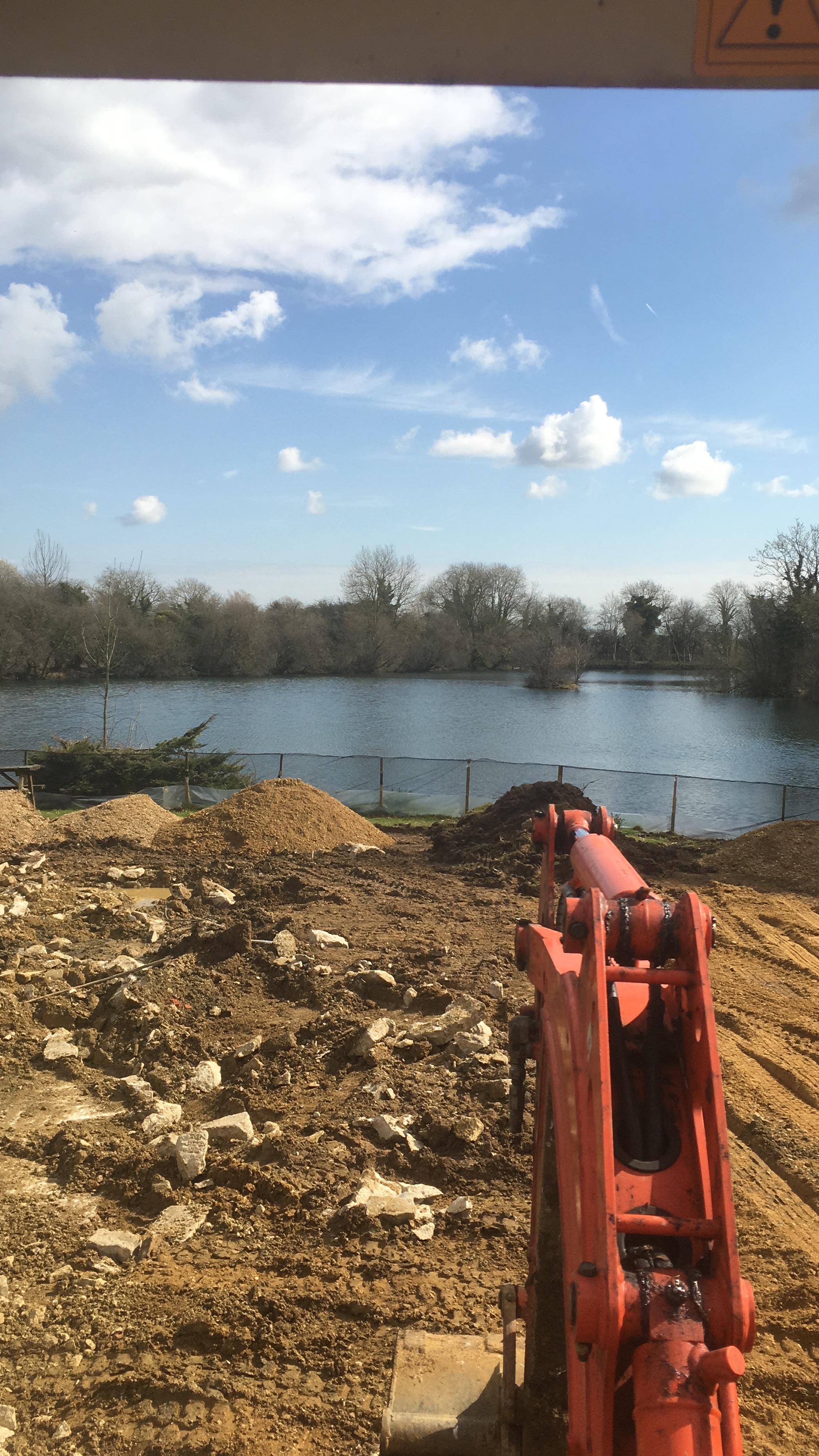

Russell griffiths Posted April 29, 2018 Author Posted April 29, 2018 (edited) Ok, here are they problems I’ve got to over come. If you look at the pic you will see the big wet thing, that’s our lake just to the back of our plot. The closest part of the house is 2.4m from the wet bit we had a flood risk assessment which said the floor level needed to be set up in the air, which is fine, but it is a fair bit above the original ground level, so lifting it any higher I would like to avoid but will if necessary. Floor build up from top down. 20mm tiles and adhesive 75mm structural concrete topping ufh fixed to eps 200mm eps insulation 175mm floor beams 175mm void top of ring beam piles. So with this makeup it puts the top of the ringbeam 650mm below finish floor level, which puts it just above the wet bit i have excavated down to this level and I’m still dry but I’m really not wanting to dig down any further, as no amount of pumping will keep the gazillions of litres of water at bay. What i need to achieve is get the floor makeup thinner so I can keep from excavating down. Edited April 29, 2018 by Russell griffiths

Nickfromwales Posted April 29, 2018 Posted April 29, 2018 5 hours ago, Russell griffiths said: Ok, here are they problems I’ve got to over come. If you look at the pic you will see the big wet thing, that’s our lake just to the back of our plot. The closest part of the house is 2.4m from the wet bit we had a flood risk assessment which said the floor level needed to be set up in the air, which is fine, but it is a fair bit above the original ground level, so lifting it any higher I would like to avoid but will if necessary. Floor build up from top down. 20mm tiles and adhesive 75mm structural concrete topping ufh fixed to eps 200mm eps insulation 175mm floor beams 175mm void top of ring beam piles. So with this makeup it puts the top of the ringbeam 650mm below finish floor level, which puts it just above the wet bit i have excavated down to this level and I’m still dry but I’m really not wanting to dig down any further, as no amount of pumping will keep the gazillions of litres of water at bay. What i need to achieve is get the floor makeup thinner so I can keep from excavating down. Why not do away with the concrete layer, change to higher performing 200kpa insulation and go for an overlay UFH solution integrating it into the 200mm? Would save you 75mm. The insulation can all be bonded down so theres no bounce, and the stud work would sit quite happily on bonded 22mm P5. Why the structural element to the concrete layer? Do you have to transfer weight down to the subfloor?

Russell griffiths Posted April 29, 2018 Author Posted April 29, 2018 The reason for the concrete topping is I like a solid feel to things, whole house will be tiled so not really interested in timber, ive just spent a couple of hours with a laser level and tape and I think by decreasing the gap under the floor to 150mm, using a 150mm beams and going for a better insulation so I can decrease the thickness, I think I can keep from having to dig down anymore so this weeks panic over thanks for all the input. ? 1
