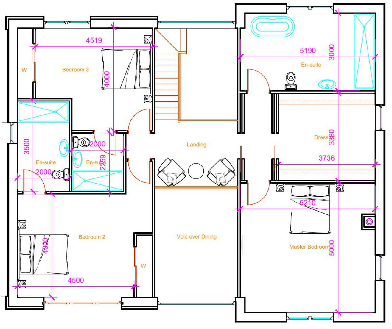

ultramods Posted April 28, 2018 Posted April 28, 2018 (edited) Can anyone tell me if these plumbing costs seam reasonable please? We only received two quotes for the plumbing, one at 27k and the other at 20k. To me it looks like the majority of the 20k is labour costs, roughly 45 days @ £40 per hour. Would it really take that long? We are providing all sanitaryware, taps, kitchen + utility sinks, showers, shower screens and upstairs radiators. Edited April 28, 2018 by ultramods

epsilonGreedy Posted April 28, 2018 Posted April 28, 2018 According to the latest issue of the house builders bible the reference model house of 160 m2 has about £12k of costs covering heting, plumbing and bathroom aspects of the build. Those model house costs do not include guttering, underfloor heating or warranty. Also some plumbing costs are attributed to named rooms so my £12k approximation could be out by +10%. The author of the book takes a no nonsense nothing fancy approach in his model house. Given additional bathrooms and your larger property I reckon your quotes are reasonable. His labour costs are about 35% which could indicate you are being quoted for bargain basement fittings particularly in the bathrooms. 1

Nickfromwales Posted April 28, 2018 Posted April 28, 2018 I think they're just referring to normal soldered joints. If it were different it would say push-fit / press-fit / compression, but the method of soldering copper joints uses what we call "end-feed" fittings ( just regular copper joints to you and I ) so that what I believe they are offering. E.g. a pukka job. £20k for that doesn't sound crazy tbh, but very strange for a plumber to quote the guttering. Lead maybe but again a bit odd. Who is actually going to do that work ? The plumber or a sub-contractor ? If the latter then can't you get quotes direct to you instead of via a 3rd party? 6 minutes ago, epsilonGreedy said: Given additional bathrooms and your larger property I reckon your quotes are reasonable. His labour costs are about 35% which could indicate you are being quoted for bargain basement fittings particularly in the bathrooms. Ultra mods beat me to it, not in the quote so labour is a LOT of the quote. Just now, ultramods said: @ £40 per hour this would be 45 days labour, would it really take 1 plumber that long? Where did you get the £45 figure? 1

epsilonGreedy Posted April 28, 2018 Posted April 28, 2018 6 minutes ago, ultramods said: We are providing all sanitaryware, taps, kitchen/utility sink, showers, shower screens and upstairs radiators. That throws out my attempt to compare your costs with the HBB's model house. He quotes £4,800 per bathroom comprised of £1,700 labour and £3,100 materials. The HBB also provides a fine grained breakdown of contributory costs which you could use to produce a ground up budget though no doubt @recoveringacademicwill be along in a moment to talk about the wonders of SPONS. 1

recoveringbuilder Posted April 28, 2018 Posted April 28, 2018 (edited) We are doing a 260m2 1.5storey house, 3 ensuites , bathroom and wc, underfloor heating downstairs, radiators upstairs a thermal store tank, oil boiler, u/f heating supply and fit by company 3850, we are supplying everything else, tank boiler radiators all bathroom fittings, kitchen sink and all pipe work plumber on a labour only price £5900. Roofer Will do lead work gutters etc Edited April 28, 2018 by Christine Walker 1

Nickfromwales Posted April 28, 2018 Posted April 28, 2018 Just now, ultramods said: thanks @Nickfromwales. I have already had a quote from Wunda. So do you think the 20k quote sounds reasonable for the work? It's an unanswerable question because of the quote being made up of mixed disciplines TBH. Ask for a quote for the oddities and the plumbing etc as two separate items and then we can work out what's what. Architects are wonderful folk, but when they put things out to tender it's usually via the straightest route. Not always the best route. 1 1
