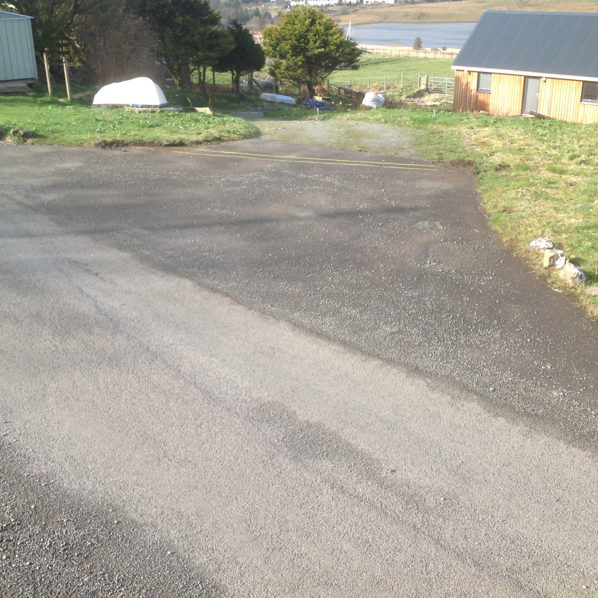

Crofter Posted April 18, 2018 Author Posted April 18, 2018 Ok as promised a pic of the affected area:

Crofter Posted April 18, 2018 Author Posted April 18, 2018 Some interesting options for digging a channel in, thanks. I might well need to have one or two channels further down the drive on the stone surface area. Not feeling a whole lot of love for my cold tar idea from the forum... But I'm loath to cut down into the relatively thin tar of the bellmouth, as I think it will leave a small and weakened strip on the downhill side. Has anybody here actually worked with cold tar?
