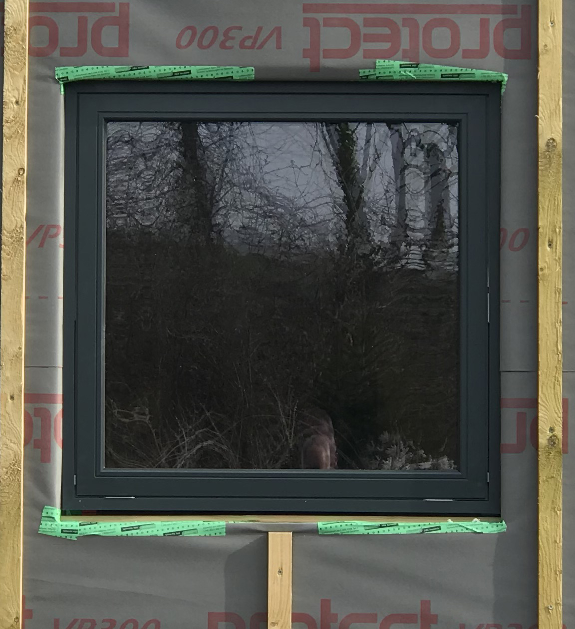

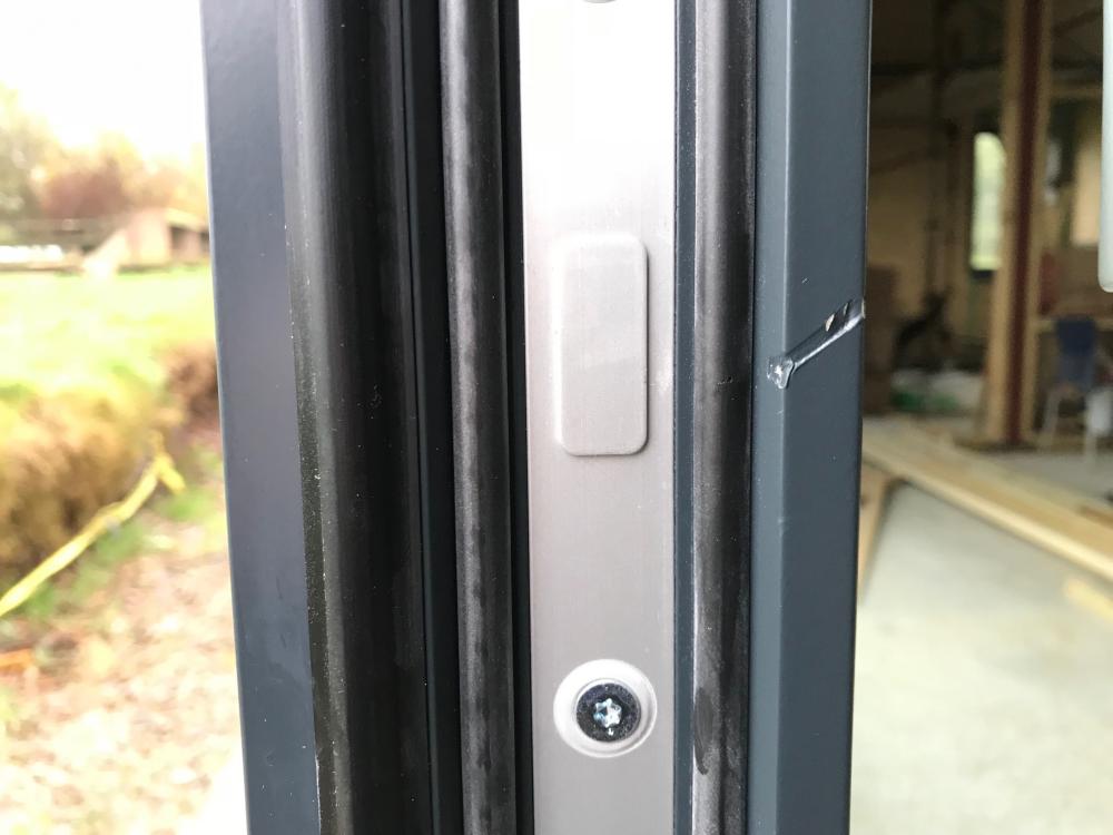

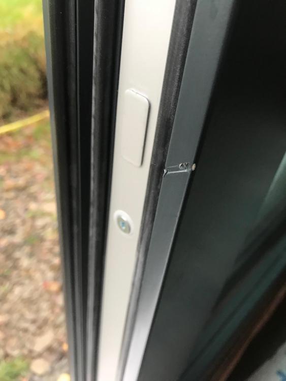

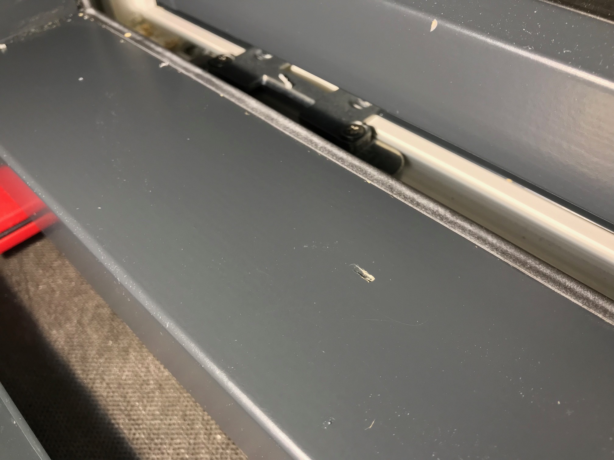

Nestor Posted April 10, 2018 Posted April 10, 2018 Advice appreciated. Doors and windows installed and a few scars to resolve. Doors and windows are Kastrup and the the 4m slider is Internorm. All 3G. Firstly, the glass in one of the windows appears to have roller marks about 150mm wide down each side. This makes the glass appear very wavey and distorted. Only visible from outside. The slider has a deep gauge on the face of the opening slider. Gauge and dents in 2 of the timber frames. I have sent an email and photos to the installers and await a reply. @lizzie @Barney12

PeterW Posted April 10, 2018 Posted April 10, 2018 Unit needs replacing - that is a heat stress / roller mark from manufacture so the unit isn’t up to standard. All the rest rest could be fixed by Magic Man - tbh I would get the unit changed, check they are all water and air tight and then get magic man in at the end to fix the issues and agree the cost will be covered by the fitting company. Having a window fitter touch up those scratches would be like having your car repainted with a 9” roller .... 1

lizzie Posted April 10, 2018 Posted April 10, 2018 (edited) All ours were Internorm so don't know about Kastrup but I would not accept that glass. I have to get magic man in at the end, have scrapes and dings inside and out. Not installers just building site dings. Thankfully all our sliders are now watertight after more than 6 months of leaks and being given the run around by installers.. Rubbish installers ........when I eventually contacted them direct Internorm were very helpful in getting it sorted out. As PeterW says check them all over for water and air tight too.. I would not pay your installers the full balance, make a retention otherwise you will have a really hard time trying to get them to pay magic man or for anything else needed. Thankfully I made a retention on mine and in the end I used that to pay for the install rectification work specified by Internorm. Edited April 10, 2018 by lizzie 1
Nestor Posted April 10, 2018 Author Posted April 10, 2018 17 minutes ago, recoveringacademic said: Have you paid the installers yet? 90% has been paid. Terms and conditions stipulated payments before fitting. 8 minutes ago, PeterW said: Unit needs replacing - that is a heat stress / roller mark from manufacture so the unit isn’t up to standard. All the rest rest could be fixed by Magic Man - tbh I would get the unit changed, check they are all water and air tight and then get magic man in at the end to fix the issues and agree the cost will be covered by the fitting company. Having a window fitter touch up those scratches would be like having your car repainted with a 9” roller .... Yes, Heat stress / roller mark. Not sure why it would leave the factory like this, its so obvious. Thanks for Magicman.

nod Posted April 10, 2018 Posted April 10, 2018 1 hour ago, JamesP said: Advice appreciated. Doors and windows installed and a few scars to resolve. Doors and windows are Kastrup and the the 4m slider is Internorm. All 3G. Firstly, the glass in one of the windows appears to have roller marks about 150mm wide down each side. This makes the glass appear very wavey and distorted. Only visible from outside. The slider has a deep gauge on the face of the opening slider. Gauge and dents in 2 of the timber frames. I have sent an email and photos to the installers and await a reply. @lizzie @Barney12 I would insist that all frames with damage are replace Magic man is good If you or one of your other trades had caused the damage Why accept a repair Would take delivery of a new car and then cont chips away to sort out chips and scratches

Nestor Posted April 13, 2018 Author Posted April 13, 2018 On 4/10/2018 at 22:40, ProDave said: At least it's "one person's" problem you paid for supply and fit, so it does not matter to you whether they were damaged in deliver or in installation. Have you paid the final payment? I hope not as that's your position of power to get it sorted. Final payment not made. So far they have recognised all the issues and will keep you informed of progress. Might take a while. 1
