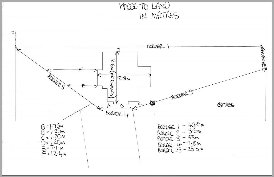

Ed_MK Posted April 8, 2018 Author Posted April 8, 2018 (edited) Well, i need to get some alternative to the Mains sewer..because it looks like that won't be a financially achievable unless i leave the roof off I have a drawing of my land and house, with measurements Border 2, 3, and 5 are neighbours Border 4 is family and Border 1 is along a 25 foot across rough grass and hawthorn border ...until it reaches the road So I am looking for a Rainwater soakaway and a Sewage Solution in my spare area. I was going to put the rainwater crates in the middle of the back garden 5m from sunroom. But now if i have to squeeze another gravel pit .....it might be tight. what is a shame too is that the grass is lovely meadow grass ...and looks great... ..but ii suppose thats development PS I know the measurements for Border 3 is cocked up ..the rest are OK I think B3 should be 23m ...i was measureing in the rain with a blunt pencil Edited April 8, 2018 by Ed_MK
markruth Posted April 8, 2018 Posted April 8, 2018 We are putting a treatment plant into our build, the important thing is percolation tests to be carried our on your land, this will determine the length of soakaway and more importantly if your ground is porous enough, this was a requirement for the environment agency
ProDave Posted April 8, 2018 Posted April 8, 2018 Anyone looked up the English Building Regs clearance distances yet? Without that we can't proceed. Another alternative we looked at is the Puraflow system. http://www.symbiotictrading.com/products/puraflo/ This discharges the effluent into containers full of peat and it filters out of the bottom. They are laid on a bed of stones and gravel so what drains out soaks into the ground. They can either be buried or sat on the surface in that case acting like a packaged filter mound. When we looked that solution would fit the very small amount of space we had available, we would have needed 2 crates of peat for our 3 bedroom house and the percolation rate of our soil. But for some unspecified reason building control rejected it, and at that point SEPA granted us a permit to discharge into the burn so we stopped looking at surface discharge. Can you find out who owns the 25ft border between you and the road? and see if you can get permission to put the soakaway under there. This is quite common up here, indeed the soakaway for our old house is under the field behind it. 1

ProDave Posted April 8, 2018 Posted April 8, 2018 From the above link: The main provisions of these regulations are: The Sewage Treatment Plant must be sited more than 7m from habitable property The soakaway must be a minimum of 10 metres from a watercourse, 15 metres from a building and 50 metres from a borehole or spring. The soakaway must be designed to BS6297: 2007 and all percolation test results must be submitted. The discharge point shall be more than 10m from habitable property If the discharge is to a soak away a sampling chamber must be provided before the soak away. These are available from WTE Ltd.. Soakaway drains must be constructed in the aerobic soil layer, i.e. within 700mm. of ground level. So the plant must be 7M behind the house but the soakaway must be 15M behind the house. No mention of distance from boundaries, but check the 15M to the adjacent properties, depends how long their back gardens are (hopefully at least 15 metres) If you can go up to your boundaries (check with BC) you will have roughly 15 metres by 5.5 metres, widening a bit towards the house. That's something like 80 square metres available, which I am sure is plenty (our previous 5 bedroom house needed 85 square metres) The crucial thing to look up to confirm that is whether you can indeed install the soakaway right up to your boundary
Gone West Posted April 8, 2018 Posted April 8, 2018 10 minutes ago, ProDave said: The crucial thing to look up to confirm that is whether you can indeed install the soakaway right up to your boundary My reedbeds are right next to my boundary as is the soakaway from the reedbeds and the BCO was happy with the layout.
Jeremy Harris Posted April 8, 2018 Posted April 8, 2018 I got away with having our treatment plant around 1m from the boundary without any quibble from building control. They agreed with me that as the discharge was going into the adjacent stream, there was no point in trying to locate the unit 7m away, which would have placed it in the centre of our lawn. The general feeling I got was that there was no real concern about treatment plant placement, as they knew that, unlike old cess pits, there's no perceptible odour problem from these things. I'm pretty sure the "7m rule" dates way back to the time before we had treatment plants, so it's well worth having a chat with your BCO, explaining the compromises you need to make and seeing if they are sympathetic to your problems. If you're lucky, as we were, then there won't be a problem.

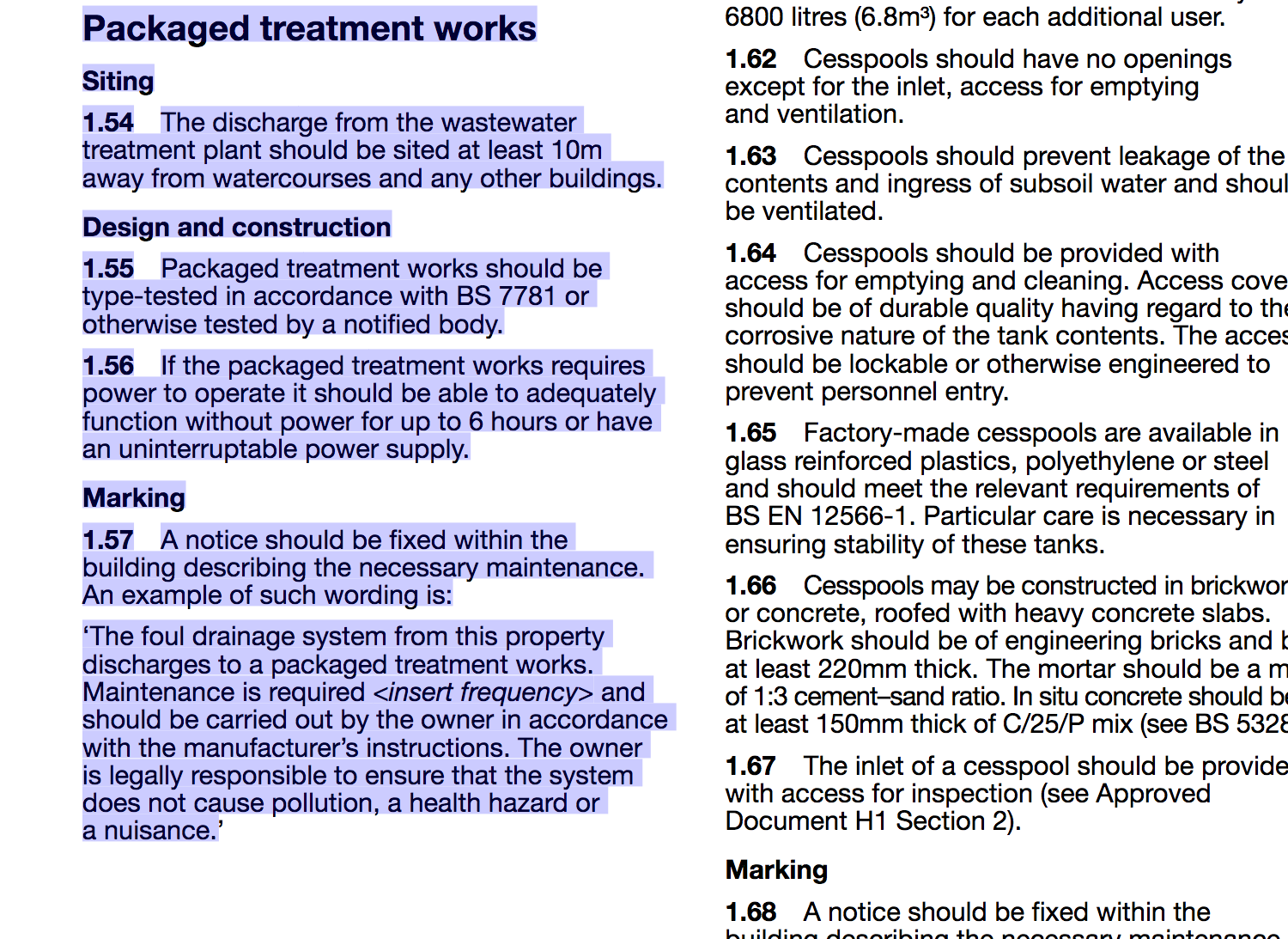

bissoejosh Posted April 8, 2018 Posted April 8, 2018 When I looked into this I found the regs fail as the two rules regarding septic tanks and treatment plants don't match up. The 7 meter rule applies specifically to septic tanks and not packaged treatment plants in terms of the tank/plant location - in theory the treatment plant could be right next to the house unless I've misunderstood. Under the treatment plant 1.54 regs state discharge water should be 10m from any building / watercourse with no mention of boundaries. However 1.27c which regards drainage for septic tank mounds claims 15m from any building so unclear. In summary I rang our BCO, explained it didn't make sense - he agreed and we've come to a sensible conclusion that works for everyone as per @JSHarris comment above.
joe90 Posted April 8, 2018 Posted April 8, 2018 9 minutes ago, bissoejosh said: When I looked into this I found the regs fail as the two rules regarding septic tanks and treatment plants don't match up. The 7 meter rule applies specifically to septic tanks and not packaged treatment plants in terms of the tank/plant location - in theory the treatment plant could be right next to the house unless I've misunderstood. Under the treatment plant 1.54 regs state discharge water should be 10m from any building / watercourse with no mention of boundaries. However 1.27c which regards drainage for septic tank mounds claims 15m from any building so unclear. In summary I rang our BCO, explained it didn't make sense - he agreed and we've come to a sensible conclusion that works for everyone as per @JSHarris comment above. Gosh that is interesting, my treatment plant is 7mtrs from our build as I understood that to be correct, it discharges ( via a rumble drain) into a ditch that’s running for 10months of the year, ( however I am yet to get the ok from the envoironment agency ?).
bissoejosh Posted April 8, 2018 Posted April 8, 2018 (edited) Unless I've misunderstood the regs all I can see specifically about treatment plants is shown and highlighted on the attached screenshot. The various discharge rules are scattered between septic tanks and soak away sections. Edited April 8, 2018 by bissoejosh
joe90 Posted April 8, 2018 Posted April 8, 2018 But how come Jeremy,s discharges to a watercourse and mine to a wet ditch?
Jeremy Harris Posted April 8, 2018 Posted April 8, 2018 5 minutes ago, joe90 said: But how come Jeremy,s discharges to a watercourse and mine to a wet ditch? I had this discussion with the BCO. His view was that as the EA had given me a consent to discharge to the watercourse it made this section void.............
ProDave Posted April 8, 2018 Posted April 8, 2018 The rules do seem confusing and do vary a LOT between Scotland and England. At the end of the day, you can only install what your building control officer will agree to, and it does seem he has some flexibility. So in this case I would approach my BC officer with a proposal to site the treatment plant 5M from the house discharging into a soakaway that starts almost immediately the other side of the treatment plant (allowing room for a sample chamber) and see what he says. You still need that percolation test to determine the size of the soakaway and therefore how close you need to go to the boundary to achieve that area. Up here a treatment plant must be 10 metres from a watercourse, yet my neighbour (of our old house) has installed one just 2 metres from the burn. It has not been completed and signed off, so I still don't know if this has been agreed with BC or if he is going to get a nasty disappointment.
