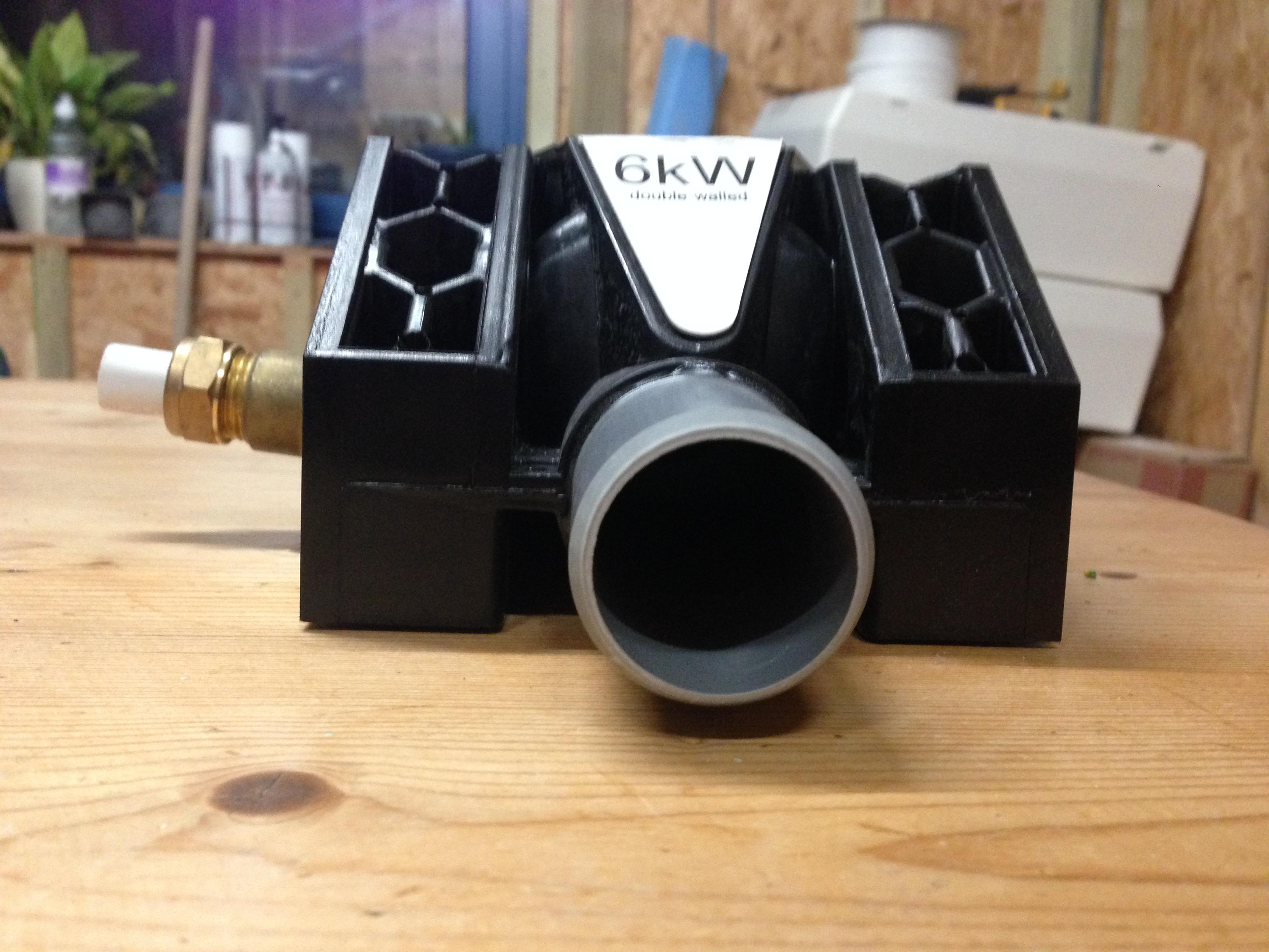

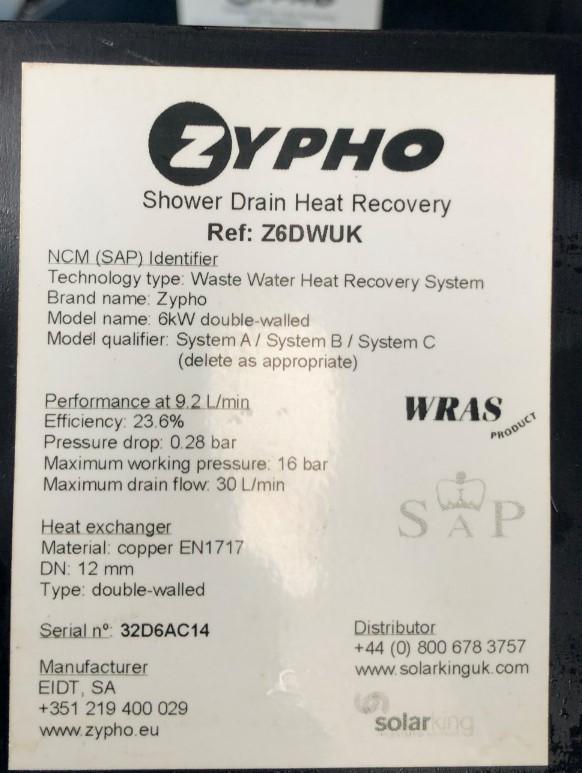

Rhauri Posted January 6, 2020 Posted January 6, 2020 Hi, For our self build project that we are now living in, I bought 3 Zypho shower heat exchange units. The end floor construction and shower tray choices meant they never got installed. Interesting to read that these are now being sold for over £1,000 each ! We paid a bit over £200 for each of them. Anybody want all 3 for £250 + £25 to post (or come and collect them, I'm in Cornwall). - better than landfill and I hope somebody can make good use of them re their energy bills. I've got plenty of photos of them. Rory
Rhauri Posted January 6, 2020 Posted January 6, 2020 Some photos that might help. I have more if anybody is interested.
