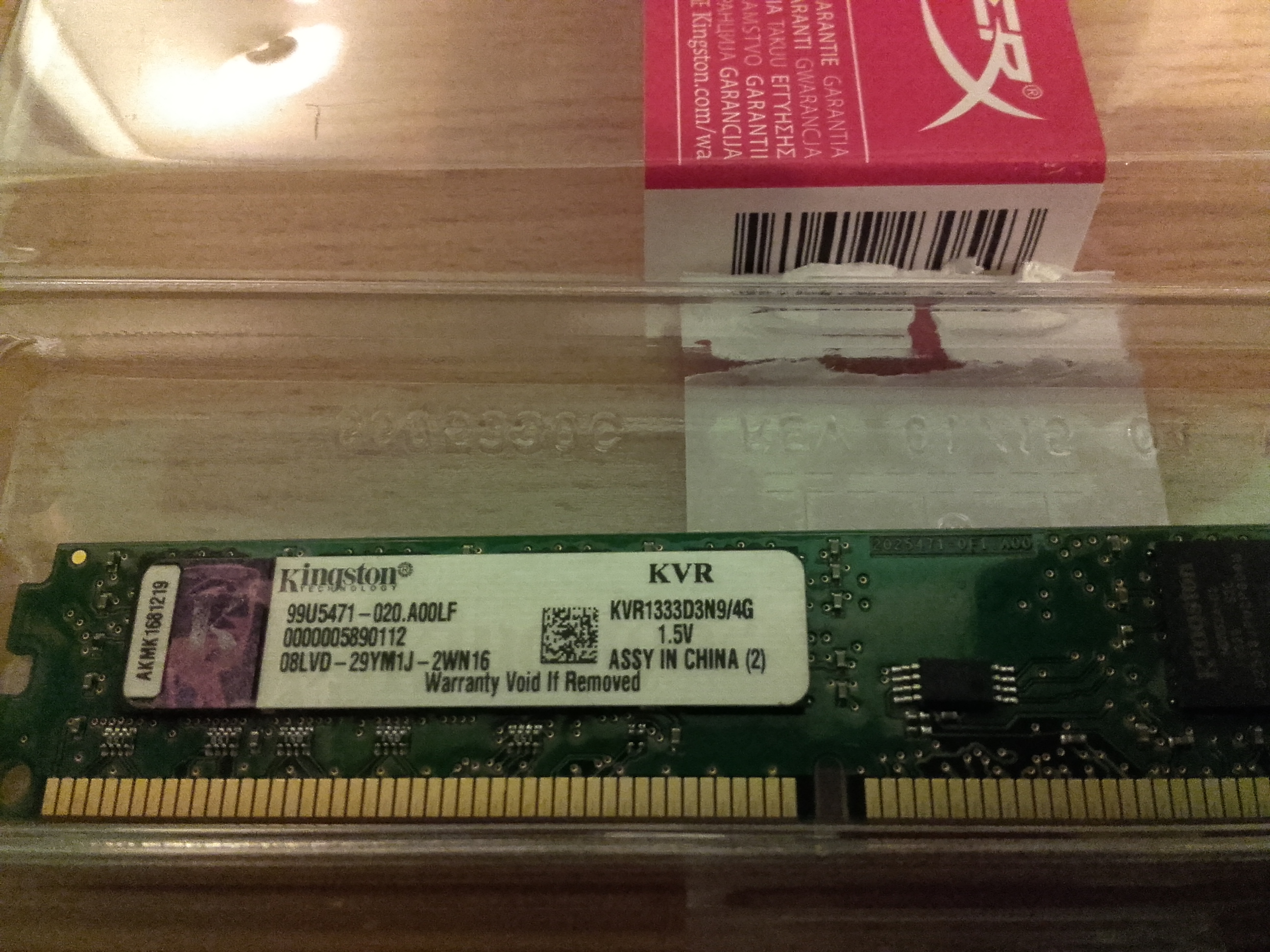

Onoff Posted March 9, 2018 Share Posted March 9, 2018 28 minutes ago, JSHarris said: Thanks, that's be really great - let me pay the going rate plus postage though, just to be fair. Any use? x2 4GB sticks: Don't get your hopes up it's just in a Hyper-X box Link to comment Share on other sites More sharing options...

Jeremy Harris Posted March 9, 2018 Author Share Posted March 9, 2018 10 minutes ago, Onoff said: Any use? x2 4GB sticks: Don't get your hopes up it's just in a Hyper-X box Thanks very much for digging these out, I think, from looking at the Kingston website than these should fit OK. Kingston say that the compatible memory is: Quote 4GB Module - DDR3 1333MHz Part Number: KCP313NS8/4 Specs: DDR3 , 1333MHz , Non-ECC , CL9 , X8 , 1.5V , Unbuffered , DIMM , 240-pin I "think" these are OK - I'm just checking to be sure - be back soon............. Link to comment Share on other sites More sharing options...
