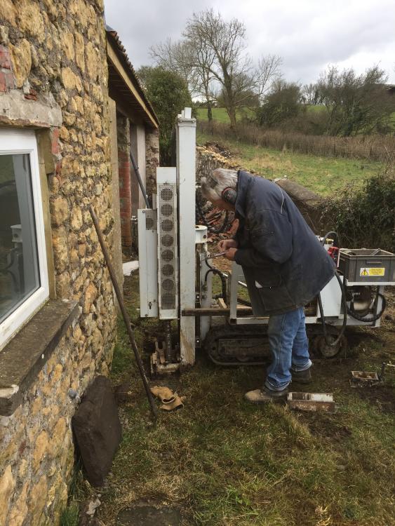

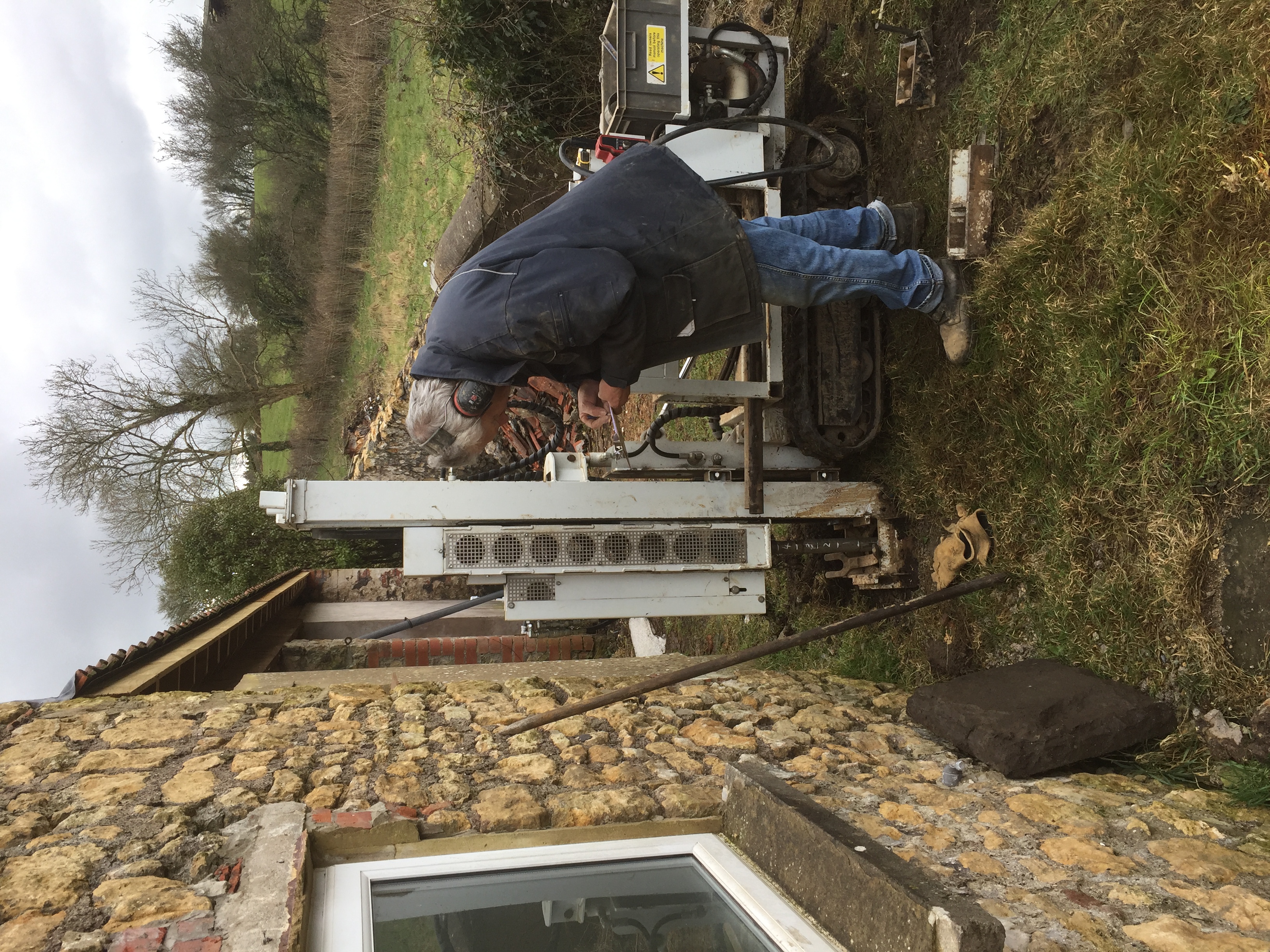

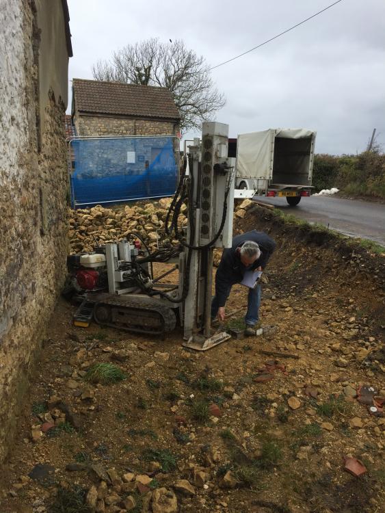

willbish Posted March 6, 2018 Posted March 6, 2018 Had my Ground Investigation done today Used the same chap as @vivienz after the positive recommendation on her blog. I had two quotes and MSS were significantly cheaper. Was quoted £1250 in VAT for two boreholes to 2.8m with SPT testing. Fortunately the results are looking very good and the ground is suitable for a raft foundation. There is a small amount of clay on site but that will be more than removed when we scrape back to the level required for the hardcore.
willbish Posted March 6, 2018 Posted March 6, 2018 41 minutes ago, lizzie said: I would wait no point in testing anything you are going to dig up and cart away. Im not sure I would second this advice. My SE asked for bearing capacity at 600mm below slab height. Unless you are digging down metres then a small rig, like which was used on my site today, will easily be able to tell you the information you are after. I'd want to know sooner rather later if I was going to have to change foundation design to accommodate unsuitable ground conditions.

willbish Posted March 6, 2018 Posted March 6, 2018 @Russell griffiths Yes he certainly does, although I would question why you would need to go to such depths, but I don't know what you are planning to build

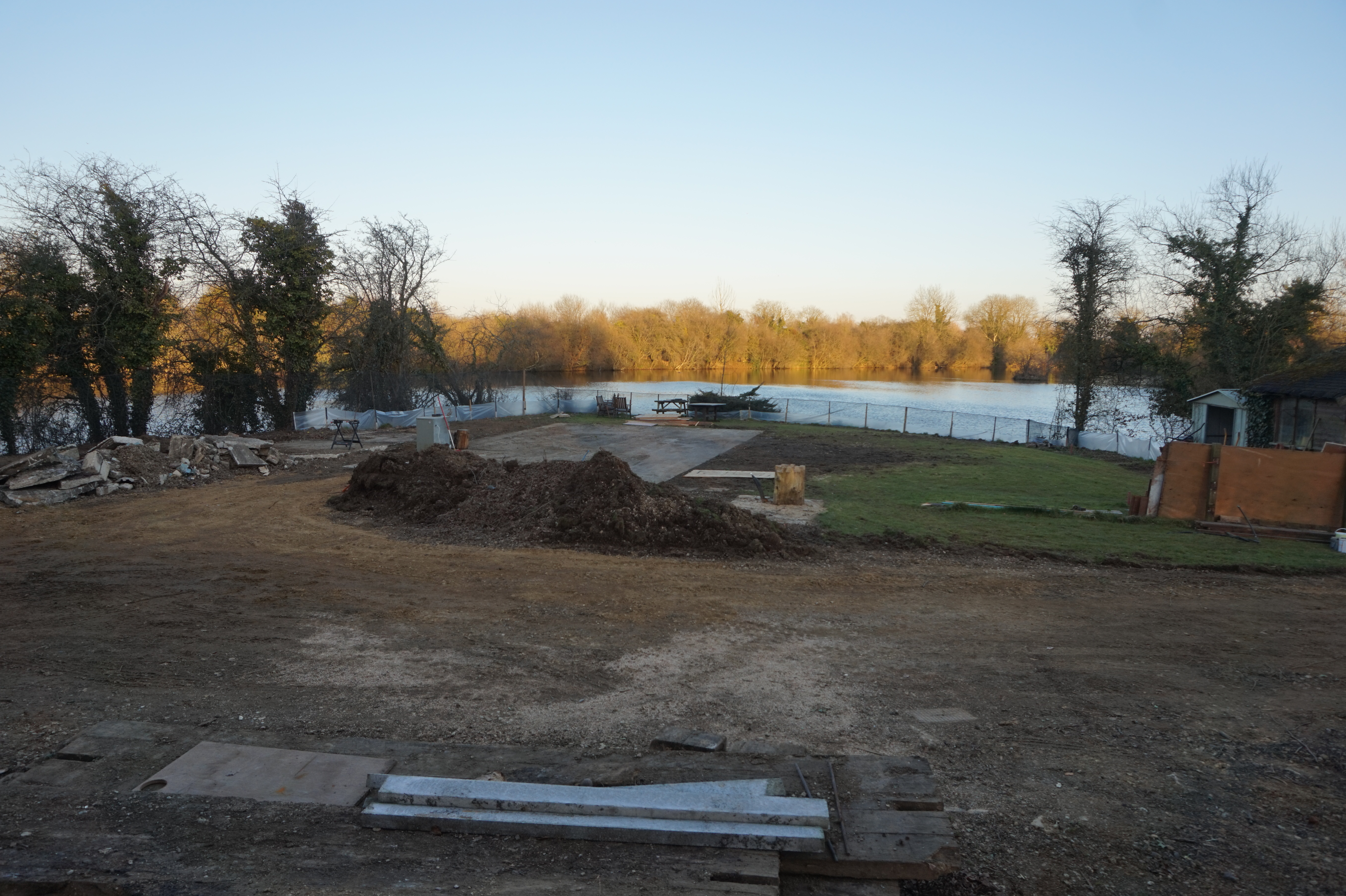

Russell griffiths Posted March 6, 2018 Author Posted March 6, 2018 (edited) No site stripping needed house is raised 450mm above existing ground level to account for flood risk. We think we are sitting on a couple of metres of fill as I’ve done a test hole with the digger and didn’t like what I found. This is our site the lake sits at about 700mm below the grass level, so digging down any more than that normally leaves you with wet feet, the house is to be raised 450above the grass level in the pic, so above the 1 in 100 year flood risk even though if that lake was to rise more than 300mm half of the south of England would have long disappeared. Who are we to argue. Edited March 6, 2018 by Russell griffiths 1
