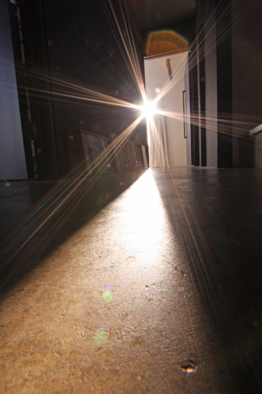

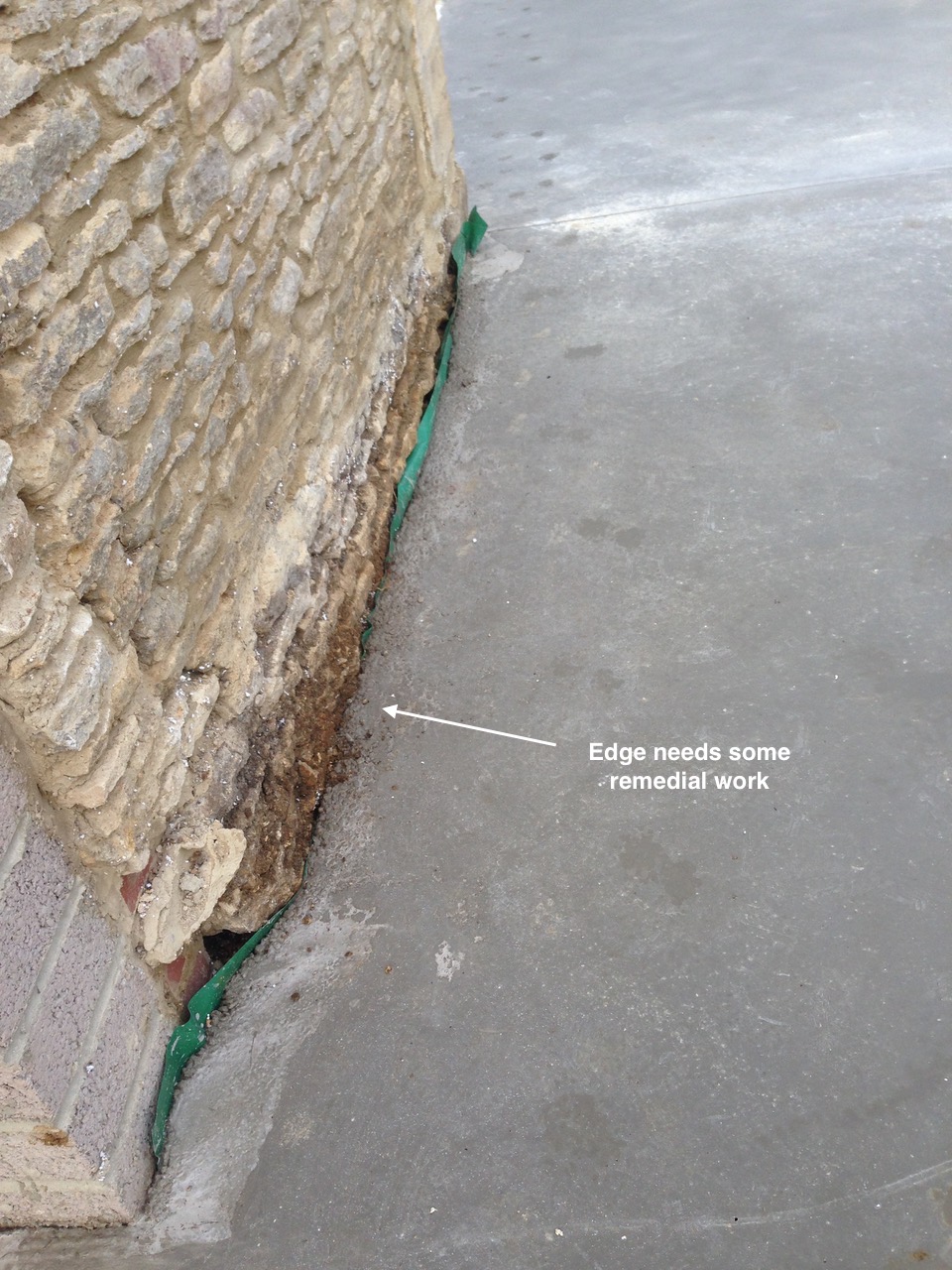

Visti Posted February 27, 2018 Share Posted February 27, 2018 Be aware that there is a distinct difference in a power-floated finish and a polished finish. A polished surface needs a specialist as @Alex C points out and will cost you significantly more but gives you the shiny smooth finish. A power-floated finish is far cheaper and can generally be done by most main contractors. It isn't perfectly smooth (it'll have divets) but it'll be a decent matt finish if spec'd right (i.e. a good composition is used and the main contractor is aware that it's to be the finished surface). Edges will need some remedial work, there may be hairline cracks if it dries too quickly and marks from the power-floating machine may be visible. We've gone for the power-floated both for cost and because we quite like the idea of a bit of texture / matt-ness. Ultimately it comes down to personal taste and budget. Below are some examples our architects showed us of a power-floated finish. The close up looks 'shocking' but is in reality not much to worry about. I know of some other members on here who have filled in any cracks and divets with contrasting resin which we potentially plan to do as well! 1 Link to comment Share on other sites More sharing options...

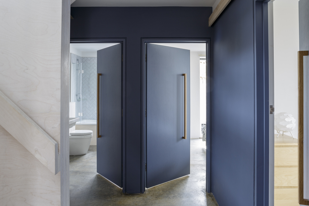

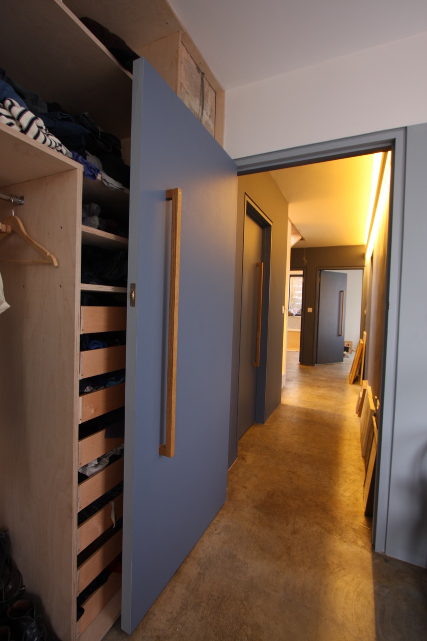

jack Posted February 28, 2018 Share Posted February 28, 2018 We have polished concrete over a structural slab. We had to go for 65mm rather than the 75mm minimum suggested, and have ended up with a couple of cracks. I haven't tried filling them yet, but they aren't the end of the world. A few things: As I said, the minimum is 75mm - thicker is recommended. That's a lot of concrete if you already have a structural slab underneath, but hey, concrete looks cool! The polishers can only get so close to walls. We did ours before plaster and skirting boards. Even so, there's a clear region along every wall that was polished by hand tools rather than the big grinders, and this does look different, and in a few places is slightly undulating. If you're happy with this (we are - we think it adds character), it isn't an issue. If you aren't happy with a different-looking edge, then the pouring and polishing needs to be done before the frame goes up. That allows the whole surface to be polished, so you get edge to edge consistency. You then have the not-insignificant problem of protecting the floor for the rest of the build, including while the frame goes up. Whether you get polished concrete before or after the frame goes up, you will be protecting it for a long time. We used Correx throughout the ground floor. Even though we taped it at every edge, we can still see dark lines in some areas where the joins were, two years after moving in. Also, dirt and dust finds its way in, and can cause scratches. Polished concrete companies get their concrete from local suppliers. In our case, we wanted to see a small amount of exposed aggregate visible after polishing. We really didn't want black/dark aggregate, but the company couldn't/wouldn't make any guarantees about aggregate colour. Was fine in the end, but a risk, albeit slight (I've never seen black aggregate anywhere near where I live. We have numerous sand and gravel pits nearby and they all have light stone). Concrete can be tinted to whatever colour you like. We wanted something a little darker than one of the standard tints and the company was happy to come up with something custom. Again, it was to our risk whether we were happy with the colour when it was down - if the concrete had been yellower, for example, that would have changed the colour in a slightly browner direction, but in the end we got a nice warm dark grey along the lines we were expecting. Concrete is easy to keep clean, but even with a sealer it can stain. My wife accidentally left a bin bag on the floor overnight once, and some sort of fluid leaked out. We now have a large, permanent dark stain in the kitchen that's a bit unpleasant. I personally wouldn't have concrete in a kitchen again under any circumstances. Would I go for concrete again? Not sure. I suspect that large-format tiles are a hardier long-term solution, but let's face it, they aren't polished concrete! If I had my time again, I think I'd perhaps tile the kitchen and have concrete everywhere else. One thing I really like is how it feels underfoot in summer. Winter... less so, especially when the ASHP is on the fritz so the slab is unheated! 2 1 Link to comment Share on other sites More sharing options...
