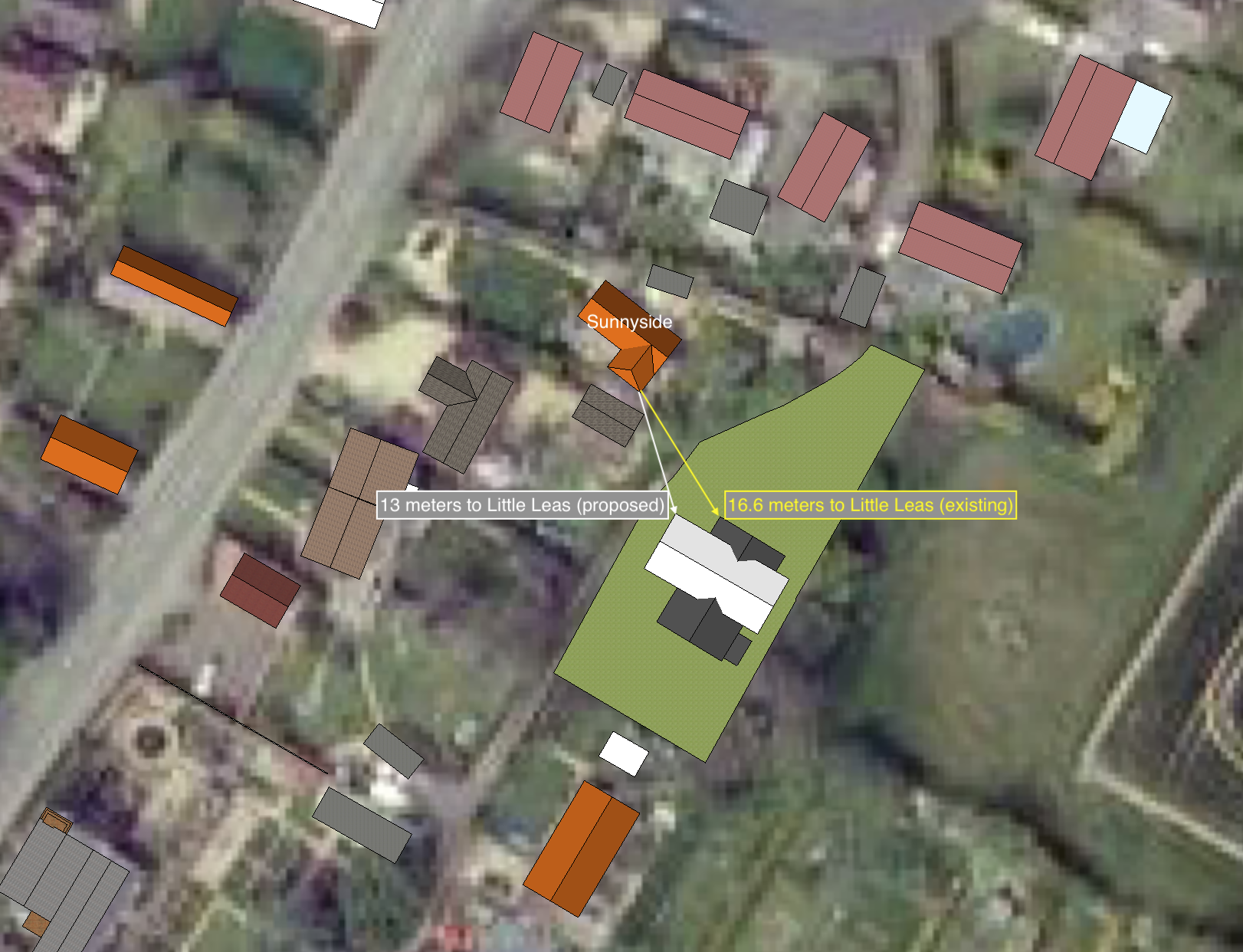

Russdl Posted February 27, 2018 Share Posted February 27, 2018 Hello all. We've applied for planning permission which involves demolishing a bungalow and replacing it with a contemporary looking house. The conservation officer raised some concerns which we addressed and he has come back saying he has: "no issue with the orientation, design, materials or otherwise per se, it is the impact on the setting of the Listed Building that needs to be addressed." What exactly does 'impact on the setting' mean? Is it defined anywhere (I can't find anything) or will it just be the conservation officers personal opinion? Thanks - Russ. Link to comment Share on other sites More sharing options...
dpmiller Posted February 27, 2018 Share Posted February 27, 2018 how close is it? Link to comment Share on other sites More sharing options...
Russdl Posted February 27, 2018 Author Share Posted February 27, 2018 13m. In the Google Earth/Sketchup image below the orange roof is the listed building. The black roof the existing bungalow and the white roof the proposed redevelopment (it won't be white roofed!). The proposed ridge height is 2.7m higher. Link to comment Share on other sites More sharing options...
Mr Punter Posted February 27, 2018 Share Posted February 27, 2018 Have a look at Martin Goodall's planning blog http://planninglawblog.blogspot.co.uk/2013/03/listed-buildings-and-their-setting.html If the building is grade I you may be in trouble. It may be that you need a statement explaining how the proposal does not impact so adversely as to merit a refusal. It could be that there are also some positive impacts. Link to comment Share on other sites More sharing options...

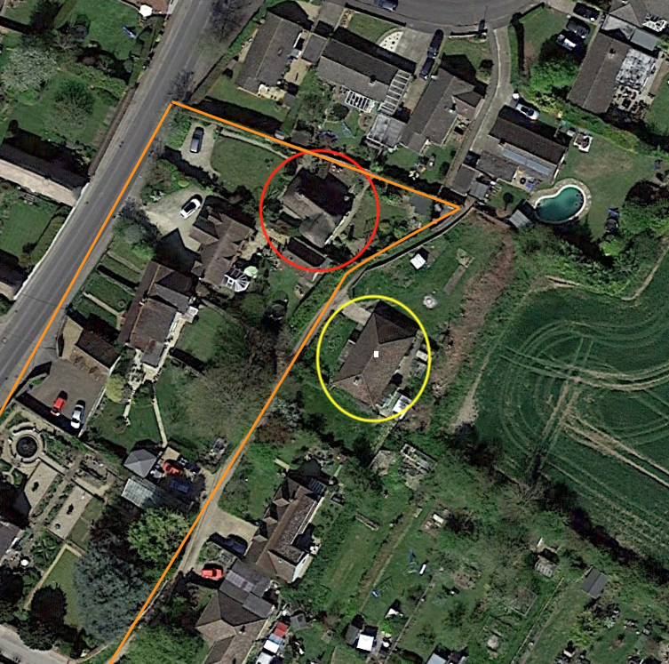

Russdl Posted February 27, 2018 Author Share Posted February 27, 2018 Wow, thanks for all the helpful replies. I only turned my back for a minute! To answer some of the posts and questions: The cottage in question is Grade II listed (circled in red) and at the north end of a group of buildings in a conservation area (orange boundary), our bungalow is circled in yellow in the clearer image below. I haven't spoken with the conservation officer yet, I was curious to know what "the impact on the setting of the listed building" actually meant, but I will be in touch with him later by email, not sure if he'll take phone calls - I'll ask. We've had a bit of help from a planning consultant already who advised that there shouldn't be any issues and suggested that I submit the application myself. I guess it's time to get back in touch... 3 hours ago, Cambs said: I will PM you with our conservation officer’s comments on our application That is much appreciated Ronnie, looks like quite a read. I'll get to it now - thanks. 3 hours ago, Russell griffiths said: is it as simple as having a landscape plan done and incorporating a screening hedge There are already numerous hedges and trees in situ and something I consequently hadn't considered - but it may help, thanks. 3 hours ago, lizzie said: If you don't know one in your area send me your postcode and I can ask him to do a look up for you for a local one I'll probably go back to the one we've used before to start with, but thanks for that offer Lizzie. 2 hours ago, Ferdinand said: Is your plot carved out of the grounds of the Listed Building No, our bungalow is from the '50s and separated from the listed building by a footpath and electricity substation and the listed building is privately owned. 2 hours ago, Ferdinand said: Suggest being careful to listen first, then go away and consult and reflect, then reply. Wise advice I'm sure, I'll endeavour to do that. 2 hours ago, JSHarris said: As luck would have it there was a change of Conservation Officer and the new one was a lot easier to deal with I hope we have the same one Jeremy, we're Wiltshire as well so I suspect there is a high likelihood. Thanks again all. Russ. 1 Link to comment Share on other sites More sharing options...
